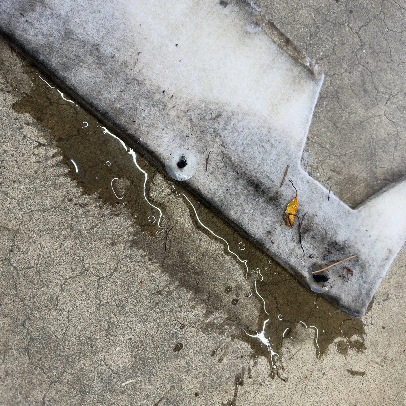

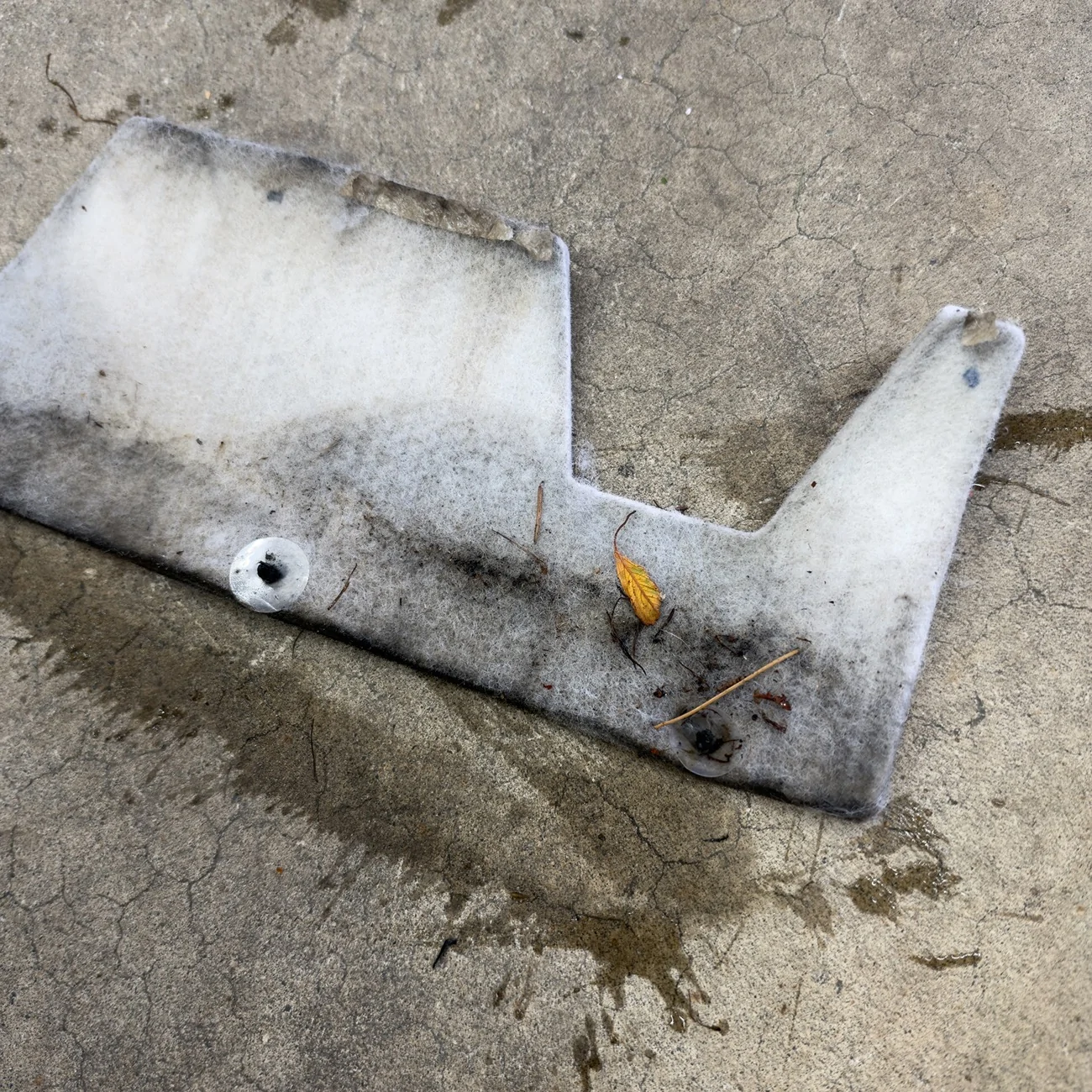

Went to install a bed cover today and noticed the insulation this thread talks about. After reading, I've come to a few conclusions:
  1. I understand Ford may have made the decision to put it there to dampen sound or to protect against debris going into the vents. It does seem slightly louder with it gone, but barely noticeable.
  2. The fact that some models have it and others don't seems more telling to me (from reading other posts). Plus the above post from The Lone Ranger says that they did some digging and Ford confirmed it wasn't supposed to be there.
  3. The material itself is fibrous and porous in nature — and has nothing blocking it from rain or the elements. I bought a 2025 Ranger in 2026, so this truck has been sitting on the lot for months at least, and it was absolutely soaked. The adhesion at the top was already coming off, and the small plastic rivets at the bottom were easy to knock off.
In my personal opinion, I would remove this. Even if there is a one-way valve on the back, having a porous material like that open to the elements from above is a recipe for disaster over time. It won't last, it risks growing mold, and it prevents you from cleaning the space between the bed and the cab. Whether Ford intended for it to be there or not, this thread alone is evidence that it was an oversight not worth a recall. You're better off with it removed.

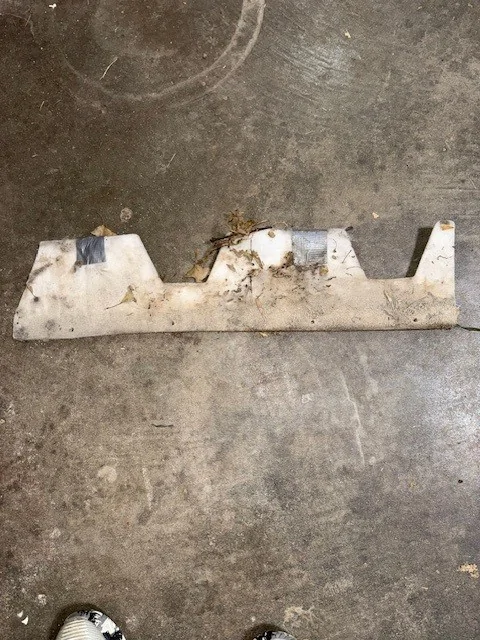

I removed mine. Only my opinion, but I believe it is meant only for shipping/assembly purposes which is further supported by some dealers removing it during DPI. If it was meant for NVH, then Ford would have used a material that does not absorb/hold water like a sponge. My Ranger is a 2026 that was brought home on 4/20/2026 and it was already collecting organic litter.
