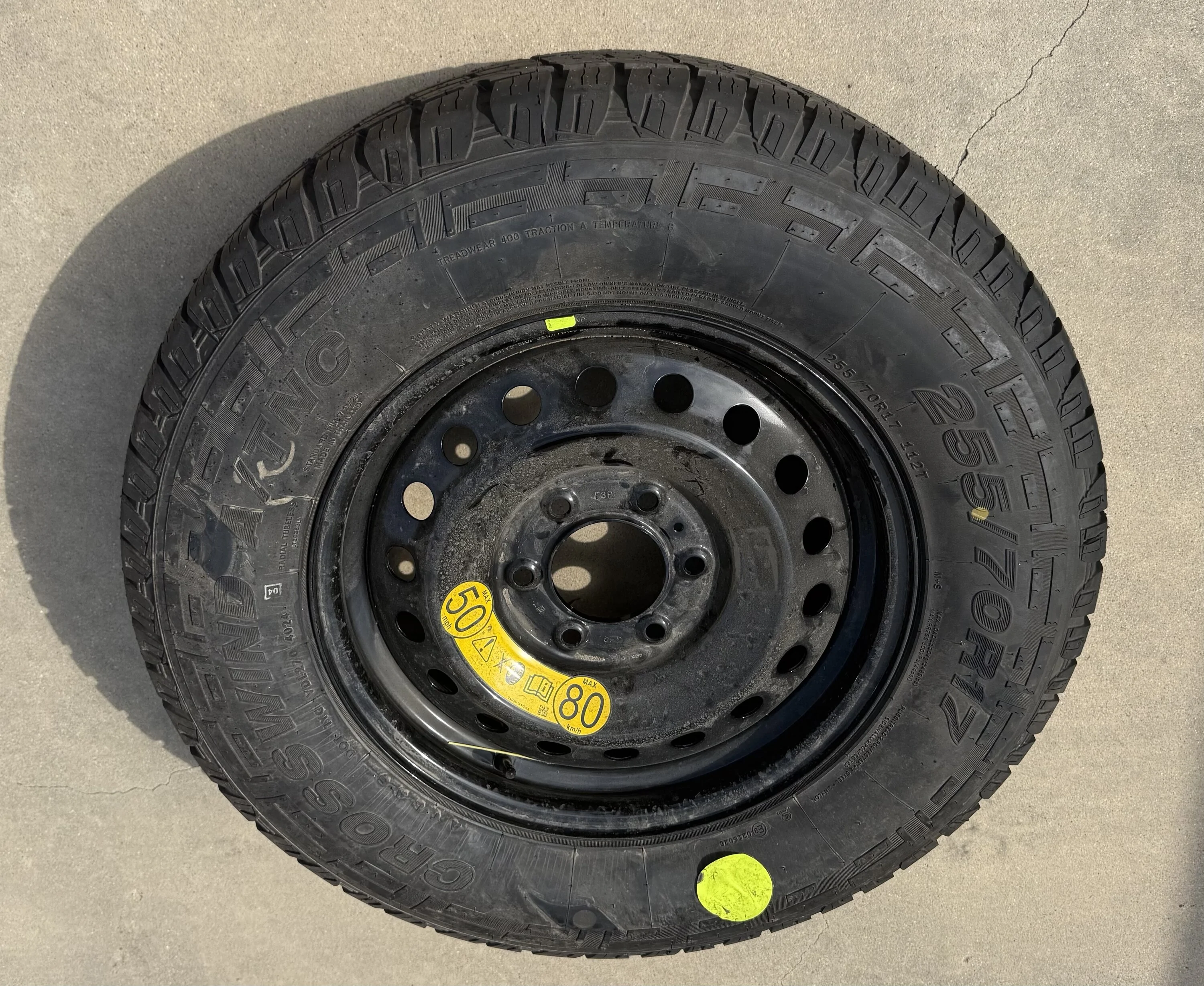

Why is the spare speed limited?
purdyd
Apr 28, 2025
925
1,259
california
2025 Ford Ranger Lariat
I mean it is a fully specced load and speed rated tire just a different size.
the rim?
Ford Ranger Why is the spare speed limited? FullSizeRender

Aircraft examiner
if the tire is rated for speed, i would go to that speed

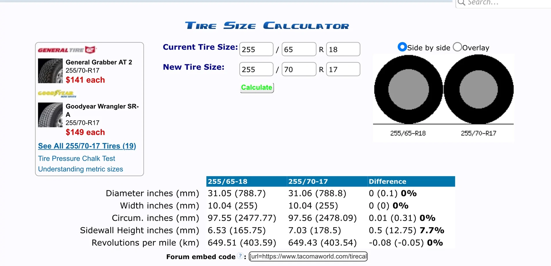

It is 112t or 118 mph versus the Tires on the vehicle 111t
so the spare even has a slightly higher load rating
Edit 0.01” difference in diameter, perhaps an issue
i feel like at some point i will get a matching 18“ rim

hmm that sticker is surprising. T rating is 118mph. I gotta believe the rim is strong enough to support the weight or normal truck abuse. 255/65/18 vs 255/70/17 is same overall size, or within 1/8" variance I've seen recommended for AWD. head scratcher.
.1“ difference in diameter, perhaps an issue
i make the occasional trip where aaa is not an option
Yeah I would say the difference in diameter would be the reason. Smaller wheel will be turning faster and at speeds it may cause issues with the diff?

1/100 of an inch difference in diameter.

I took my sticker off the first time I dropped the spare down. On the RR the spare tire is identical to the other four tires, mounted on a steelie.
Peel it off it it worries you.
