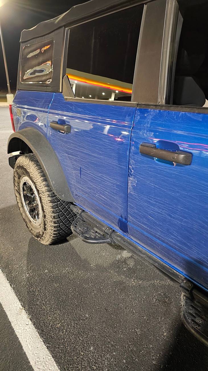

Hello yellow 86 ranger. I have a ranger just like yours. Its an 86 too. With a 4.0 swap manual 4x4. I got lots of trails time with it and my Bronco.
I got a Ranger Raptor now. Better believe it's getting the same treatment as the pictures below my friend.
You can share your offroad picture if you want, but not needed of course.
Don't forget to drink some coke ? while you're out wheeling.
