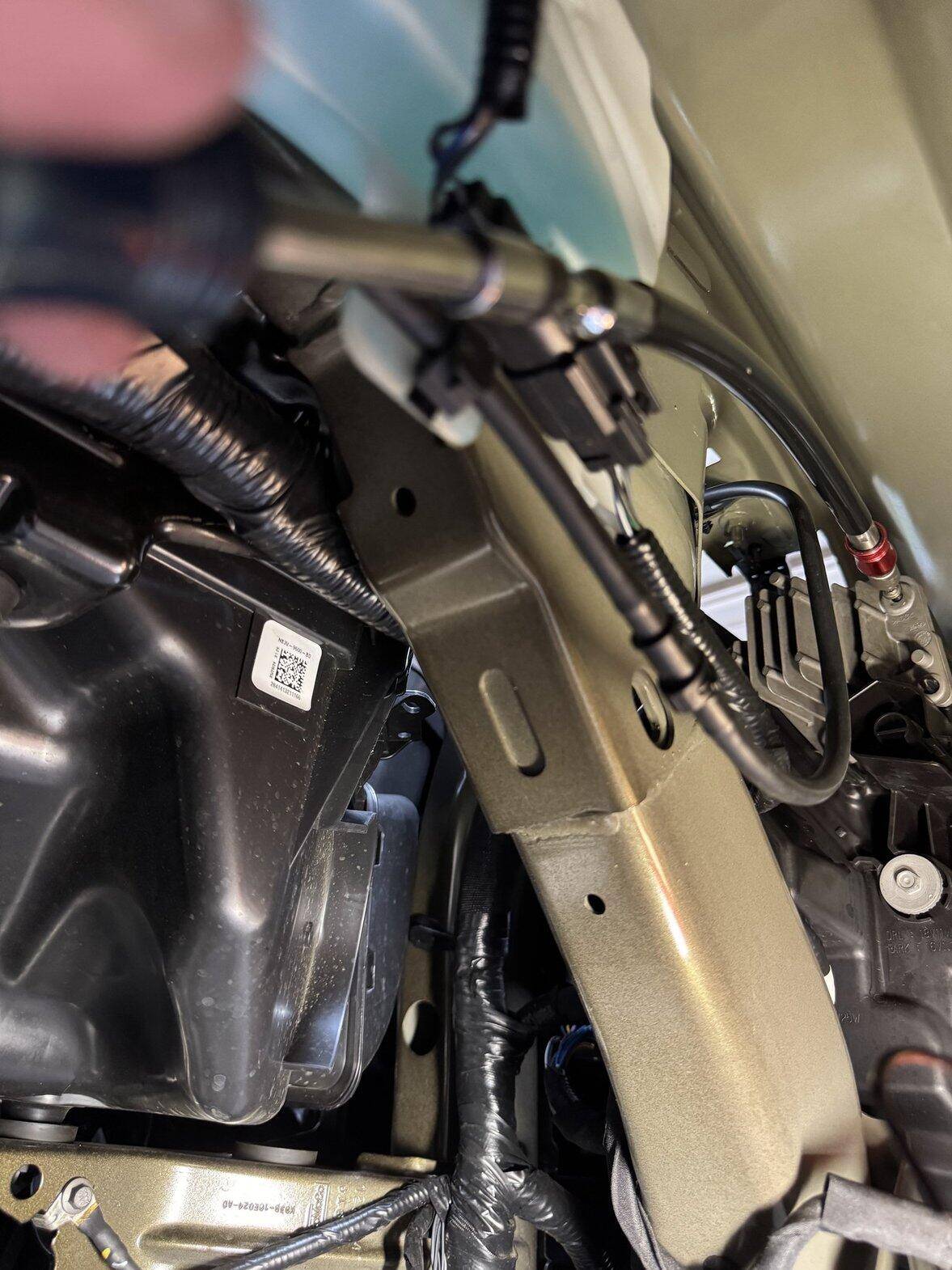

This is the passenger side view after removing the wheel and fender liners but before removing the horn. Someone mentioned the top bracket nut doesn't want to come off (you can see my ratchet wrench on this nut). Well, there's a good reason for that...

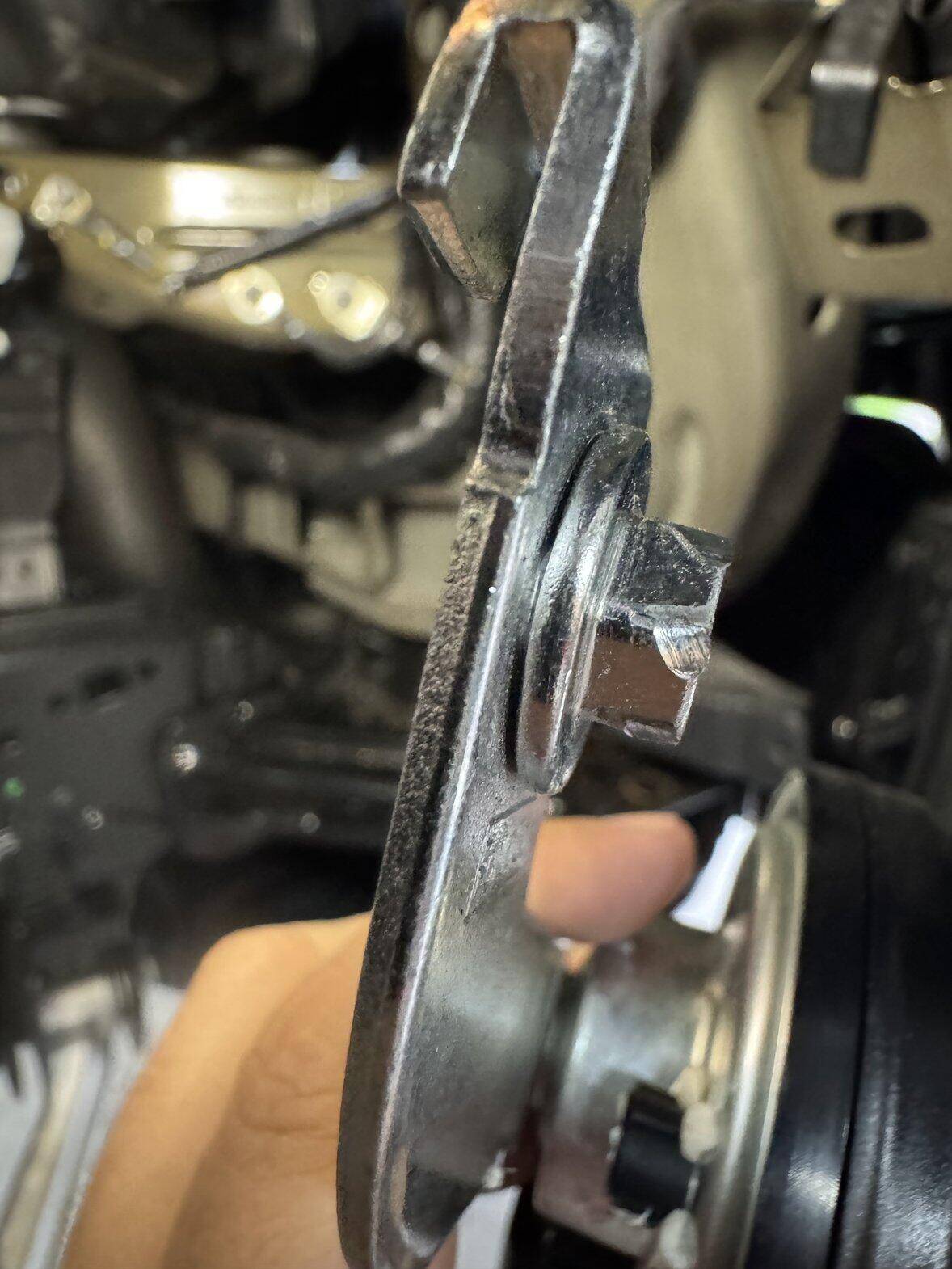

It's spot-welded to the bracket! You can see I already rounded off the nut before I realized what the problem was and actually checked the top side to see the bolt that was easy to access from under the hood. Remove that 8mm bolt from under the hood and the horn can be moved completely out of the way or disconnected and removed altogether.

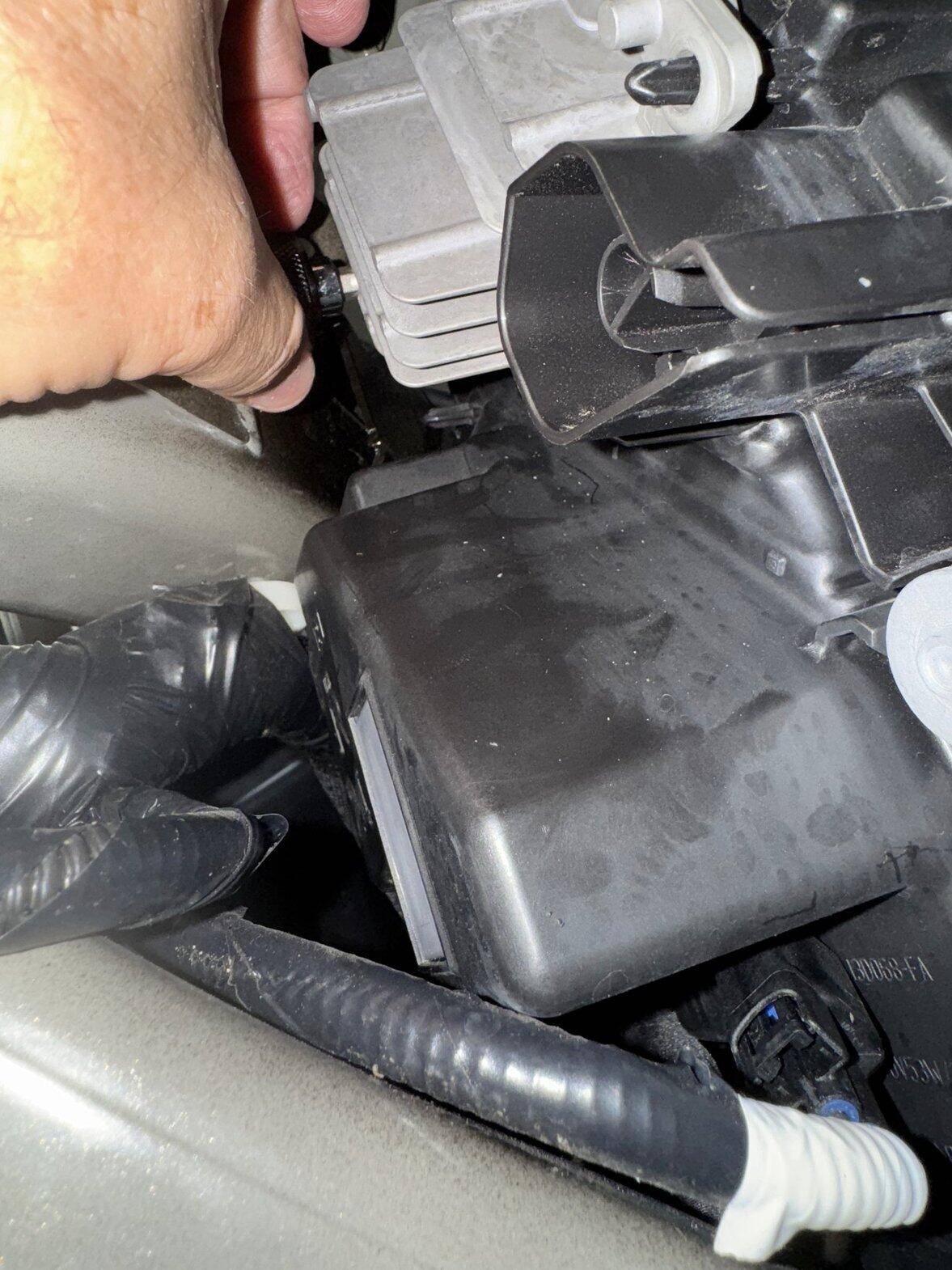

Once the horn is out of the way, you have plenty of room to work. I had already purchased the flexible shaft tool that everyone talks about (ten bucks on Amazon: https://www.amazon.com/dp/B0D6TQLFQG), and it does make it a little easier to access the outermost screws, but as you'll see on the driver's side photos later, it's not necessary.

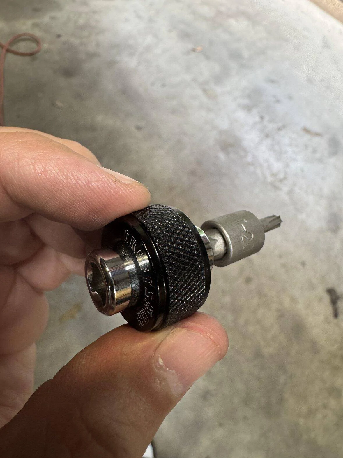

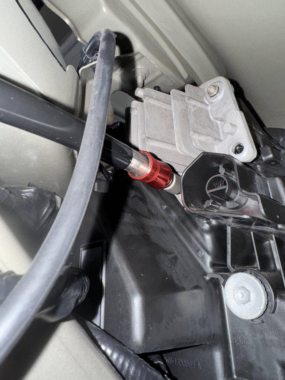

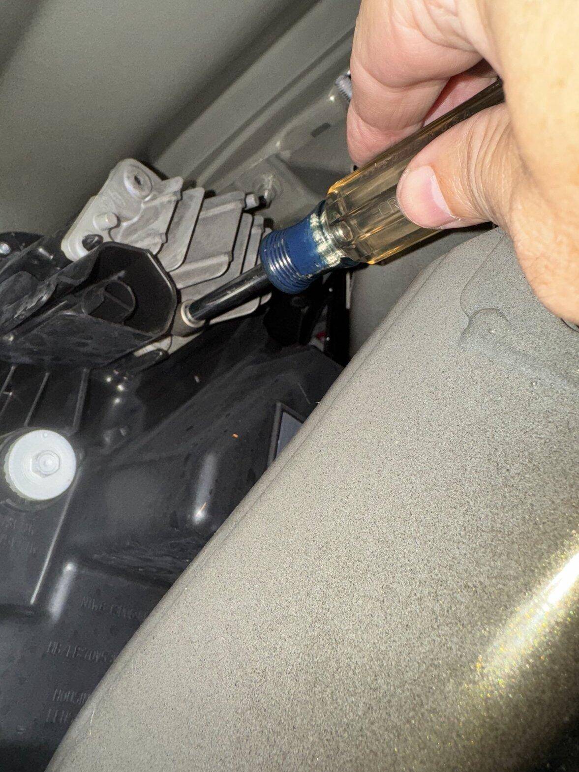

Here's the hardest part, and it's really not that hard if you have the little tool in the following picture. You cannot see the top innermost screw from below. It is located where my finger is in the above photo. You'll need to feel around with your finger and use the thumbscrew tool below to remove and later install this screw. I think I have read that this one is also the hardest one to access if you're installing from the top, so I don't have a frame of reference for the compared difficulty. Get the small tool, and you can easily remove and replace this screw once you feel around and figure out where it is.
Ford Ranger Signature LUX Amber DRL Install - DIY How-To Writeup w/ Instructions & Photos 1750082877448-4a
Six bucks at Amazon: https://www.amazon.com/dp/B09JBDVSBH
Ford Ranger Signature LUX Amber DRL Install - DIY How-To Writeup w/ Instructions & Photos 1750083137344-tt

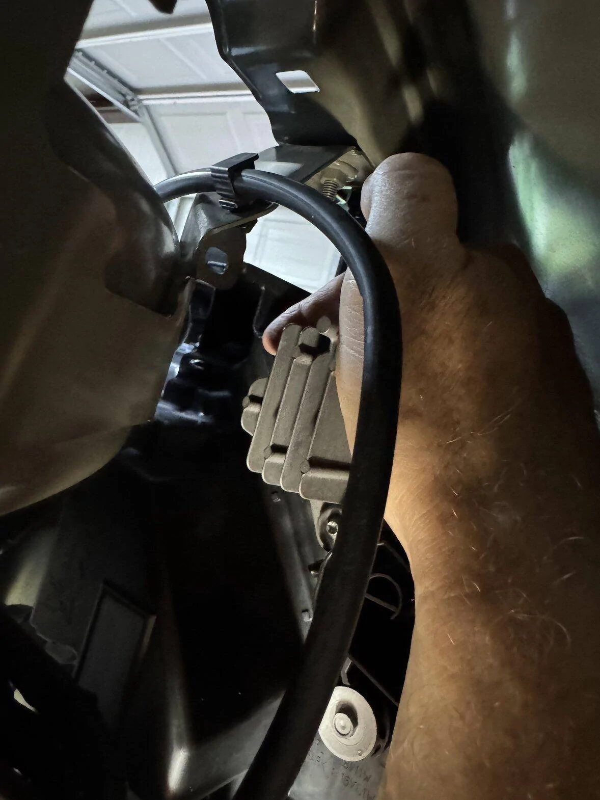

This is how it fits into the space you have to access that top screw. Not too bad at all, and the screws are only finger tight.

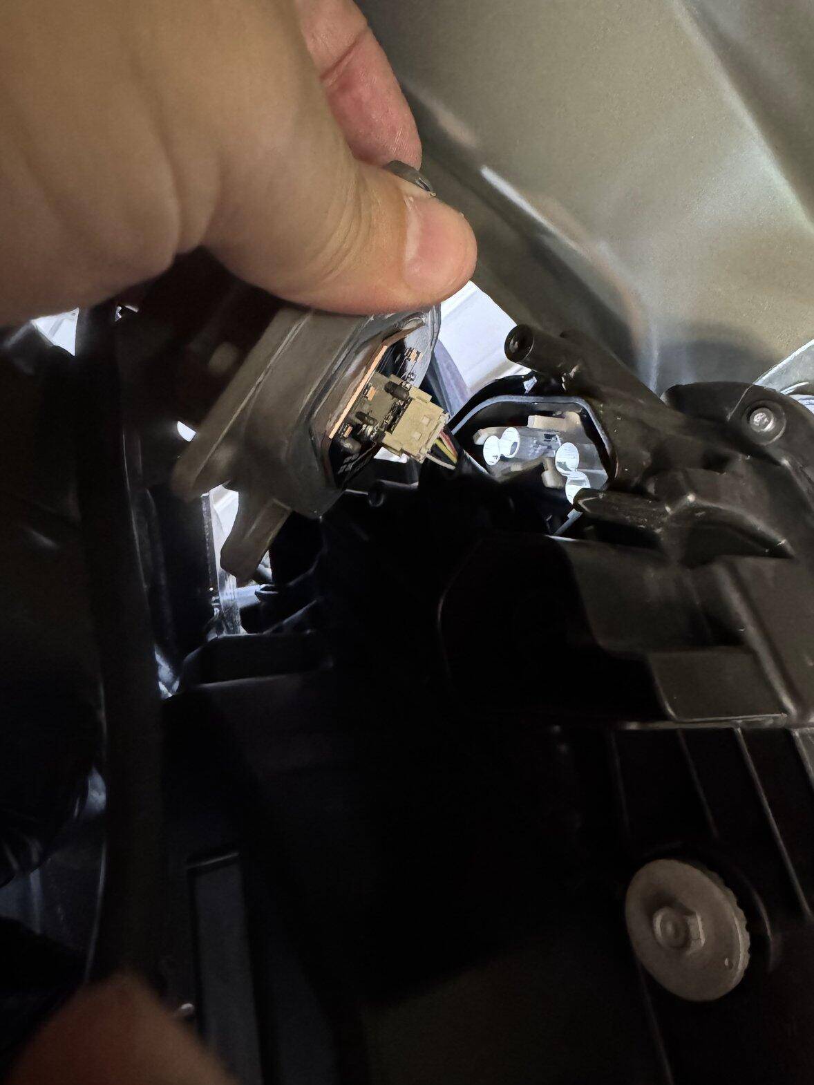

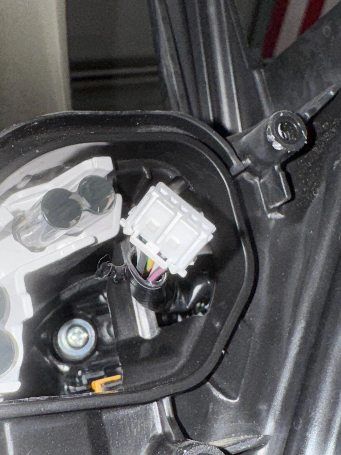

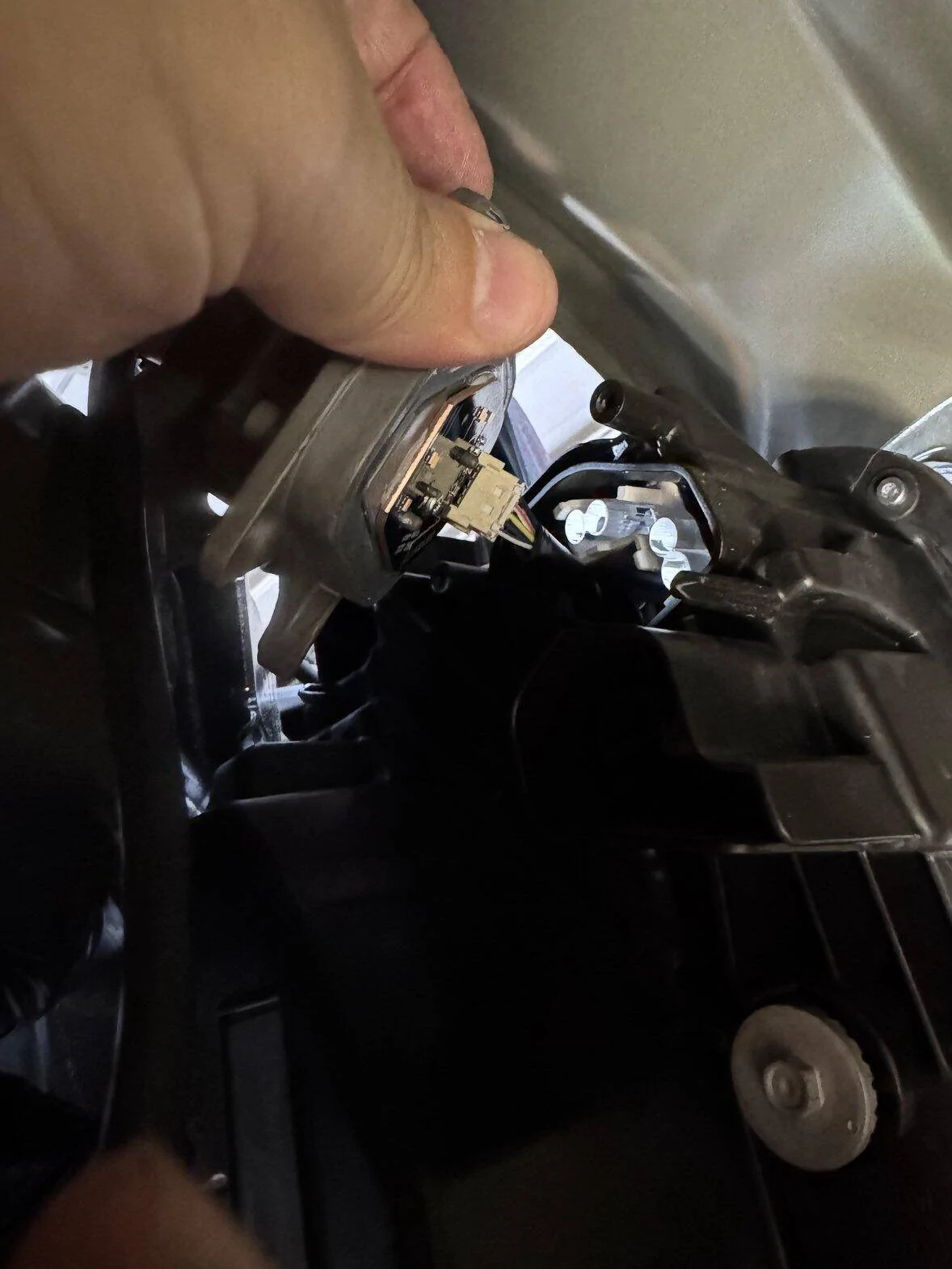

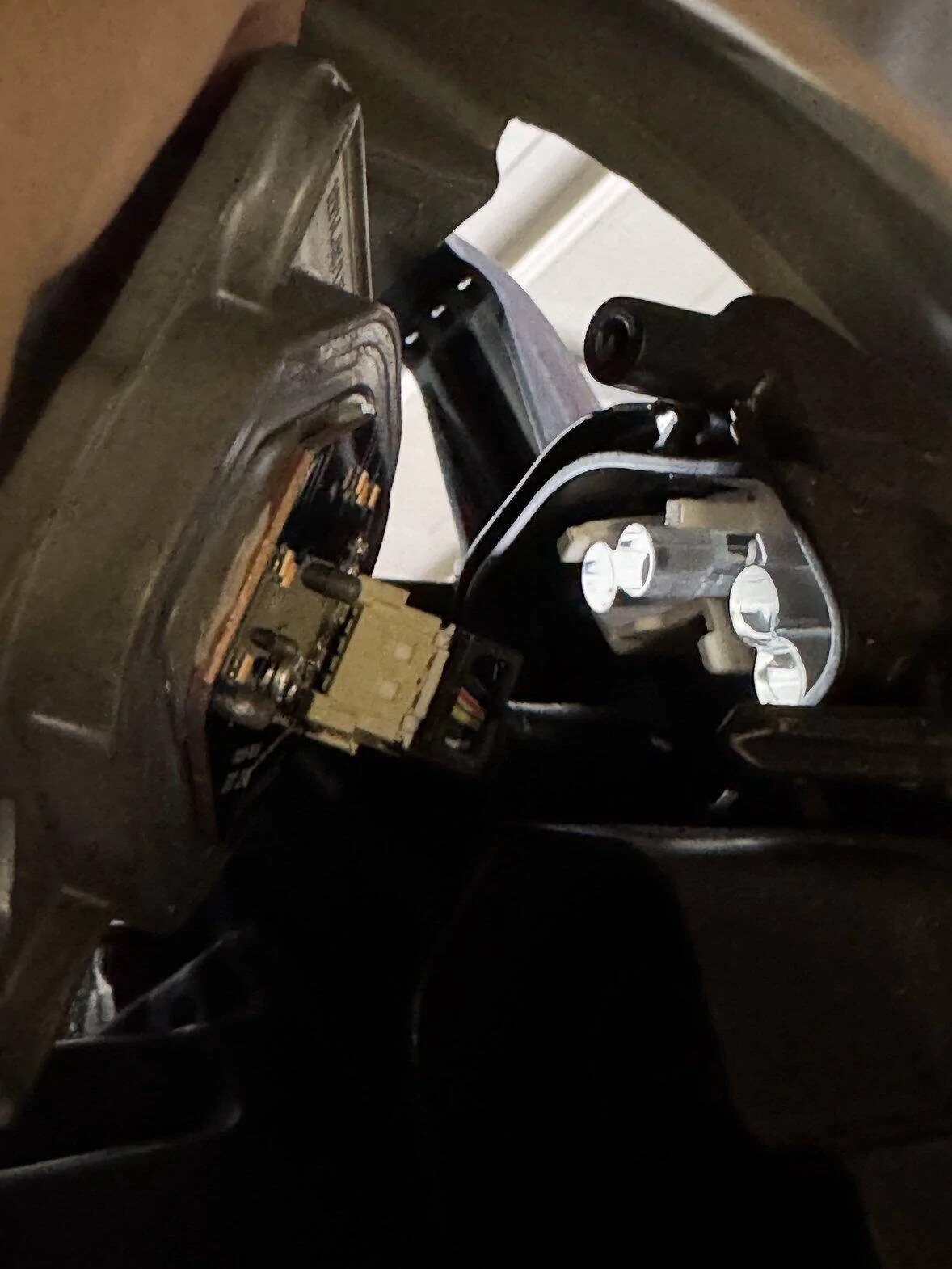

These two images show the connector that some have had issues with. The first image is dark, but the black bracket is still connected. I needed both hands, so I couldn't take photos of how it comes off, but it will slide straight out of the back with a little bit of wiggling. It's not very tight. Once it is off, use your thumbnail and push it into the gap shown in the second photo above to depress the small tabs you can also see facing the camera. Wiggle it a bit, and the connector comes apart easily.

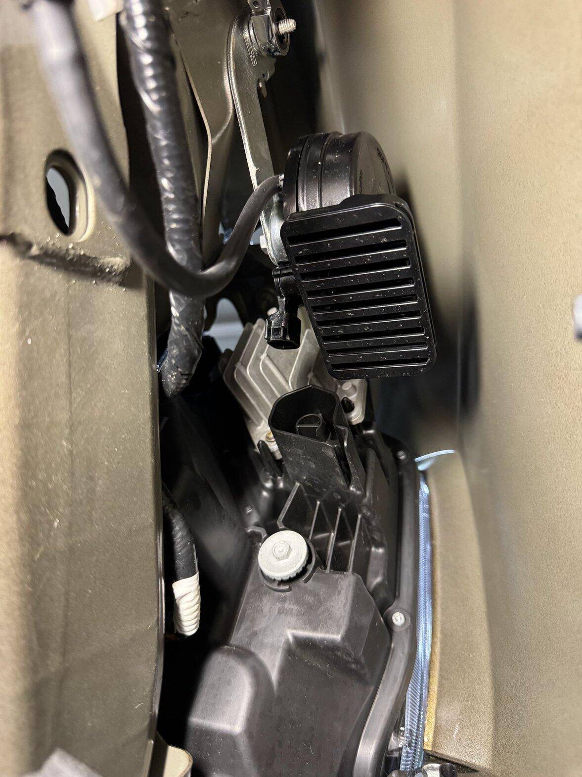

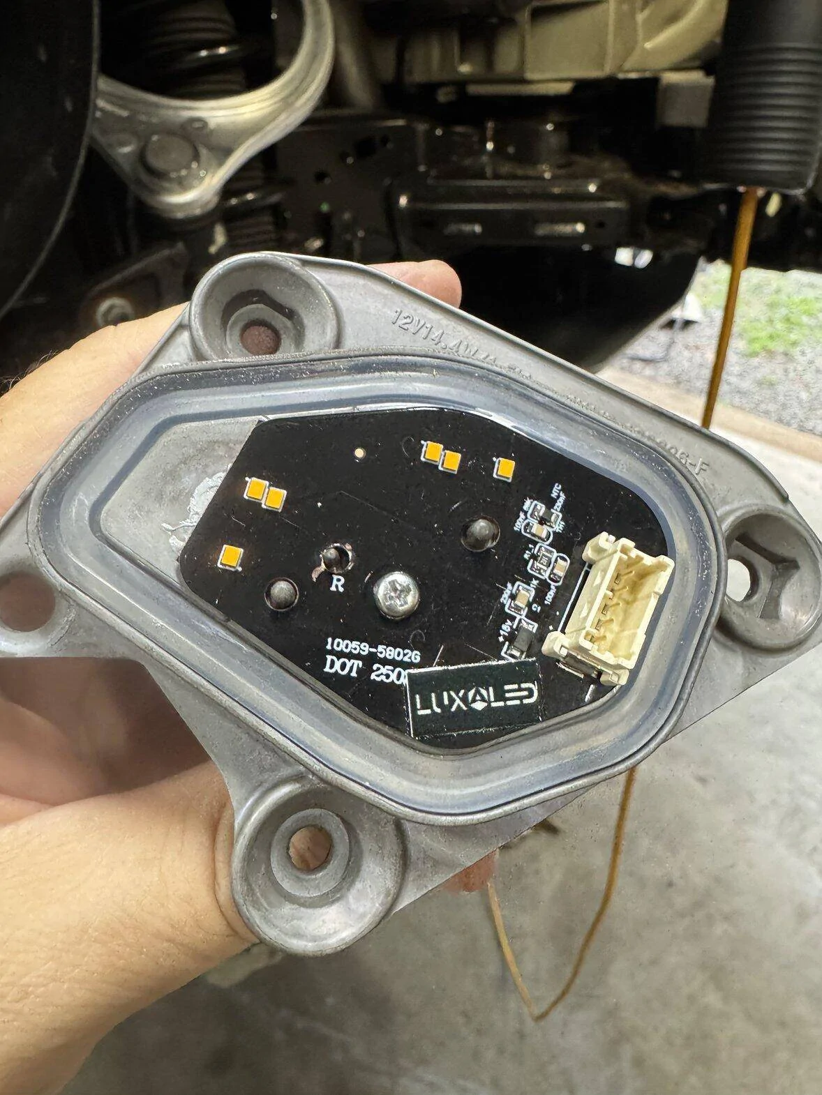

These two photos show the amount of heatsink compound I used and the installed amber LED module. The factory modules were aluminum, but the Signature Lux modules were copper. I did not have to break any tabs on the module to install.
Ford Ranger Signature LUX Amber DRL Install - DIY How-To Writeup w/ Instructions & Photos 1750083966101-z

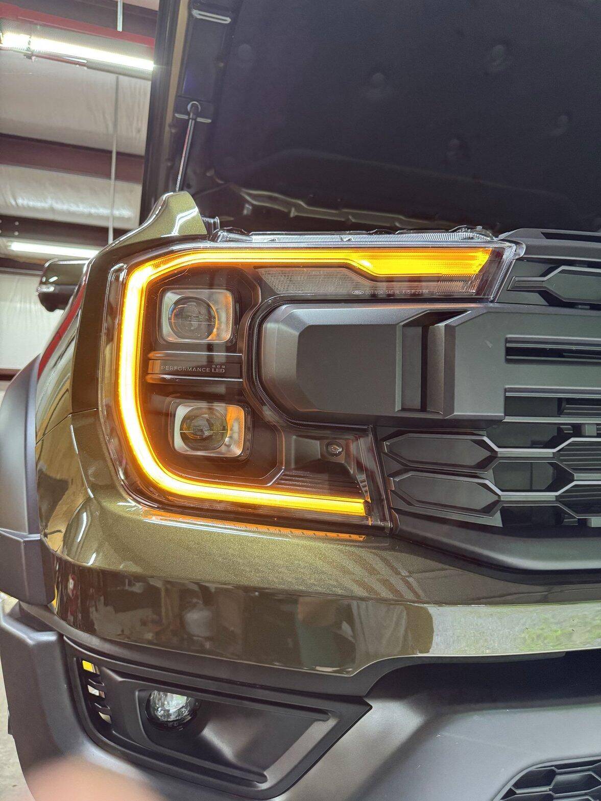

Final result on the passenger's side.

Another picture of the electric connector on the driver's side showing the tabs that need to be depressed in order for them to release the connection.

Is the black bracket you referenced on the wiring connector just some sort of strain relief? You mentioned it just pulls back to release it. I'm guessing it will be more clear when I see it, but does it swing off because it isn't a complete piece (U-shaped instead of enclosed rectangular piece)? In the pics with just the white connector I don't see it slid up the wiring loom or anywhere else.

I think it is just a strain relief, or perhaps a pin locking mechanism of some sort. When you pull it straight up and out, you'll see it has some "fingers" that slide down into the connector which may serve to lock the two connectors together in some way. It's only latched by two small side pieces that will let go if you wiggle and pull straight out. The reason people have such a hard time with it is because it's hard to get two hands in there to hold the module while fiddling with the bracket and connectors.
I got lucky and didn't break it on either side. It all went back together smoothly for me.

The black thingy is just a little locking clip. It's very fragile, it seems like quite a few people broke them trying to remove them. It's not really needed anyway. The white connector has locking tabs on it.

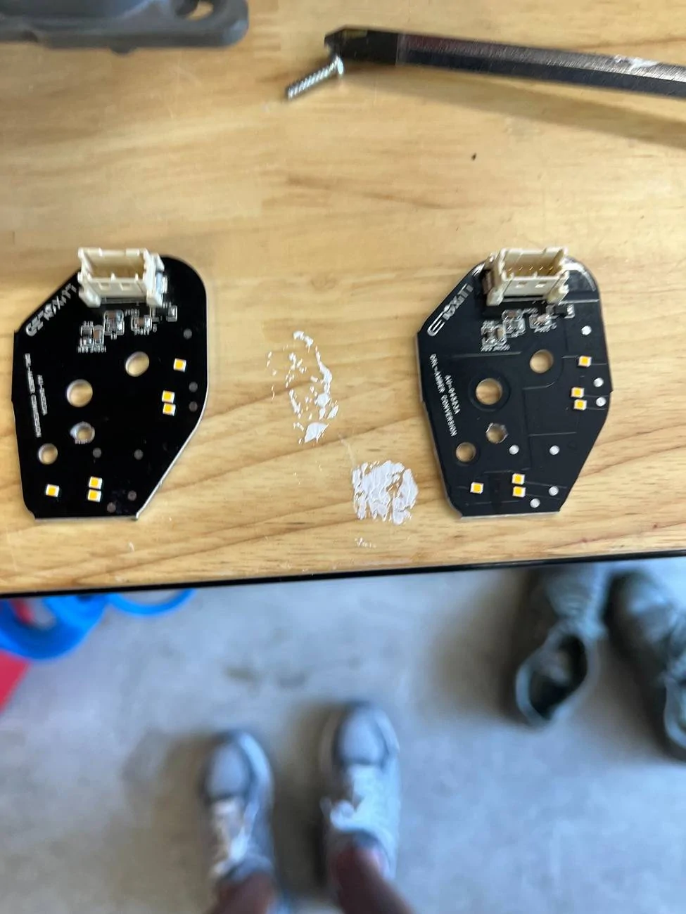

Thank you so much for this write up! Super helpful. Removing the fender liners and the horn freed up a ton of space.
To be honest, it took me a longer time trying to get those damn scrivets out of the fender liner than it did to remove the actual module....
Unfortunately, when I went to swap out the boards, I realized that SignatureLux sent me two Driver side boards instead of a Driver and Passenger. I was PISSED! Reinstalled the OEM board and now I gotta wait for them to send me a replacement.
