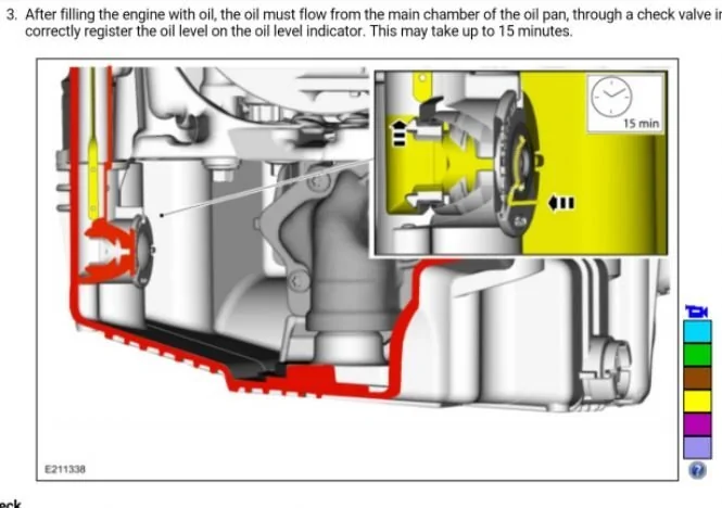

I'm surprised that an extractor works on the 2.7 Ranger. My previous vehicle, also had the 2.7 and the extractor tube would not reach down to the bottom of the pan due to the oil pan design.
Ford Ranger 2.7L Oil Extractor Oil Change DIY (Video) 2.7 Oil pan
I'll stick to the old fashioned way. It gives me the opportunity to do an inspection of all things you can't see from the top.
ADVNTURR
ADVNTURR
Sep 6, 2024
206
435
Cleveland, OH
That's very interesting, is that diagram of the 2.7 in the Ranger or from another application?
Admittedly it took me a couple of tries the first time to get the pickup tube in a good sport but it worked a bit better this time around. However, I put 6qt in last time and pulled 6qt out this time so by my math I got most of it out.

I'm really intrigued by this post, because it was my understanding that engines with auto start/stop are designed to keep the oil from draining down to the sump too quickly making it difficult if not impossible to drain all oil through the dipstick, but this isn't the first time I've seen someone say that they've used a vacuum extractor successfully.
Now, with that said, the logic of the quoted statement itself doesn't hold up. Please know that I'm not saying that it's true or not, but putting 6 quarts in then later taking 6 quarts out doesn't mean that all of the oil was evacuated. It doesn't mean it wasn't either. For example, if you drain 6 quarts and leave 1 in the sump, you'll have a total of 7 quarts. Later when you drain 6 you'll still have one left, but you put 6 in and took 6 out. Also, it's rather unlikely that the dipstick will register there only being a quart or two left in the sump because it wasn't designed to reach the bottom of the sump. The only way to really tell what's left in the sump, if anything at all, after using a vacuum extractor is to remove the drain plug and either just gravity-drain or stick the extractor hose into the drain hole and try to suck more out from the pan.

I guess there's always some possibility I have somehow damaged my drain pan inserting the extraction tube, but having done this on my German cars for almost 20 years, I didn't have any unexpected resistance or anything either time I've changed the oil using the extractor. I've seen the diagram someone posted, and if that truly is the design on the 2.7 in the Ranger than I don't have a good answer for why it's working fine.
The Ford claimed capacity is 6qt for an oil change with filter. This isn't all of the oil in the motor since there's at least 1 oil cooler somewhere in the system that typically doesn't drain when doing an oil change, gravity or extraction. I'm not going to claim I have gotten as much out as a traditional drain would because I haven't pulled the drain plug, but I am getting out as much as Ford says I should.
