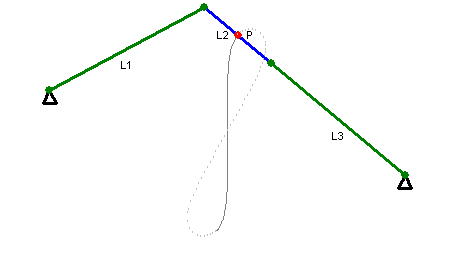

Watts link is better than a panhard/ track bar.
A panhard bar causes the axle to swing in an arch. It is never truly centered except at ride height (Assuming that is where it is neutral and centered).
The watts link is more expensive and keeps the axle centered throughout its range of motion.

Almost. The red dot would be the bolt and pivot point on the back of the axle diff. So, at the ends of travel there could be some some lateral axle movement.
The RR most likely doesn't have enough suspension travel to get to that point.

A good question would be how much suspension travel is needed for a Watts link arm to rotate over center similar to a front sway bar on a Wrangler?
I don't think there is enough travel to curve.
It's about 11" total IIRC.
