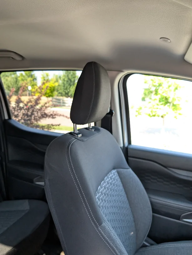

Purchased a set of used Maverick headrests ('22-'26 should work) to replace the stock Ranger's, since the stock headrests tilt too far forward for my wife's tastes. Works great!
Stock:
Ford Ranger Maverick Headrests to Solve The Ranger's "Tilt Too Far Forward" Problem 1785969468592-

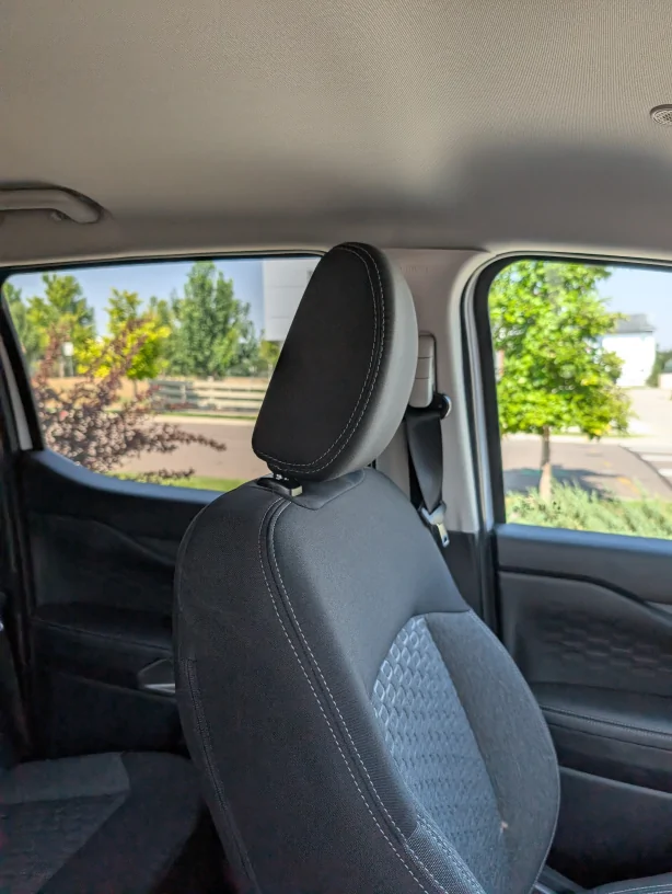

Maverick headrest in my Ranger:
Ford Ranger Maverick Headrests to Solve The Ranger's "Tilt Too Far Forward" Problem 1785969493585-og
Literal drop-in replacement, $65/ea off eBay.

The Maverick headrests are also fixed, and I am not sure of the part number; the description of the eBay auction was "22-25 Ford Maverick XL Front Seat Headrest Left or Right Side Black Cloth OEM." A friend has a '22 Maverick from which I had tested the fit in the Ranger before ordering.
