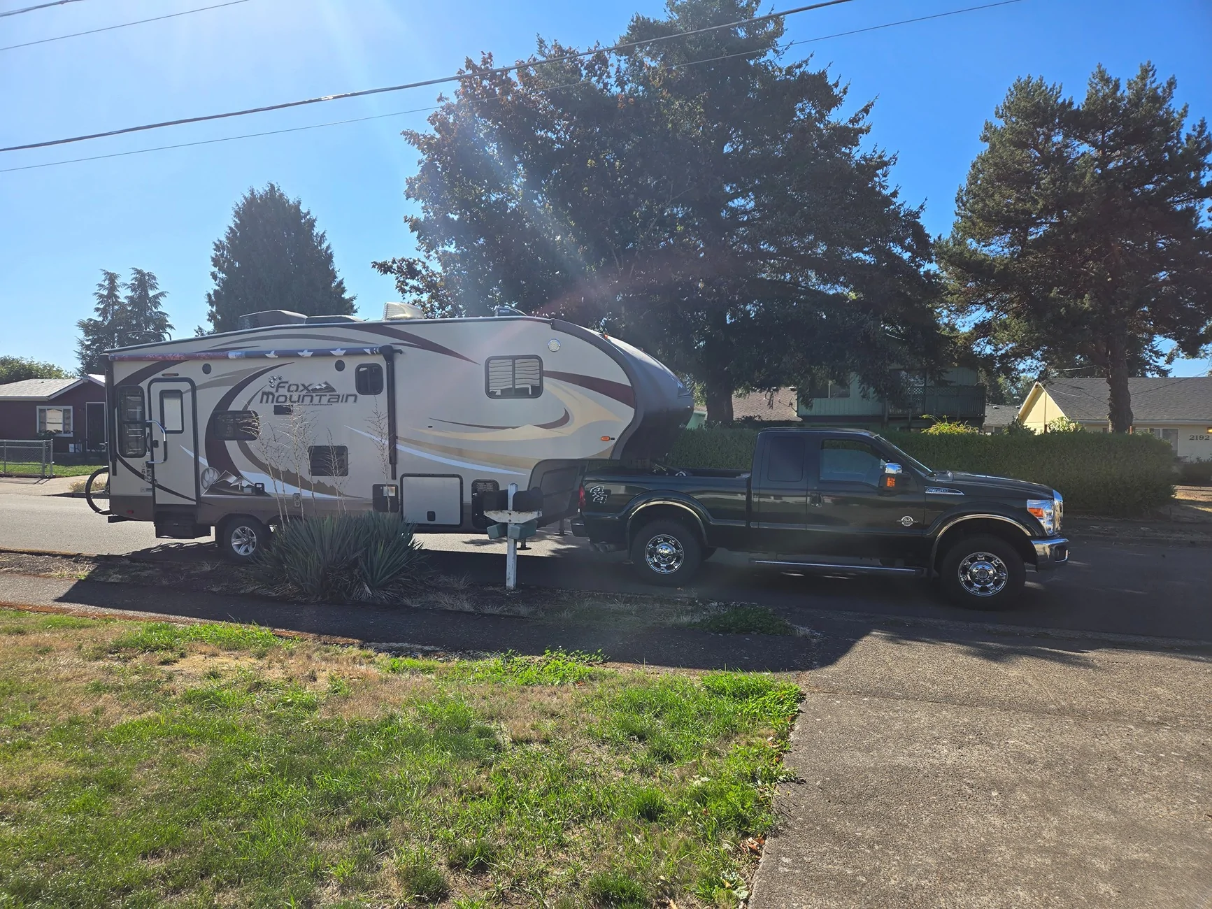

I have 360 ah of 6v lead acid batteries, 320 w of solar, a 2000 w inverter. They fit nicely in our camping trailer....
And a 4000 w dual fuel generator.

That doesn't count if you can't bring it along with the Ranger, and that doesn't look like a Ranger! :D
I have a similar setup in my MH which is how I ended up with a spare battery when I upgraded the MH to 330ah.

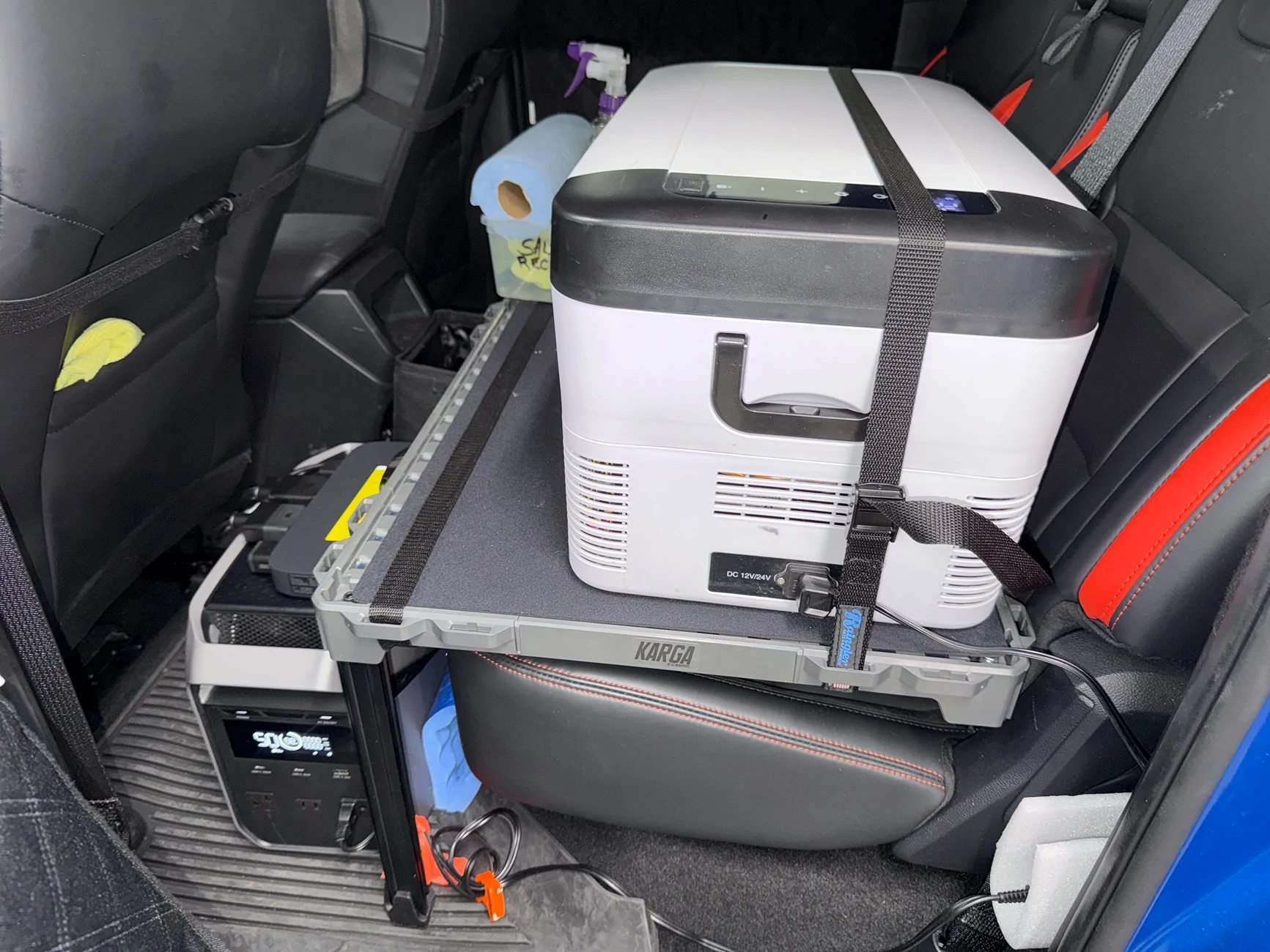

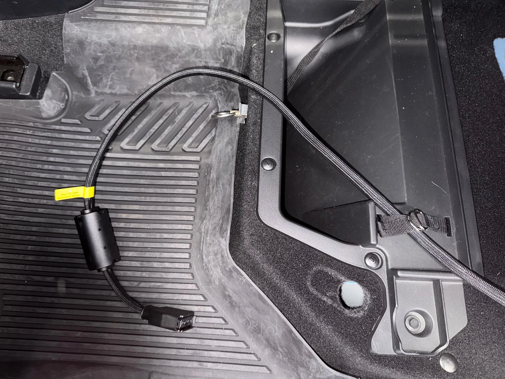

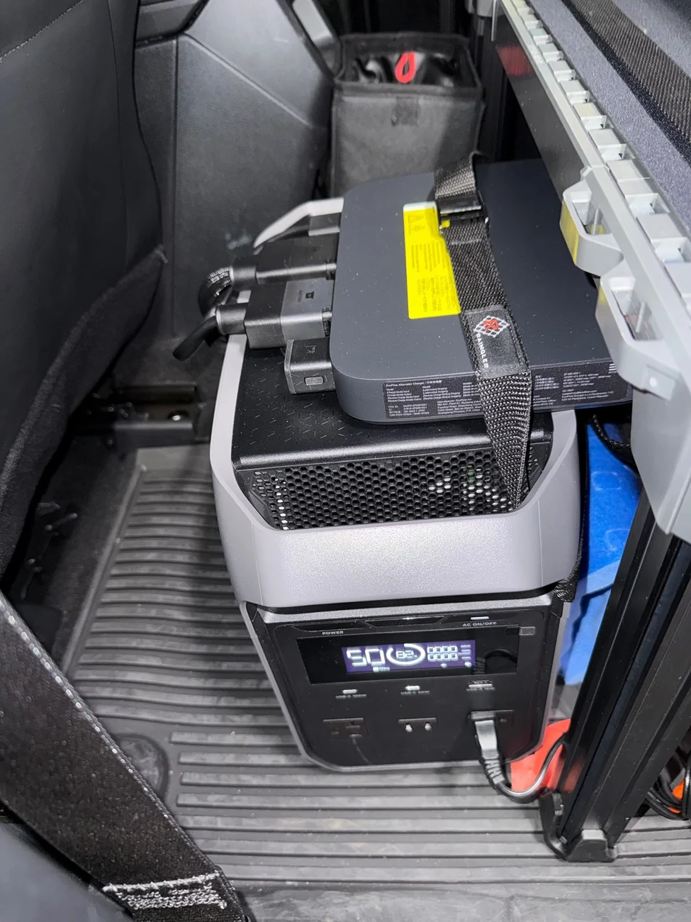

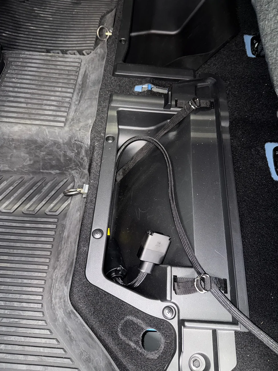

That is very slick! How does it cool, and have you thought about adding a computer fan and vents? The controller and battery temps must both be maintained for long term health.
I use an Ecoflow 1028 Whr and a separate Ecoflow 500 watt Alternator Charger, plus a backup 200 watt EF folding 4 panel solar panel. I rarely need that, the truck engine will fully charge the power bank in about two hours driving time...

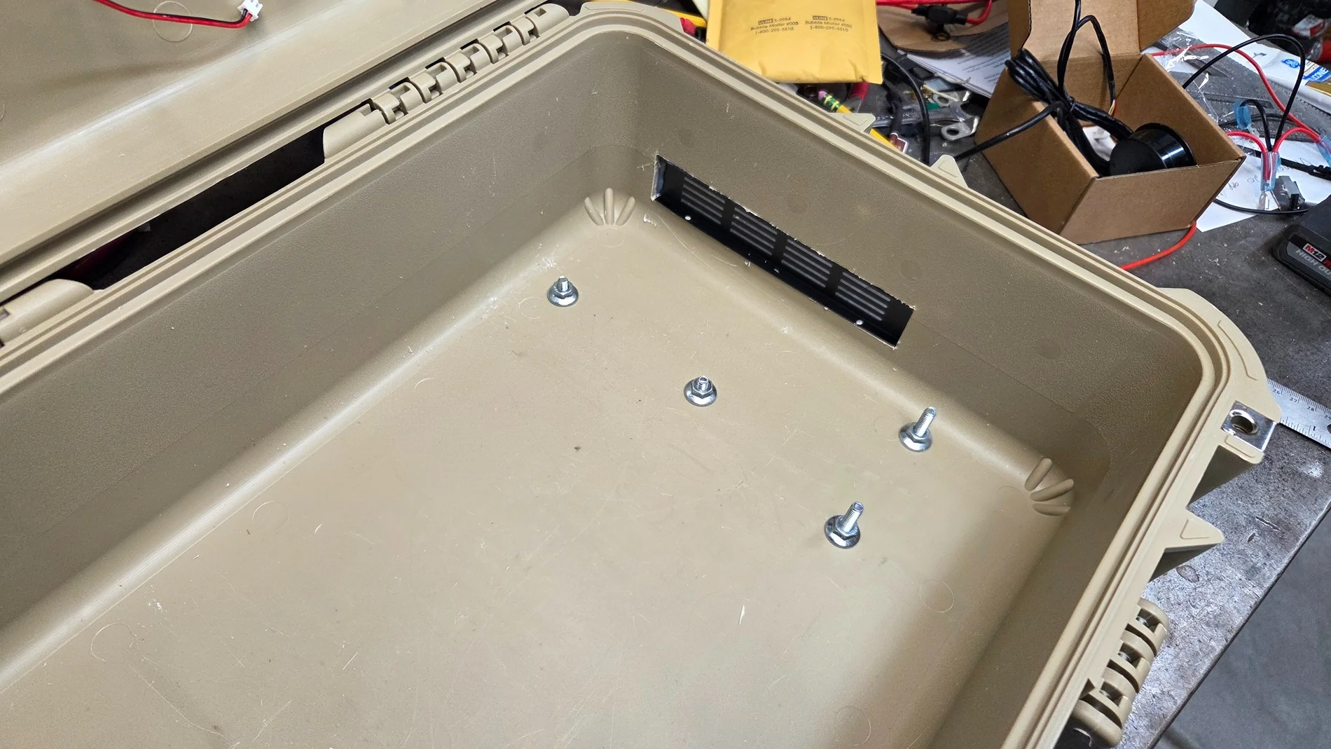

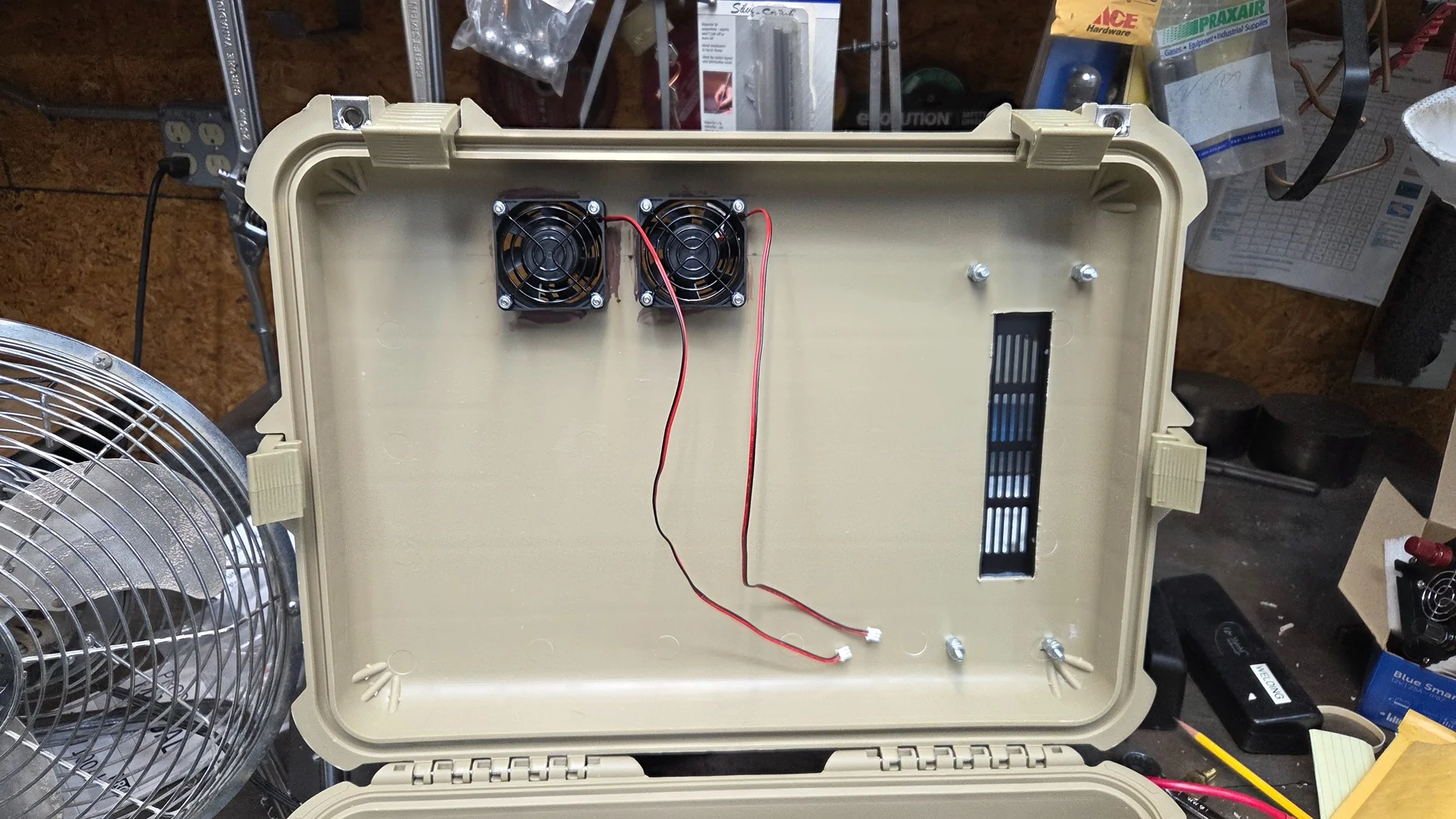

There are two 3" PC fans and 2 intake vents. The intake vents are located behind the inverter and alongside the charger with both devices mounted to allow air space completely under and around them. The PC fans are located so the intake air will draw around the 2 devices then across the battery and out the top regardless whether the unit is laying flat or standing upright. The fans have a separate switch so when not needed, like for USB charging etc, they can be left off to conserve power. I can also open the case while charging to allow cooling. At this time I have no solar charge controller.
Unfortunately I live in a very hot climate so there will be times when the battery temperature will be unavoidably out of the optimum range, but one of the advantages of building your own is that any part can be easily replaced. If and when the battery dies they now make more ah in the same size enclosure and will likely get even better as technology advances.
