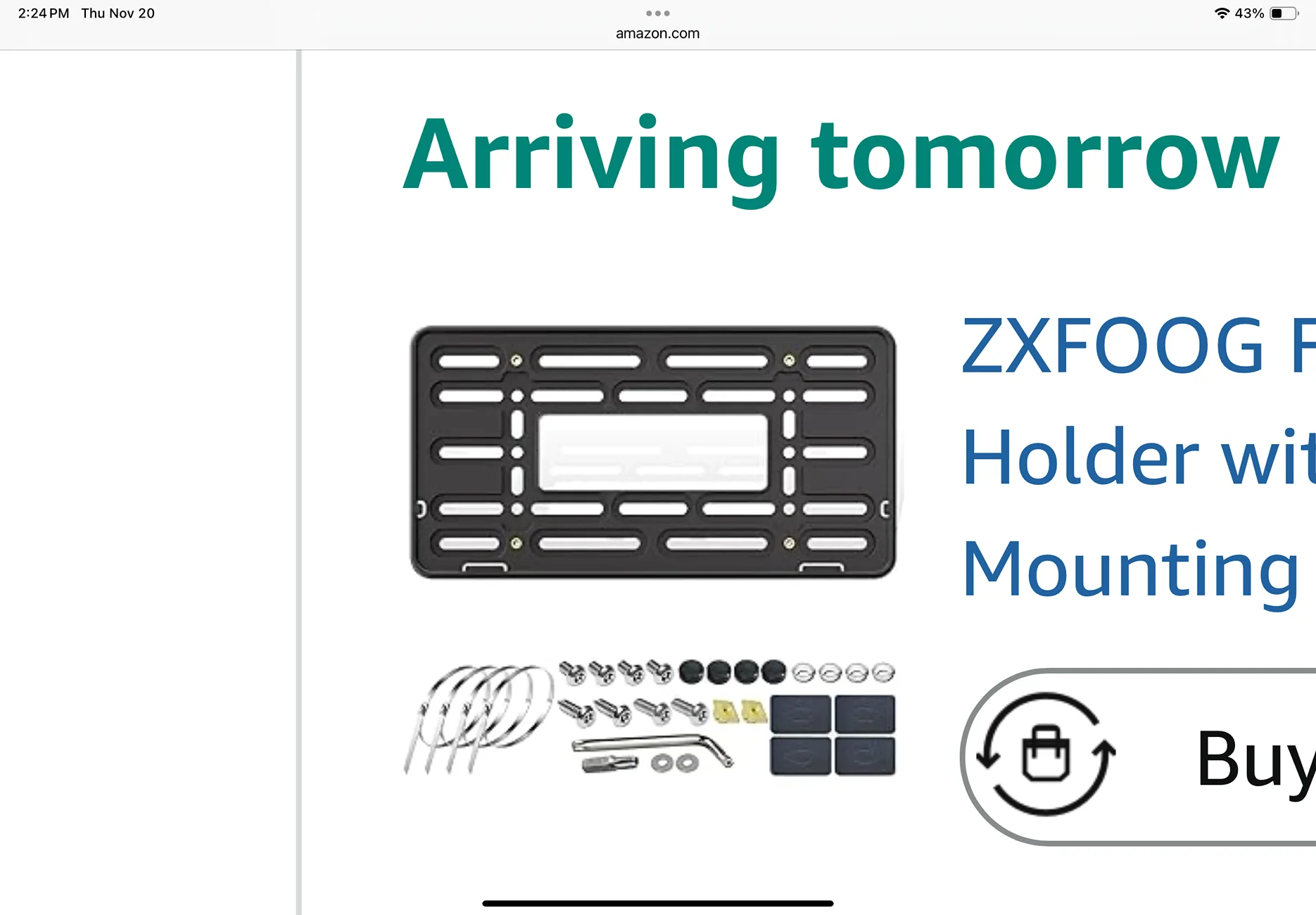

Ordered one of these and will mount it
Ford Ranger Front Collision Avoidance system conflicts with front license plate. IMG_0637
higher. Thanks for the responses to the issue. I see a lot of vehicles with no front plates now. Mostly Teslas.

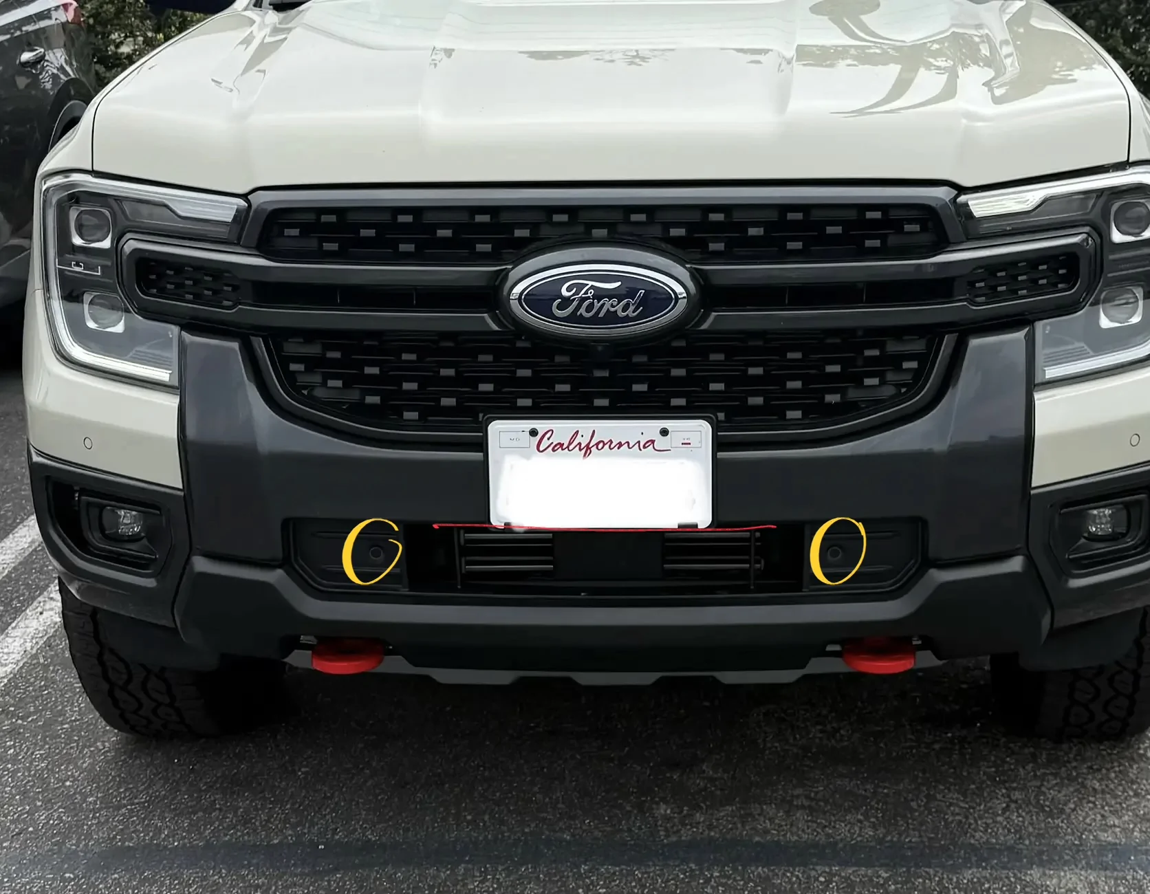

on my 2025 two of the sensors are circled in yellow
i think if the license plate drops below the red line, it could interfere with the sensors
just a theory.
just a theory.
It's not really those sensors it's the one right under the license plate. Only really affects the ones that have that black plastic piece. Don't think the XL/XLT's have that.

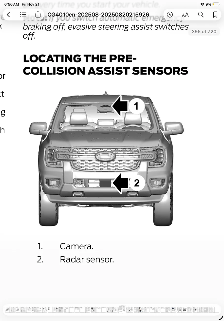

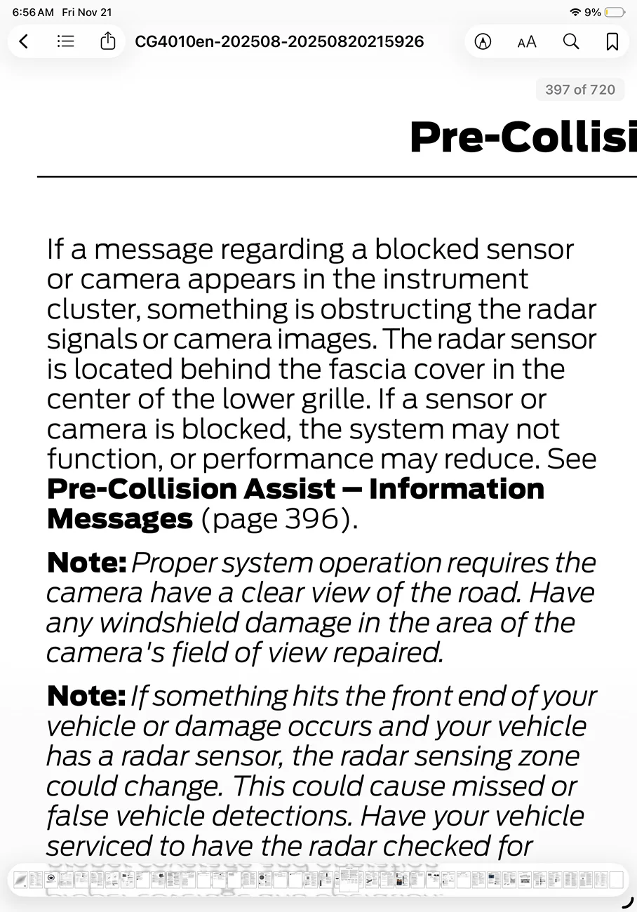

I was wondering why the dealer put the temporary license for the front of my new Ranger XLT in my glovebox. It turns out that after putting my new DMV issued plate on, I got a warning light that the front collision system is blocked. CA law states that I need to have a plate on the front but I have been seeing many cars/trucks today with that “black box” and no front plate. Has anybody come up with a good mount/bracket for the front of a Ranger? Currently driving with no front plate now. 🫤
My 2025 was shipped with a bracket from the factory. It was listed on the window sticker with no charge. I have the adaptive cruise control and it is fine. It is mounted above the radar.
