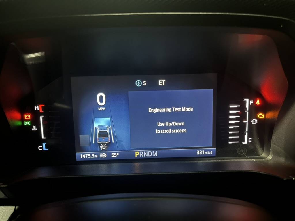

So I confirmed the same trick engineering test (ET) menu is accessible on my 6G Ranger XLT. The only difference is that you need to hold down the OK button on the right side of the steering wheel then press OK to get past the default seatbelt status screen. NOTE the images below are from my XLT, so if you have a Lariat or Raptor it may look a little different.
Ford Ranger Fuel Economy Improved After 500 Miles A5A7C981-1968-48FF-8AFA-2294B8B869E4_1_105_c

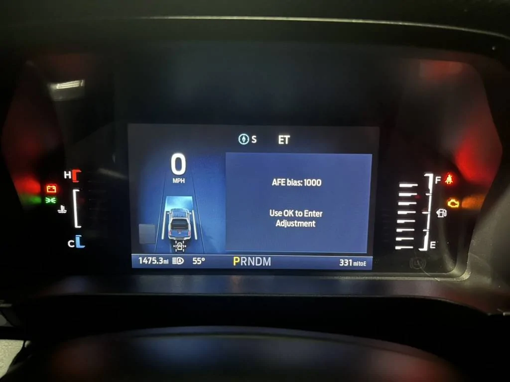

From ET main screen, scroll up one click on the ET menu to get to the AFE screen.
Ford Ranger Fuel Economy Improved After 500 Miles F5223478-4CAD-4FB0-9DF9-04947D166A6C_1_105_c
Then follow the instructions posted by RCMUSTANG on the 5G Ranger Forum to enter your hand-calculated MPG modifier. See link below:
https://www.ranger5g.com/forum/threads/fuel-calculator-adjustment.2996/
