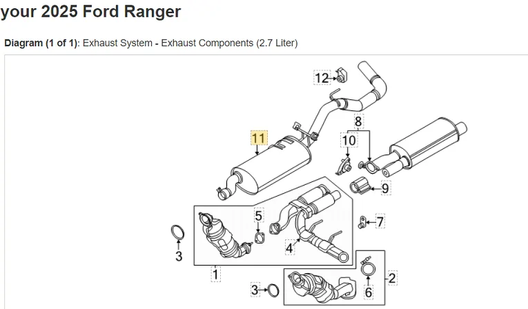

Looks like all we would need is a larger muffler with 2 inlets and 2 outlets a muffler shop to custom fit it in there. Should be pretty easy for good muffler shop to pull something like that off.
Diagram of Ranger Raptor Factory exhaust.
Ford Ranger I want a QUIET exhaust 1773954053180-hs
This is a diagram of the exhaust system on a 2.7L Ranger.
The muffler looks much larger.

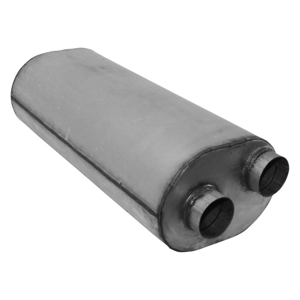

Ford Ranger I want a QUIET exhaust 1773954451736-c3
I am thinking something like this with the appropriate size inlet and outlet pipes to tie back into the rest of the system.

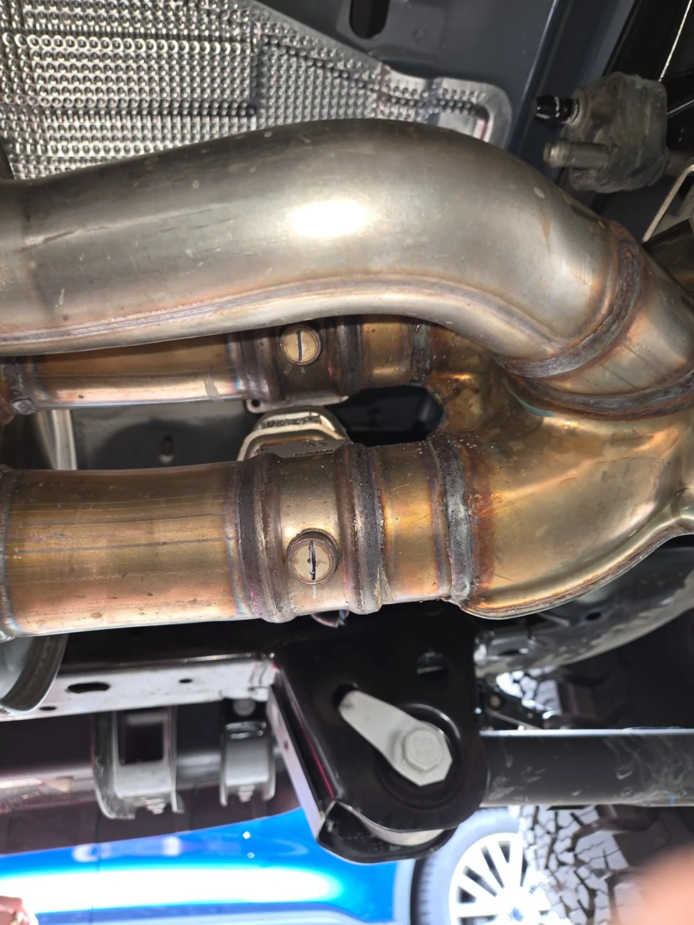

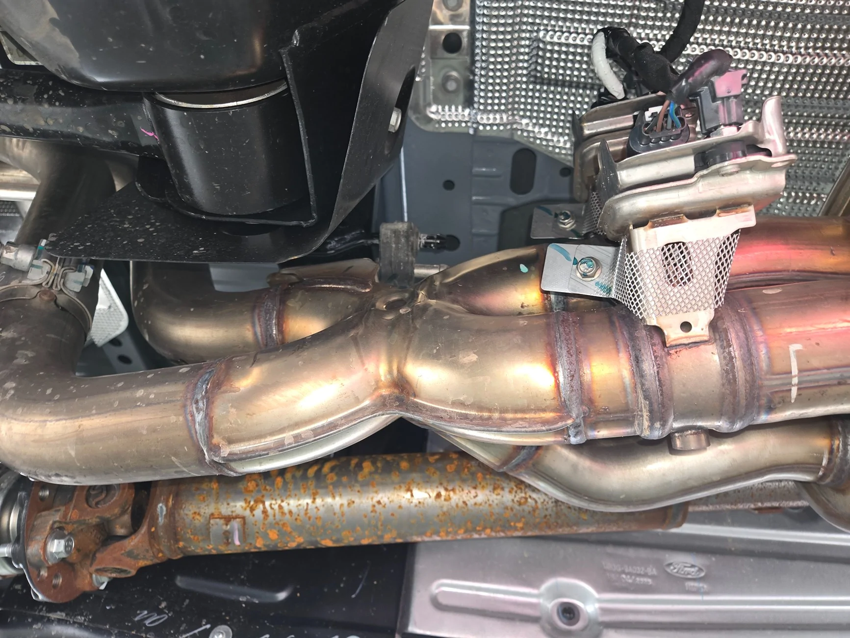

I am thinking the exhaust sound level control valve is not inside the muffler.
Possibly this might be it here in the diagram.
Not 100% sure?
Please post pics of it if anyone knows for sure where it is located.
Could just be a hanger or sensor?????

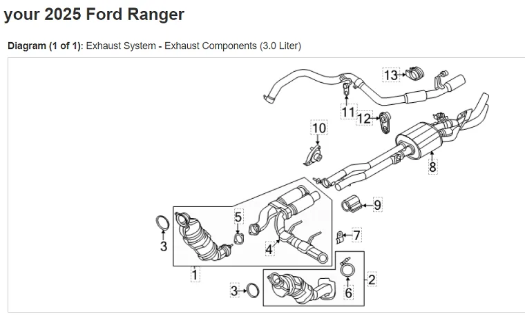

The muffler has 2 inlets and 3 outlets.
There are 2 valves on 2 of the outlet pipes.
Then all 3 go into an X pipe (it has 3 in and 2 out.)
Then the duals go over the axle and thru 2 tiny resonators, then out the back.
