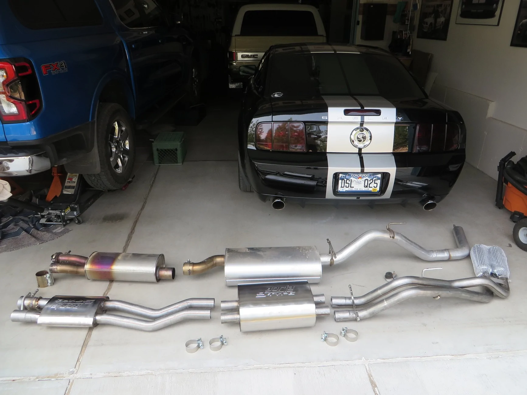

I have a stock exhaust off my 2025 2.7 Lariat if you would like to purchase it. I replaced it immediately with a Borla and have never been happier. Take a vacation to Colorado and head up into the mountains.....it will be waiting for you.

From the measurements I've taken, there is a 1" gap between the 2 pipes before the muffler. There is only about 10 inches of straight pipe to work on each side with the the hangers. It looks like the only one i can find that could possibly fit is the
Borla Universal Muffler Part # 400938
Muffler Tubing Size: 2.5"
Bottle/ Bullet Resonator 2.5" Center Inlet/ 2.5" Center Outlet, 3.5" Round,10" Long Body, 14" Overall Length. Universal Part. Reversible Design.
The Vibrant ultra quiet would probably work to replace the rear resonators. They are not much bigger then the stock ones.
Height: 4.750"
Width: 6.500"
Body Length: 9.750"
The stock ones are only about 8 inches long and about 5 inches in diameter. Some of the heat shield would have to be trimmed on the passenger side pipe.

A muffler shop could easily bend the pre muffler pipes to gain separation/clearance.
