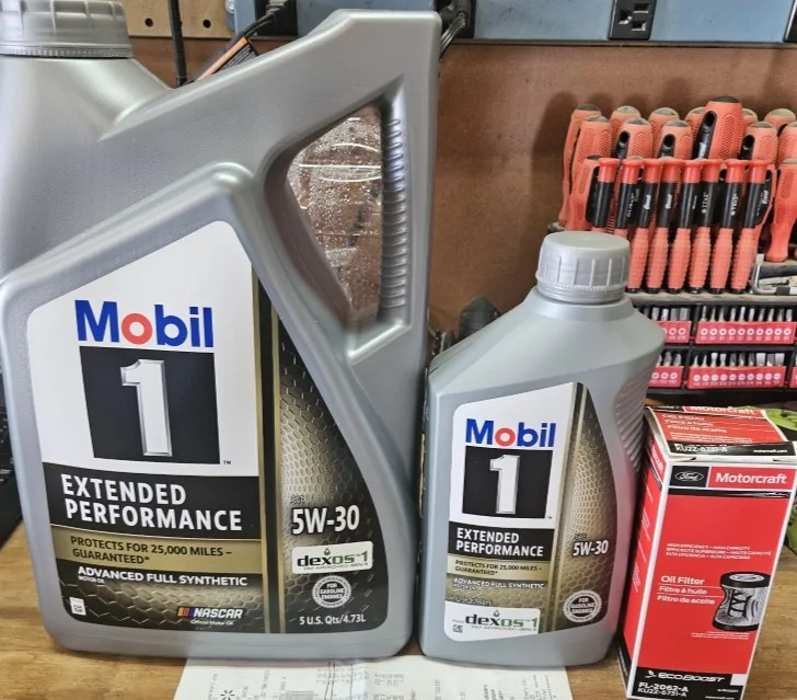

PUP has always been hard to fine around here. Nonexistent at Wally World.
I've run M1 0w-30 ESP in my Jeeps. Good stuff. Thought about it in my Ranger 2.7L but it does not meet Ford spec and with the wet belt I figured I better stay with something that does.
Going to use this with 5K OCIs. Meets Ford spec and still a darn good oil. I'll do an occasional UOA to see how the engine likes it.
