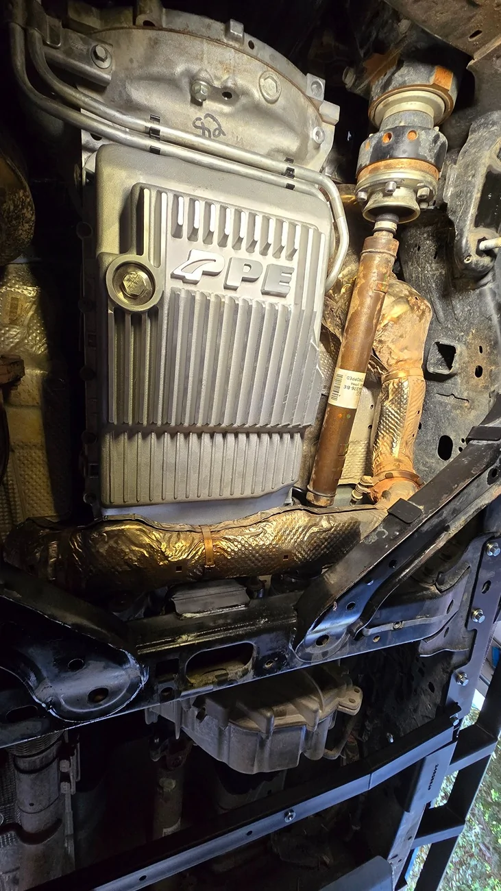

I've got full skids and haven't noticed any trans temps being higher after installingthem. I pull my 3k overlanding trailer on most trips from east coast to west coast.
I just installed a PPE deep trans pan mainly because I wasn't a drain plug and the deep pans didn't cost much more than a shallow one.
Holds almost 2qrts more, I'll post up if I see any difference on next trip coming up.
