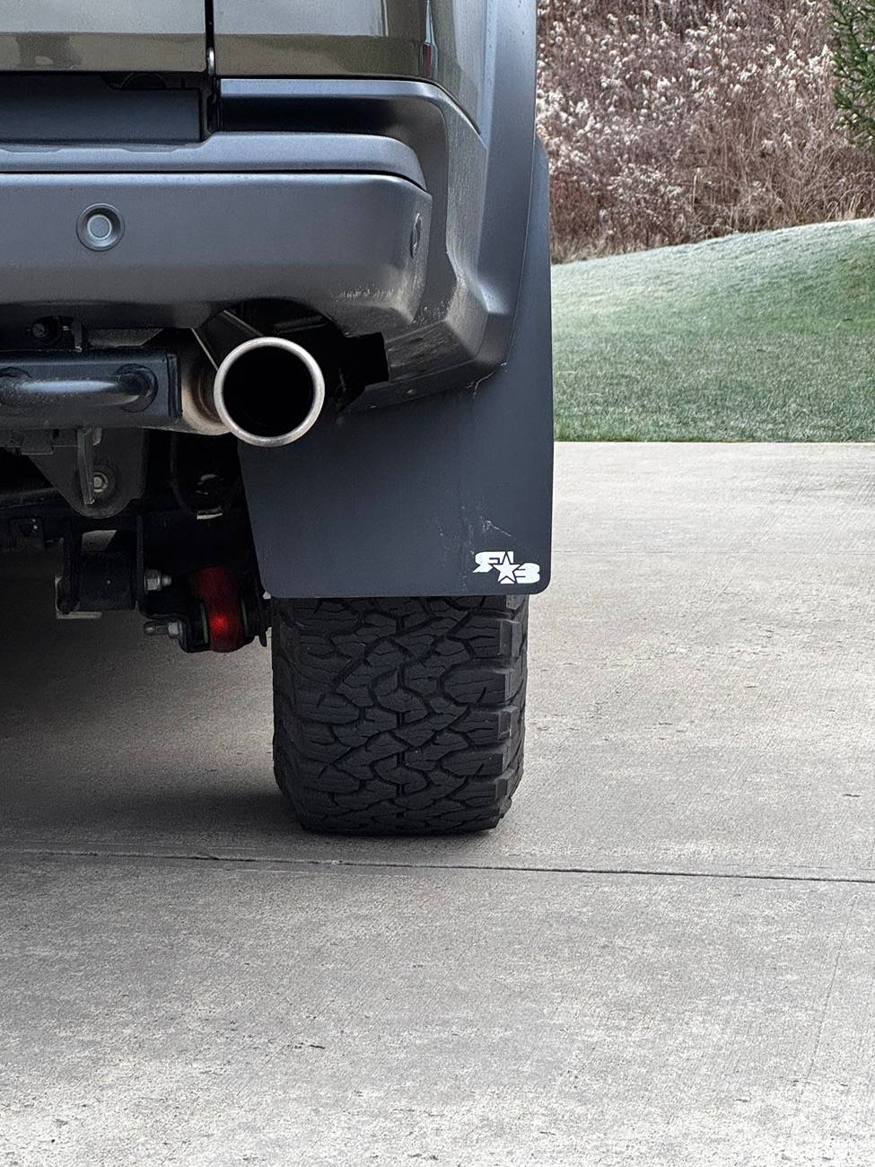

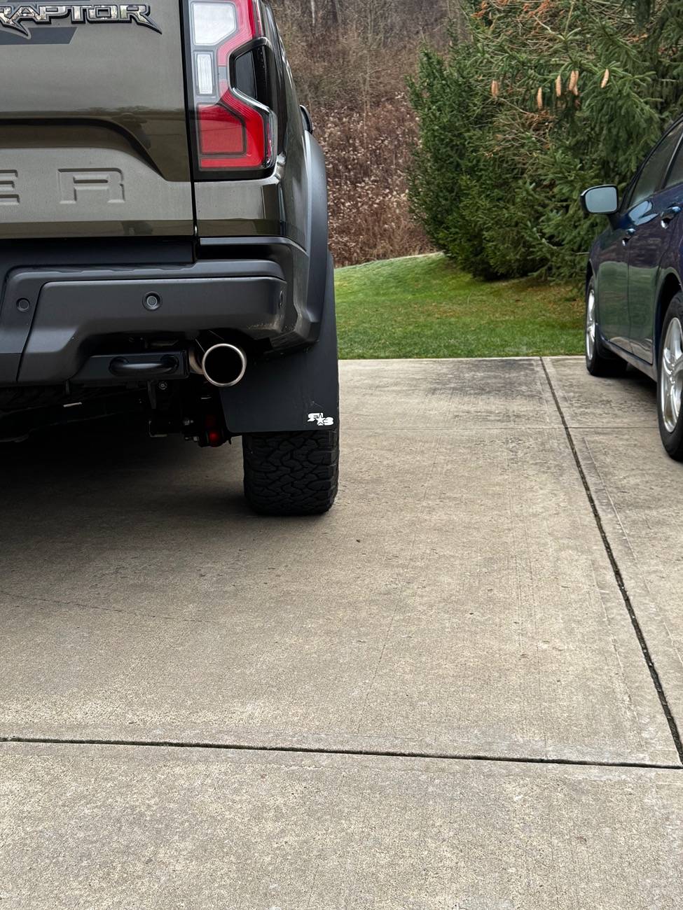

Let me preface that I usually have new wheels before I take delivery of my vehicles. Unfortunately, I’ve yet to find a set for my RR that I really want and can justify the cost. I’m sure as more RR get on the road there will be more options. But for now I couldn’t take the offset of the OEM wheels and the RokBlokz exaggerated the tucked in look.

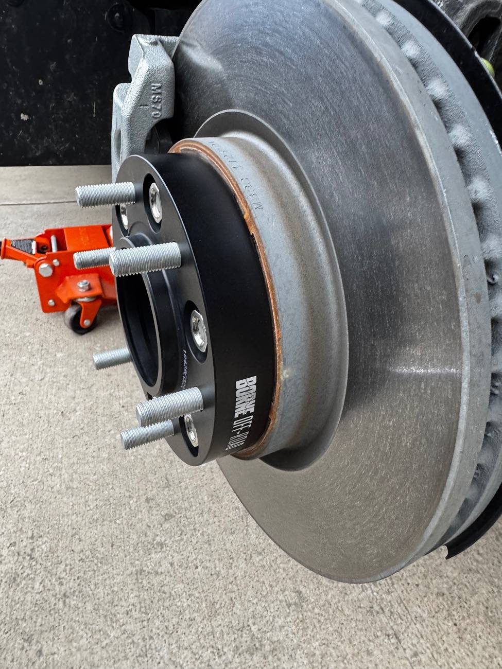

Thus spacers. I read some threads where folks were using either 1 inch or 1.2 inch spacers from various vendors. I went with Borne Off-road 1.2 inch since I’ve used many Mishimoto mods on my past vehicles and had great customer service and very happy with their products.
The part number is BNWS-001-300BK. The packaging was great and each spacer was protected by multiple layers of bubble wrap. The threads had plastic caps on them for protection as well.
Zero rubbing issues even with the suspension compressed and at full lock going up my driveway.
IMO the look is great and this subtle mod really makes the truck have a proper stance. Tires are not poking. Flush with the fender.
For those interested in weight…. They are under 1 pound each.

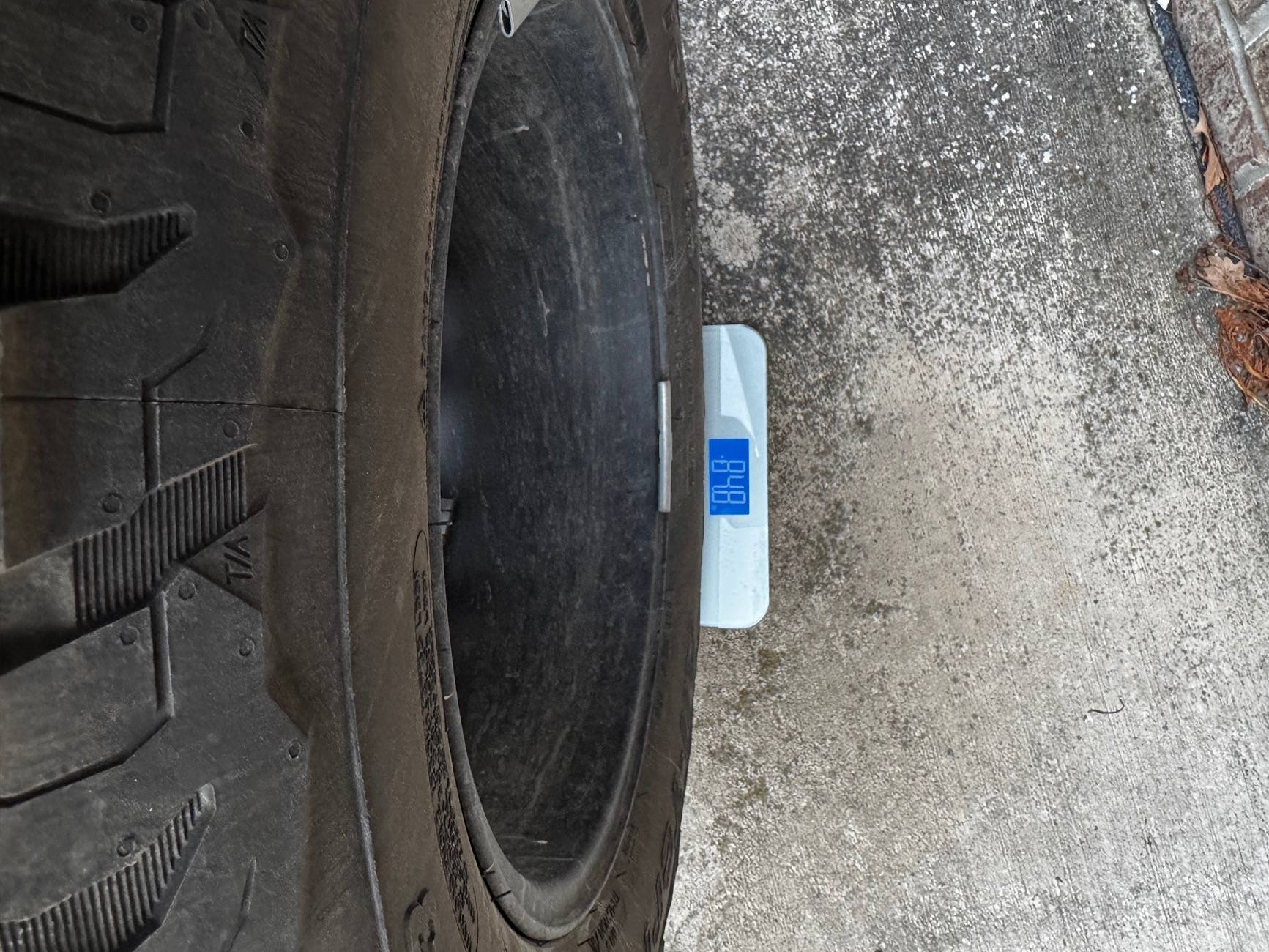

When I had the wheel/tire off I took tbe opportunity to weigh them as well. They come in just under 85 lbs. This is with the stock KO3s and non beadlock wheels.
I torqued everything to 105lbs and I’ll retorque everything after a few hundred miles.
Before
Ford Ranger Borne Off-Road Spacers installed on Ranger Raptor IMG_9971
After
Ford Ranger Borne Off-Road Spacers installed on Ranger Raptor IMG_9978
Ford Ranger Borne Off-Road Spacers installed on Ranger Raptor IMG_9980
OEM wheel tire weight
Ford Ranger Borne Off-Road Spacers installed on Ranger Raptor IMG_9974

Nice. What lug nuts did you use? Any other longer hardware needed?
bowhun2r
bowhun2r
Scott
Jul 1, 2023
62
Pittsburgh
RR Marsh Gray 25
SAP Solution Architect
The lugs to attach the spacers are included with the spacer kit. You can use your OEM lugs to secure your wheels to the spacers. I’m currently running black Gorilla lugs. No modifications needed.

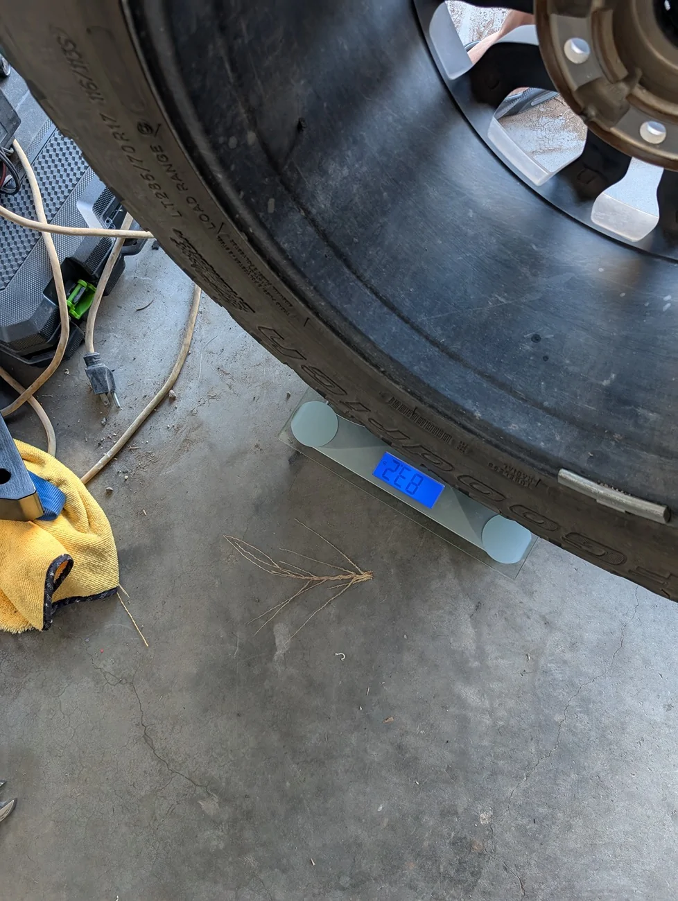

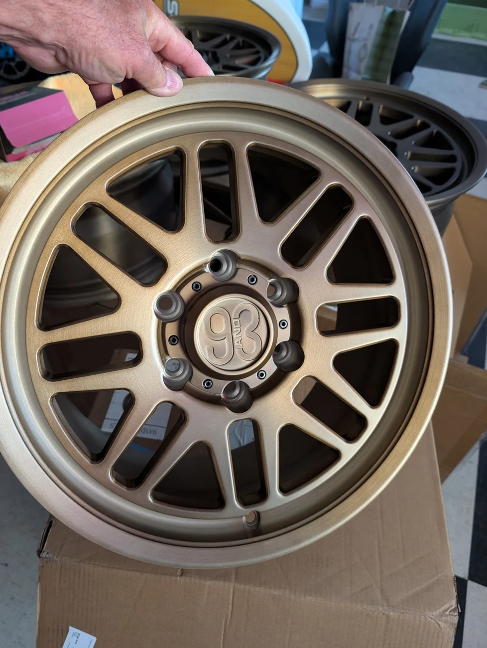

Funny. I weighed my stock wheel tire combo this weekend also. I have new 35s coming on Wednesday that are going on the 9 and three wheels that I bought. Wheels weigh 22.6 lb
Ford Ranger Borne Off-Road Spacers installed on Ranger Raptor PXL_20251012_153904803
Ford Ranger Borne Off-Road Spacers installed on Ranger Raptor PXL_20251013_232938152
