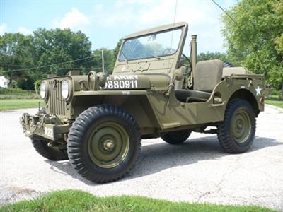

There is a reason why the US Army has always put narrow tires on the all-terrain/go anywhere/get-the-job-done workhorse Jeep. We are not talking about Baja racing, but general off-road utilitarian use.
Ford Ranger Wider vs Narrower Off-Road Tires Comparison 1952WillysM38MarkSchmiedeskam

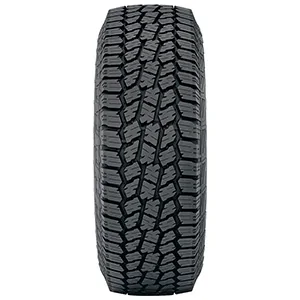

Heres the tred of the tires I went with. Yokohama Geolander A/T4 in 315/70R17
I did consider the Goodyear Territory MT tires another user @markferry runs, as they 9lb lighter putting me at 15lb lighter and over 20lb lighter with different rims. But reading around some people say their wet performance isnt all that great and they are noisy being a MT. I could have gone with lighter rims, but the price difference, and looks of what was available put me off.
I had great luck with the yokos on my previous truck in Montana winters.. Don't really have a comparison for hydroplaning, never had an issue on old truck though. Yoko does specifically state their patter helps 'sweep' away water to 'minimize the chance of hydroplaning' and i don't see anything about that on the Ko3 marketing.
Once I saw the yokos were so light it was an obvious choice for me atleast. The yoko and the goodyear territorys are the lightest 315s I could find. Pretty much all others were over 60lb and some 80 or more.

That's a strong attempt at a circumferential rib.
I think they'll track appreciably straight on the road.
