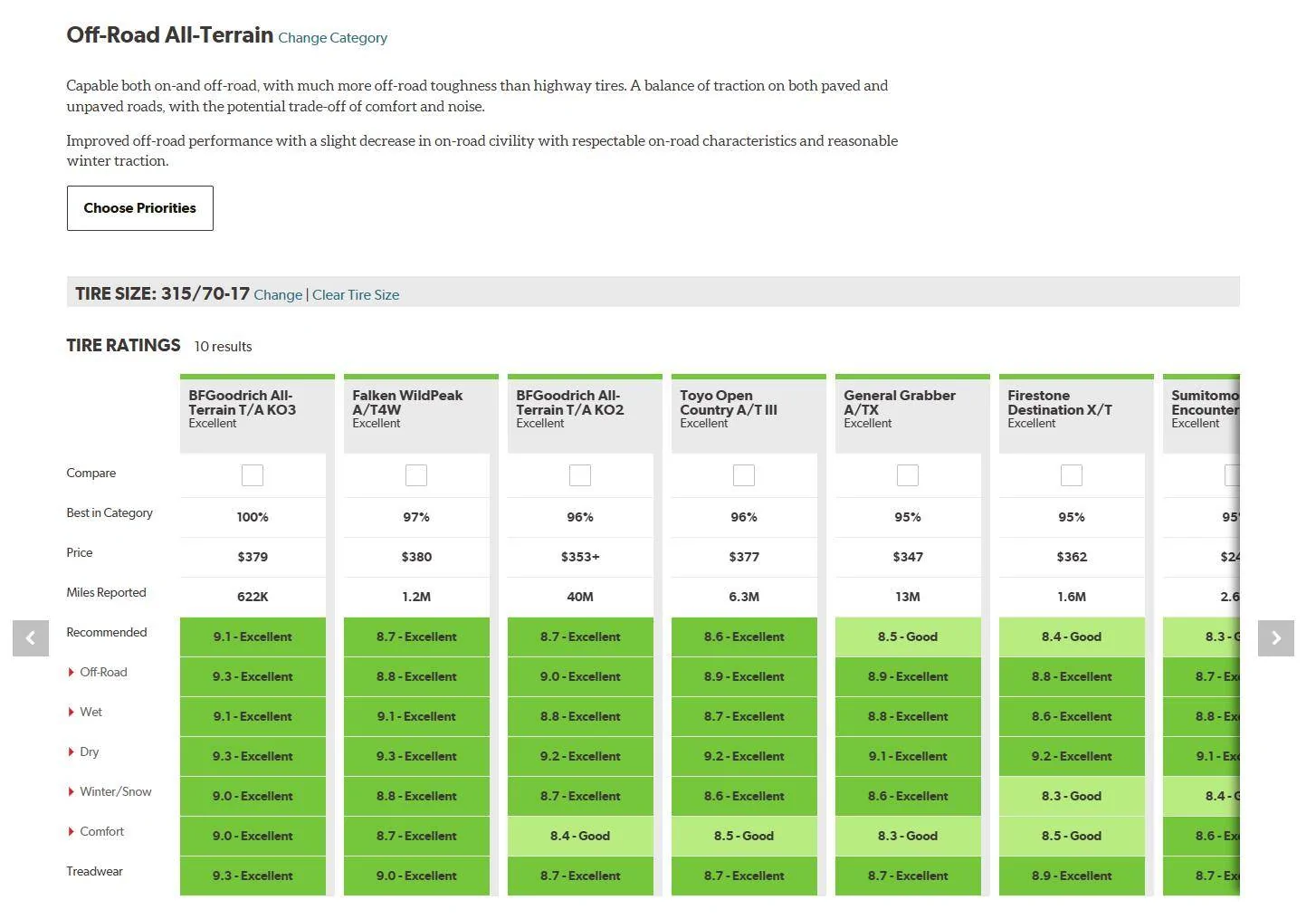

The K03's have a softer rubber compound than the K02's which were great off-road but not the greatest on-road. The particular varint of the K03 that comes stock with the RR is also a "custom variant" specifically for Ford.
They worked with BFG to develop a tuned variant in a C load range for the RR to get better ride quality and grip when off-roading because the existing 285/70R17 was an E load range that was too stiff for the lighter weight RR application.
The RR is the FIRST truck I've owned as well, it's also the FIRST vehicle where I actually really liked the factory tires performance. K03's as a tire series are also rated by users on Tire Rack as the BEST off-road tire overall, but WildPeak A/4TW's are a close second:
Ford Ranger Better street type tires if hardly ever going off road? 1752752747552-dh

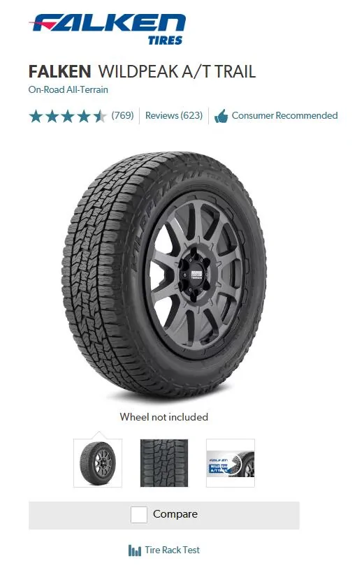

BTW, I run Falken WildPeak A/T trails on my wife's CX-9 and they are awesome on that car (obviously it's a road-focused AWD mid-sized sporty SUV, so we didn't want legit off-road tires, but something more aggressive for bad weather, dirt / gravel roads etc.).
I've also gotten crazy mileage out of them on the CX-9, at 70k miles and still 5/32 tread (getting close to replacement now, but I only expected them to last 40-50k). But they don't make anything that would fit the RR, too bad cause that would be your "road focused, light duty A/T tire" your looking for. Still, I'm pretty happy with the K03's even on the road, and their off-road prowess is top notch, so I'm sticking with factory KO3's on my RR.
Ford Ranger Better street type tires if hardly ever going off road? 1752752911661-sr
