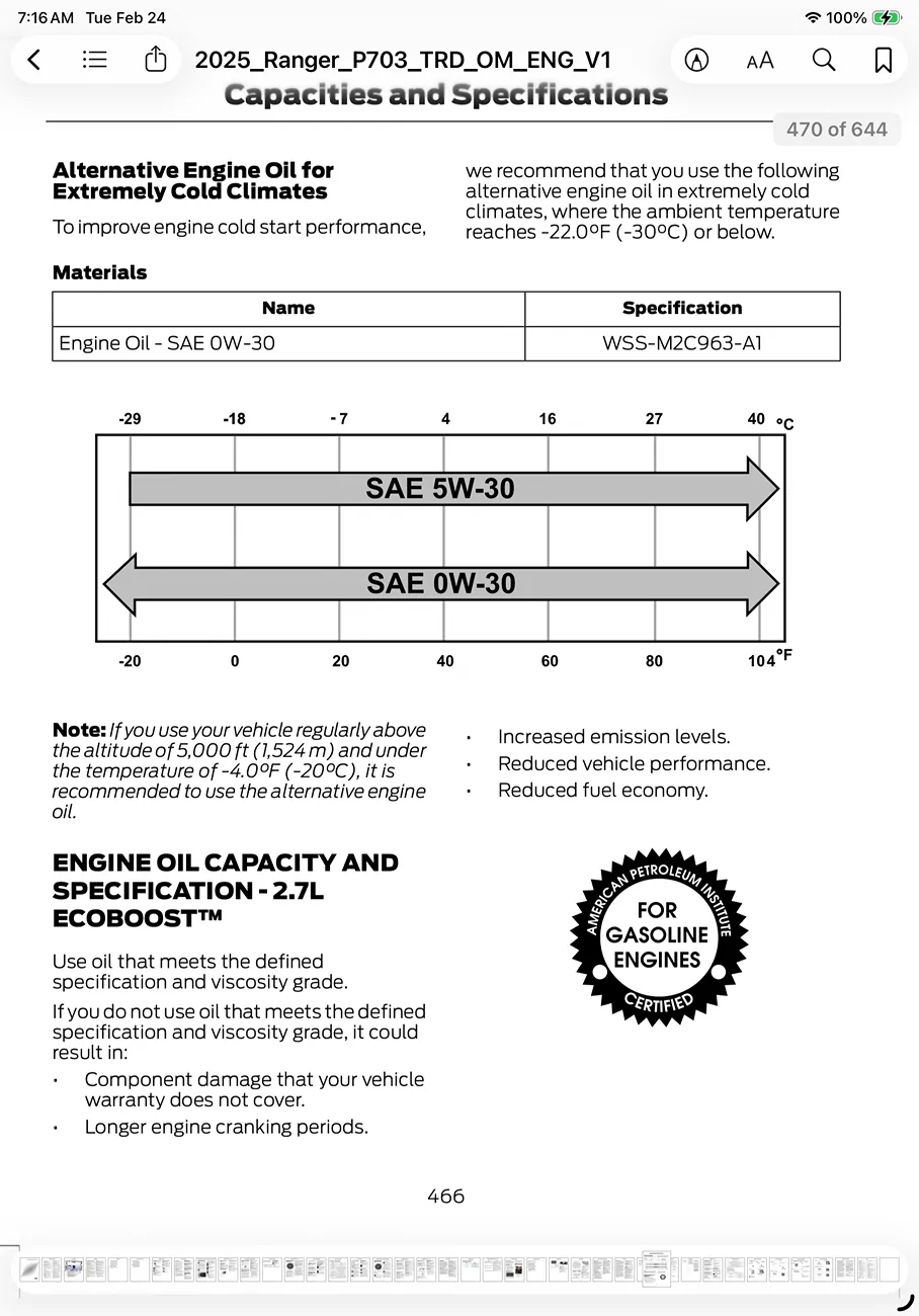

All Ranger EcoBoost engines require the same Viscosity Grades:
  • 5W-30 or 0W-30 recommended for cold climates -22.0 °F (-30 °C) or colder
All Ranger EcoBoost engines are compatible with the following oil specs:
  • Ford WSS-M2C971-A1, WSS-M2C961-A1
  • Ford WSS-M2C973-A1, WSS-M2C963-A1 in Cold Climates -22.0 °F (-30 °C)

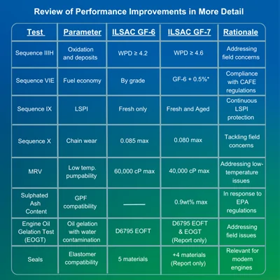

Ford M2C97 vs ILSAC GF-7
Ford's WSS-M2C97 is the latest Ford oil specification carrying additional criteria to meet and exceed the requirements of the ILSAC GF-7 industry standard. All ranger EcoBoost motors were originally certified for use with GF-6A oils, but benefit from GF-7A through better cold cranking viscosity and LSPI improvement.

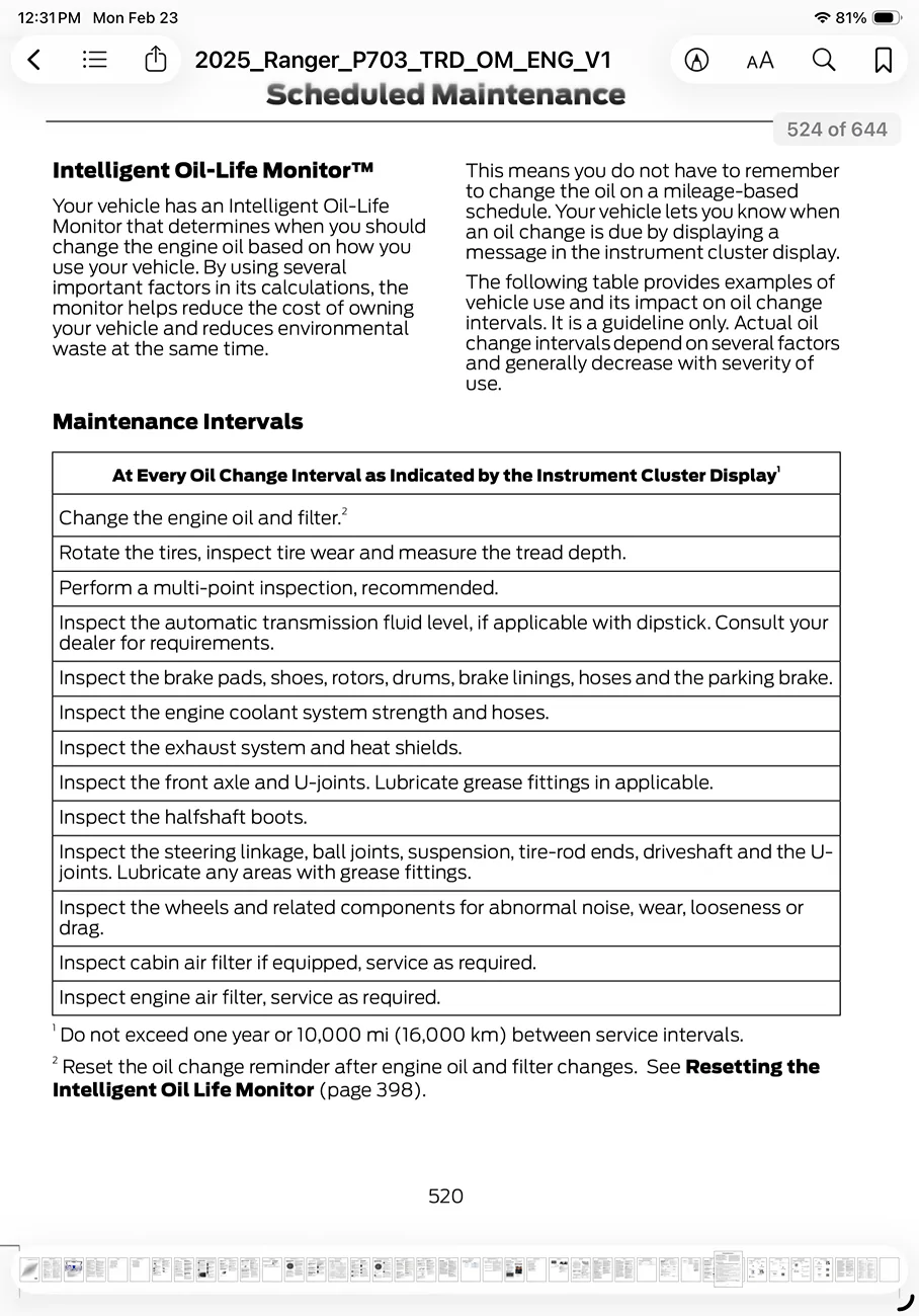

Oil Change Intervals
Ford Service says an oil change is required on:
  • oil service indicator warning OR
  • one year OR
  • 10,000 miles.
My personal advice is to change your oil every 3000 miles or 5000 km, don't wait for the oil interval warning. Many will argue but I am biased on the side of aggressive oil changes as I live in an arctic climate, and I base my judgement purely on ease of cold weather starting. After a fresh oil change all my engines crank over easier in the extreme cold, period.

fords service interval is 10k
i haven’t seen anything to suggest 5k is more than sufficient for any of the oils on the list
that’s looking at oil analysis reports ranger owners have graciously shared.
I notice in the new 2026 ford ranger manual.
WSS-M2C971-A1 is now listed as the oil spec
i do not think motorcraft Synthetic blend meets WSS-M2C971-A1 or the 961 specs?
even though it is listed as a suitable oil

Yes, this my personal recommendation and I don't think anyone who follows it will regret doing so.
As mentioned, Ford service interval is 10,000 km.
the actual maximum service interval is 10k miles
although supposedly the oil life is monitored
Ford Ranger EcoBoost Ranger Official Certified Engine Oils IMG_3556
No, it's not 10k km, it's whichever comes first: oil service indicator OR one year OR 10,000 miles. I had a recent analysis of oil with about roughly 3,000 miles on it and the oil was still rather serviceable (TBN still over 5). Sure, the engine won't mind super frequent changes, but the reality is you're wasting money with no measurable or observable benefit.
I don't claim to know all the factors used by the vehicle's oil life monitor, but I can confirm that your actual use is factored.
I have about 11,000 miles on my truck. I did a break in change at 1,000 miles and didn't look at the oil life indicator. At almost exactly 5000 miles (4000 on that oil,) I changed it again and the oil life was at 65%.
At 10k I had it changed, and the oil was at 90% (or 10% left.)
The last oil got "used up" significantly faster. I have a 3500 pound camper, and that 5000 miles was about 40% towing. The previous oil change with 4000 miles included about 25% towing.
So, I'm not certain about other factors, but the load from towing did result in the oil life monitor indicating greater depletion of oil life.

GF-6 was a BIG deal back in 2020 especially for TDI engines, not so much for NA engines where the previous GF-5 spec was tailored towards. That may be one reason why Ford had some issues with earlier generations of Ecoboost V6 engines, particularly the gen 1's had timing chain wear issues along with some cam phasor issues.
Valvoline™ is GF-7 ready - Valvoline™ Global
GF-7A is more of a "refinement" on GF-6 rather than a massive jump, but it is an improvement none-the-less, I think the cold cranking viscosity improvement and LSPI improvement are probably the most notable real-world advantages. GF-6 does pretty good with timing chain wear over GF-5, so it's only slightly better in that area.
Unlocking Performance: Inside the ILSAC GF-7 Specification | Afton Chemical
Ford Ranger EcoBoost Ranger Official Certified Engine Oils 1771950854700-dn
The new GF-7A addresses LSPI on aged oils where the older GF-6 was only on fresh oils, so that's a big improvement along with the substantial reduction in cold cranking viscosity.
