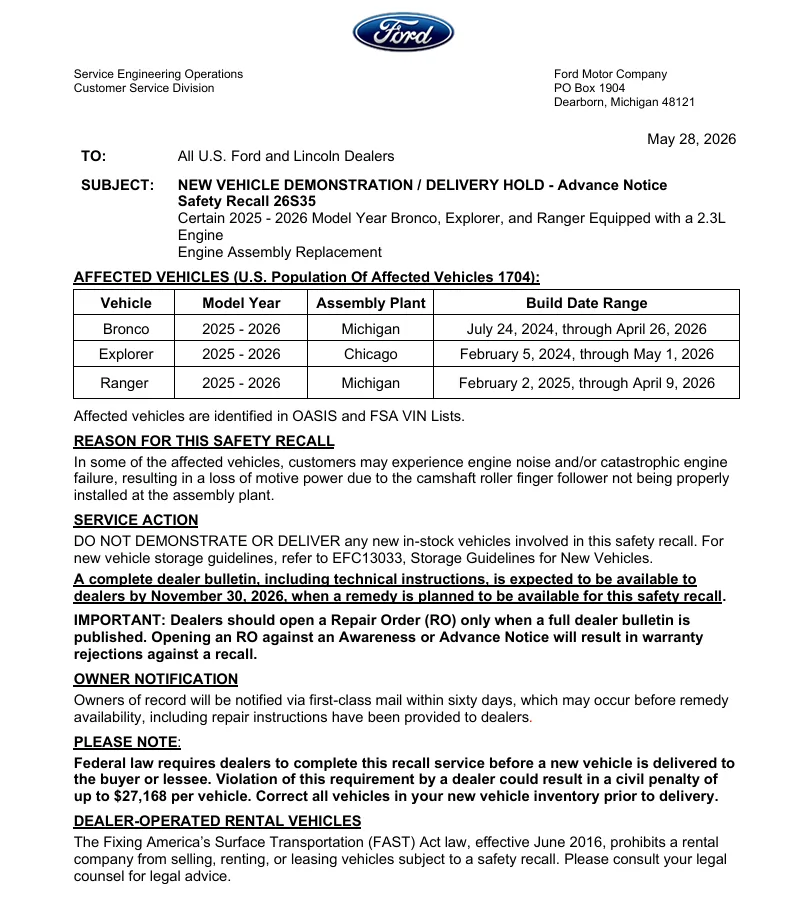

Ford Ranger Recall 26S35: 2025-2026 Ranger 2.3L Engine Assembly Replacement [May 28, 2026] {filename}
May 28, 2026
TO: All U.S. Ford and Lincoln Dealers
SUBJECT: NEW VEHICLE DEMONSTRATION / DELIVERY HOLD - Advance Notice
Safety Recall 26S35
Certain 2025 - 2026 Model Year Bronco, Explorer, and Ranger Equipped with a 2.3L Engine
AFFECTED VEHICLES (U.S. Population Of Affected Vehicles 1704):
VehicleModel YearAssembly PlantBuild Date Range
Bronco2025 - 2026MichiganJuly 24, 2024, through April 26, 2026
Explorer2025 - 2026ChicagoFebruary 5, 2024, through May 1, 2026
Ranger2025 - 2026MichiganFebruary 2, 2025, through April 9, 2026
Affected vehicles are identified in OASIS and FSA VIN Lists.
REASON FOR THIS SAFETY RECALL In some of the affected vehicles, customers may experience engine noise and/or catastrophic engine failure, resulting in a loss of motive power due to the camshaft roller finger follower not being properly installed at the assembly plant.
SERVICE ACTION DO NOT DEMONSTRATE OR DELIVER any new in-stock vehicles involved in this safety recall. For new vehicle storage guidelines, refer to EFC13033, Storage Guidelines for New Vehicles.
A complete dealer bulletin, including technical instructions, is expected to be available to dealers by November 30, 2026, when a remedy is planned to be available for this safety recall.
IMPORTANT: Dealers should open a Repair Order (RO) only when a full dealer bulletin is published. Opening an RO against an Awareness or Advance Notice will result in warranty rejections against a recall.
OWNER NOTIFICATION
Owners of record will be notified via first-class mail within sixty days, which may occur before remedy availability, including repair instructions have been provided to dealers.
PLEASE NOTE: Federal law requires dealers to complete this recall service before a new vehicle is delivered to the buyer or lessee. Violation of this requirement by a dealer could result in a civil penalty of up to $27,168 per vehicle. Correct all vehicles in your new vehicle inventory prior to delivery.
DEALER-OPERATED RENTAL VEHICLES
The Fixing America’s Surface Transportation (FAST) Act law, effective June 2016, prohibits a rental company from selling, renting, or leasing vehicles subject to a safety recall. Please consult your legal counsel for legal advice.

I guess the only good news is only 1704 explorers, broncos and rangers are affected if I am reading that right.
so probably only a couple of hundred rangers
and November seems like a long time not to sell those models so I imagine Ford will bust butt to get this out.
it might be a little esrly to look this up by vin.
but it you win the lottery it looks like a new engine?

I did the NHTSA VIN search, and I'm hit! For better or for worse:
ON YOUR VEHICLE, IT MAY BE POSSIBLE THAT ONE OR MORE ENGINE CAMSHAFT ROLLER FINGER FOLLOWERS WERE NOT PROPERLY INSTALLED AT THE TIME OF ENGINE ASSEMBLY.
AN IMPROPERLY INSTALLED ENGINE CAMSHAFT ROLLER FINGER FOLLOWER MAY RESULT IN ENGINE FAILURE, RESULTING IN A NO-START CONDITION OR A LOSS OF MOTIVE POWER. A LOSS OF MOTIVE POWER INCREASES THE RISK OF A CRASH. YOUR VEHICLE MAY ALSO EXPERIENCE ENGINE TICKING OR TAPPING NOISE, AND OR A LOW-VOLUME OIL LEAK DUE TO THIS CONDITION.
A REMEDY IS NOT YET AVAILABLE. FORD MOTOR COMPANY IS WORKING TO PROVIDE PARTS FOR THIS REPAIR. WHEN THE REMEDY BECOMES AVAILABLE, FORD MOTOR COMPANY WILL NOTIFY YOU VIA MAIL TO SCHEDULE A SERVICE APPOINTMENT WITH YOUR DEALER FOR REPAIRS TO BE COMPLETED FREE OF CHARGE. THE REMEDY IS ANTICIPATED TO BE AVAILABLE 4TH QUARTER OF 2026.

Dang, all of the sudden I'm happy I got the first iteration of the 2.3L and not the newer iteration.
It’s in Ecoboost Mustang. So wonder why it’s only these vehicles. Something had to have been done different on the SUV/Truck
