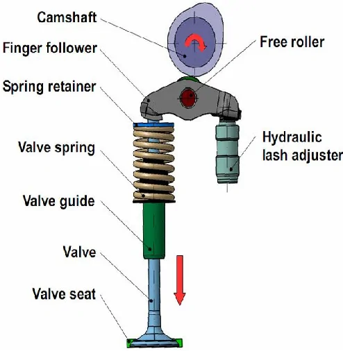

It's an odd date range. Ford's Cleveland plant builds almost all of the MPC 2.3L EB's for NA, with some early Mustang version having some engines produced in Valencia, Spain. Ford produces ~250k MPC 2.3L EB engines annually from Cleveland.
The diagram shows the relationship between:
  • camshaft
  • roller
  • finger follower
  • lash adjuster
  • valve spring
That layout is fundamentally how the modern MPC 2.3L EcoBoost valvetrain works.
