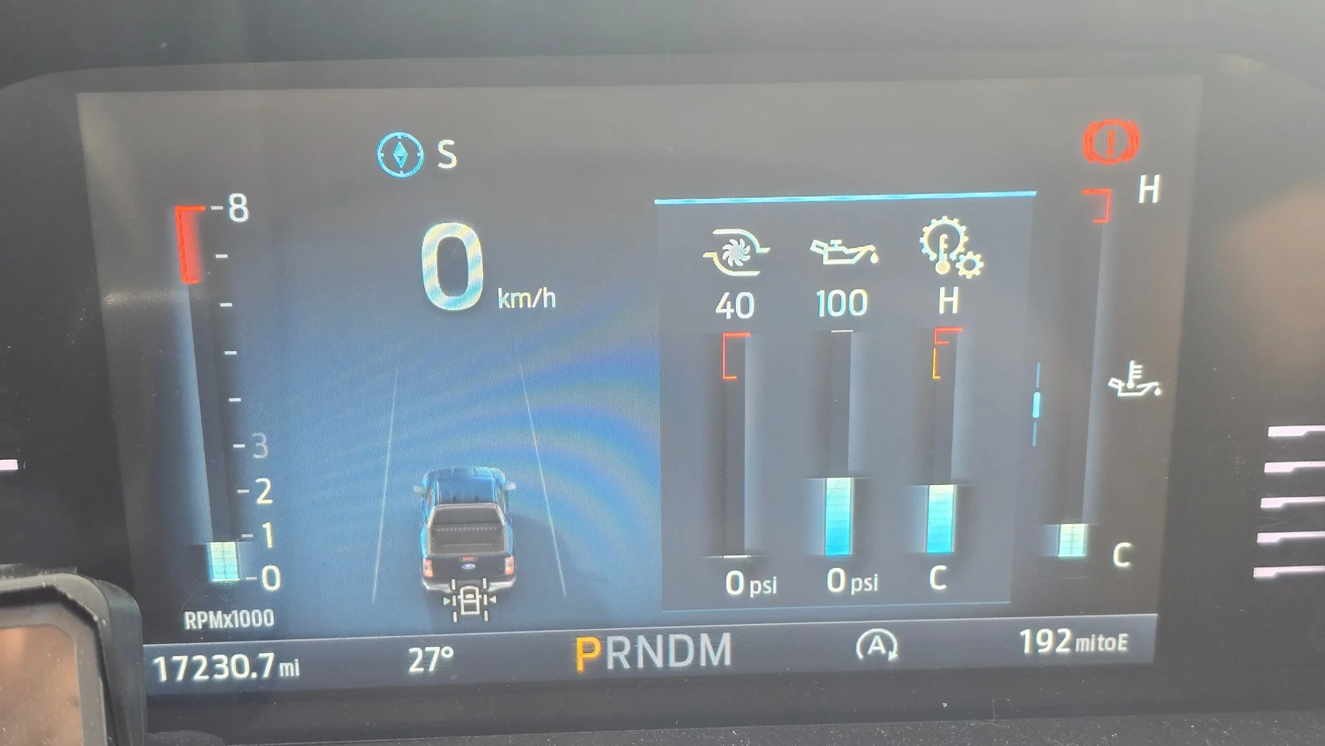

Anyone manage to find a fix through Forscan? Mines reading 28°C and it’s -3°C outside!
Noticed your dash is in MPH. So you're using imperial, and not metric. I don't think we can have "hybrid" its metric, or its imperial. 28°F is -2.2°C

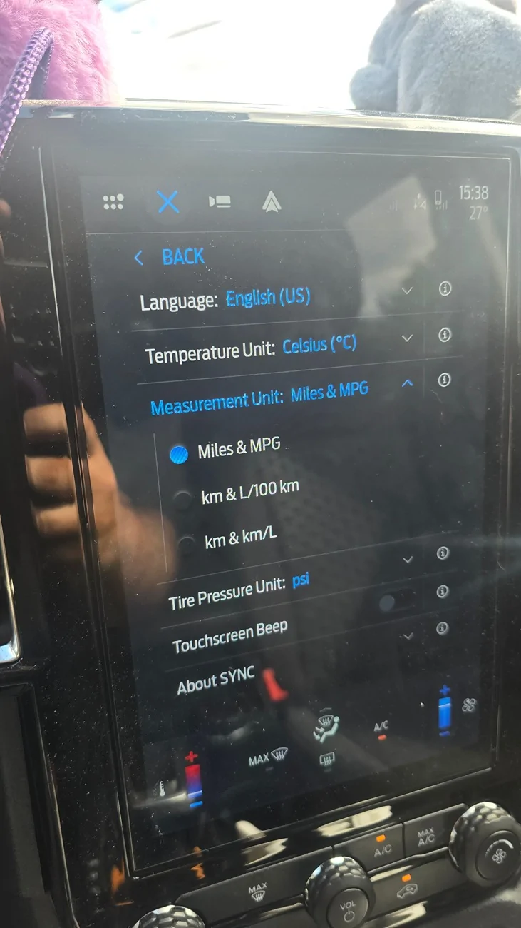

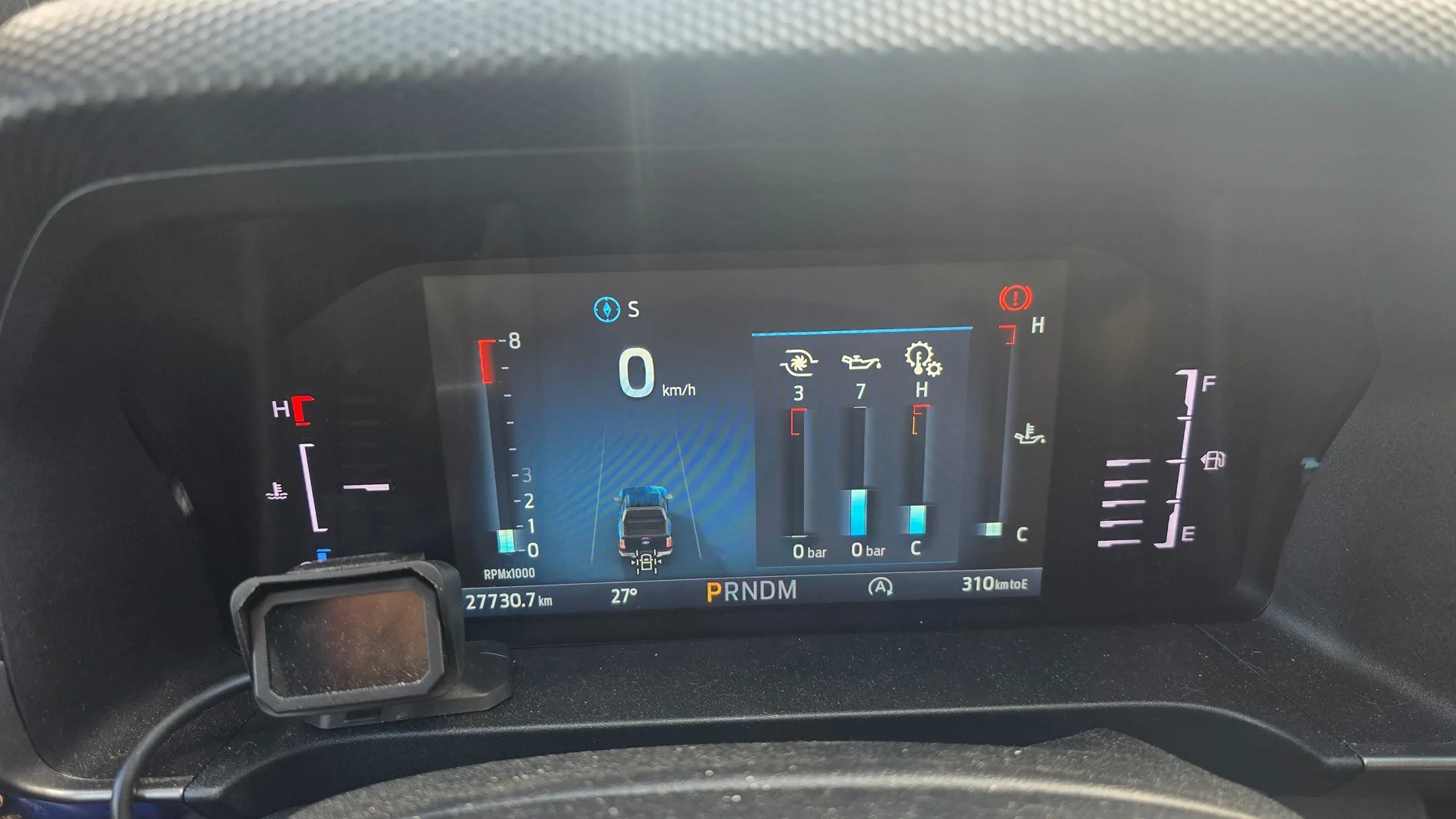

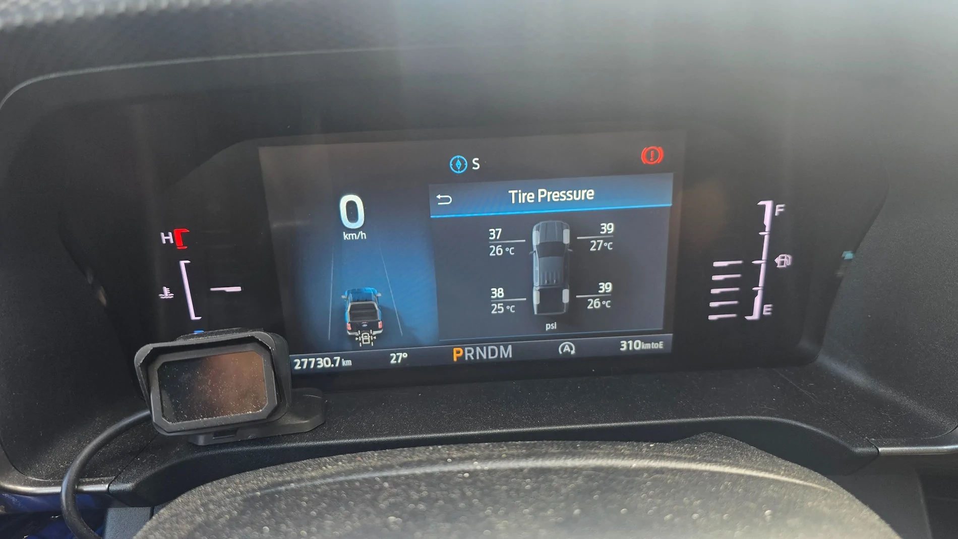

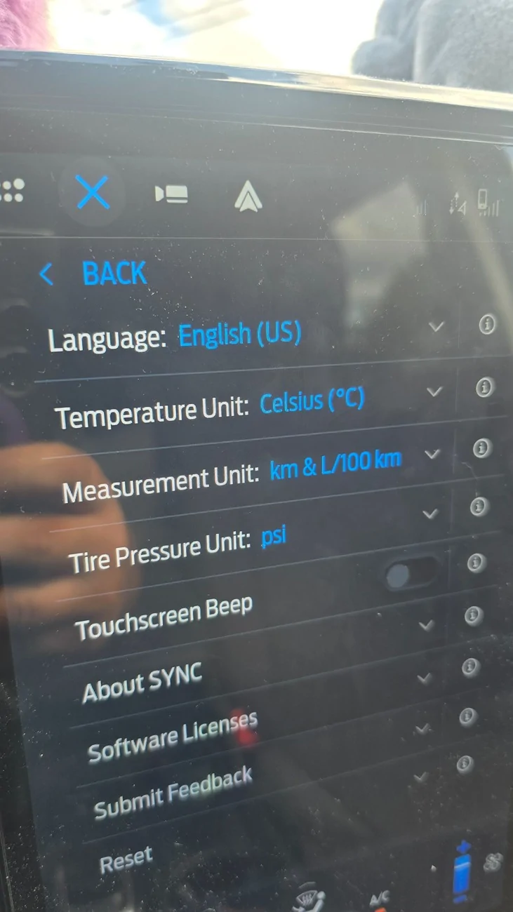

I can get mine to do both. I have my air pressure on my tires set to psi and other stuff to metric.
So do I. But anything engine related, I can not change, its stuck in metric, as its tied to the "measurement unit" setting in the general settings on the infotainment. Thats why my boost and engine oil pressure are in BAR, but my tire pressure is PSI.
If I change my dash to miles(speedo stays kmph) My boost and engine oil pressure switch to PSI.

I do see however the infotainment has a sepperate temp setting. and when I changed my "measurement unit" to miles and mpg. my ambient temperature and my speedo stayed in metric.
