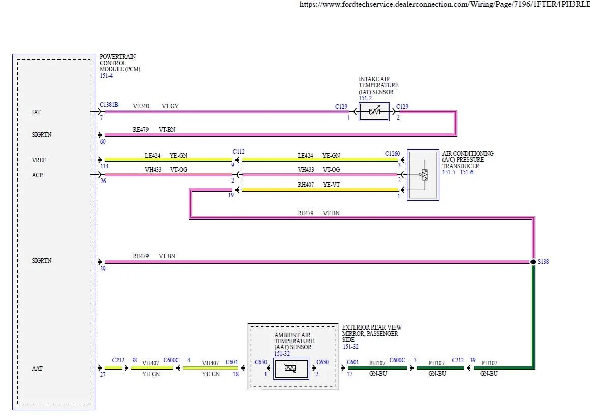

Thanks for that, Hootbro. I've seen a parts diagram that indicated it was in a mirror, but I assumed driver side.
Hootbro
Jun 5, 2024
435
432
Delaware
2024 Ranger STX 4X4
I think the F150 has it in the drivers side.
Seems the values can be re calibrated via the dealership FDRS scan tool.

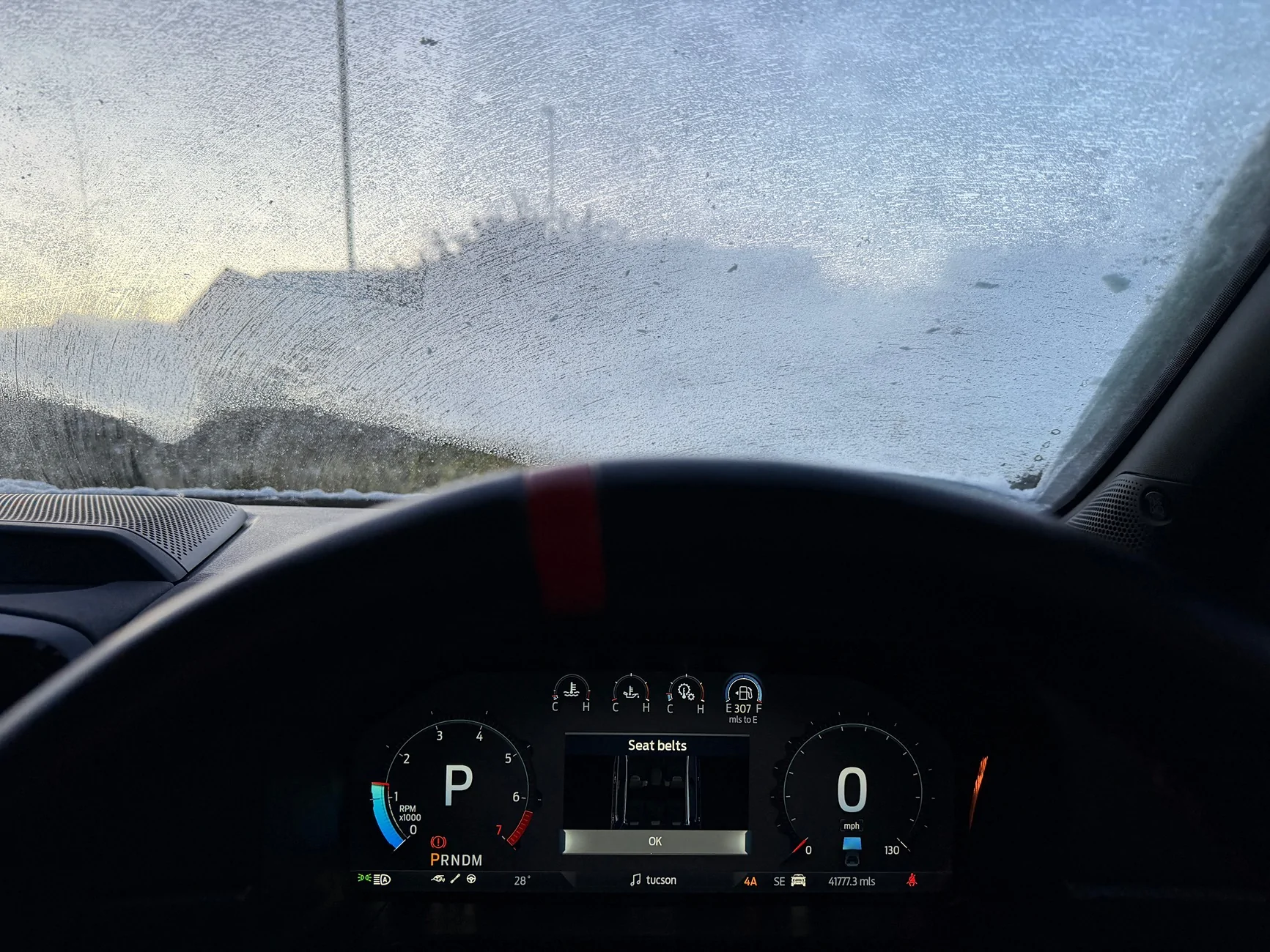

Anyone manage to find a fix through Forscan? Mines reading 28°C and it’s -3°C outside!
