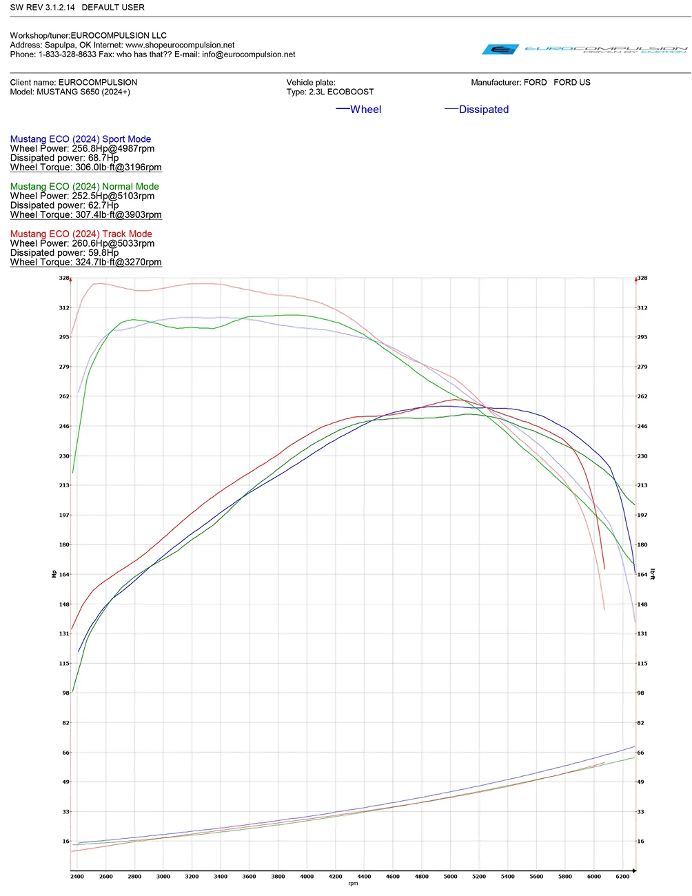

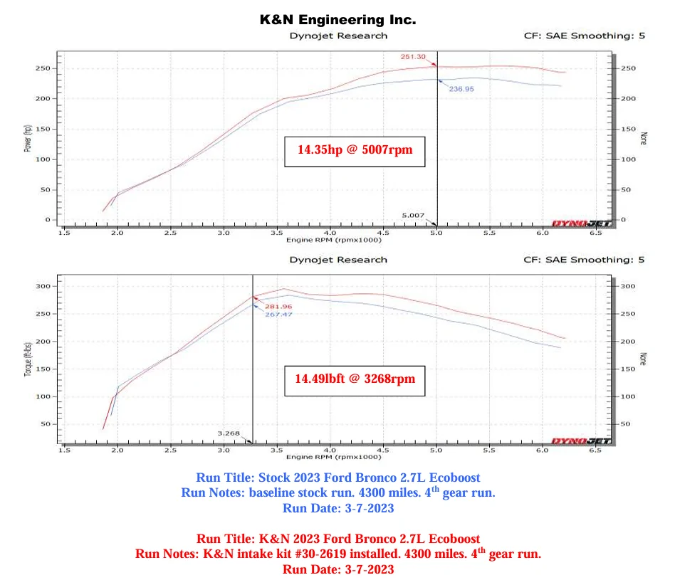

Hard to do apples to apples until someone dynos a new 2.3L and 2.7L but here's the 2.3L MPC Mustang vs. 2.7L gen 2 F-150. These are wheel horsepower. Now ignoring specific numbers, but focusing on the torque curves as you mentioned -
Ford Ranger RR 3.0 Wet Belt Driven Oil Pump - issues in future? 1768494862594-p4
Ford Ranger RR 3.0 Wet Belt Driven Oil Pump - issues in future? 1768494877036-lk
1. Ramp-Up Work (2,400 – 3,200 RPM)
By measuring the Total Work performed as the engines accelerate toward their peak, we can see how they actually feel on the road.
2.3L EcoBoost: Delivers a Delayed Surge. The power starts softer and rushes in quickly right before the peak.
2.7L EcoBoost: Delivers an Immediate Push. The power arrives instantly and builds steadily.
The Delta: Despite the 2.7L feeling "stronger" earlier in the rev range, it produces only ~8% more total driving force than the 2.3L during this acceleration phase. The 2.3L effectively catches up, delivering nearly the same amount of total energy to the wheels.
2. Peak RPM Synchronization
2.3L Peak: ~3,200 RPM
2.7L Peak: ~3,270 RPM
Conclusion: The engines are effectively synchronized. Both are tuned to deliver their maximum pulling power at the exact same engine speed.
3. High RPM Performance (>5,000 RPM)
2.3L EcoBoost: The power fades early. After the peak, the pulling force drops off steeply. By 5,800 RPM, it has lost nearly 40% of its strength (retaining ~62%), signaling the driver to shift gears.
2.7L EcoBoost: The power holds on. The pulling force fades very slowly. By 5,800 RPM, it still retains ~76% of its strength, allowing the driver to hold the gear longer without losing momentum.

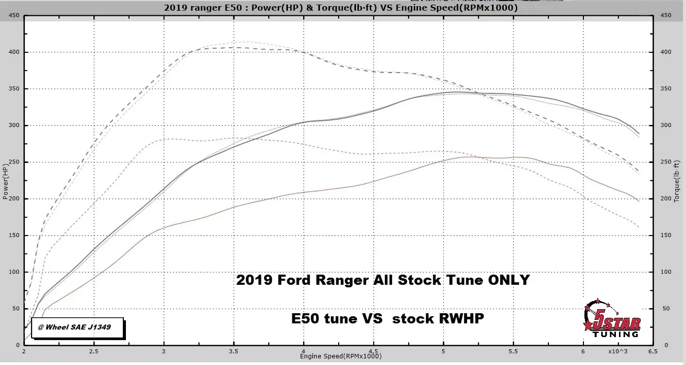

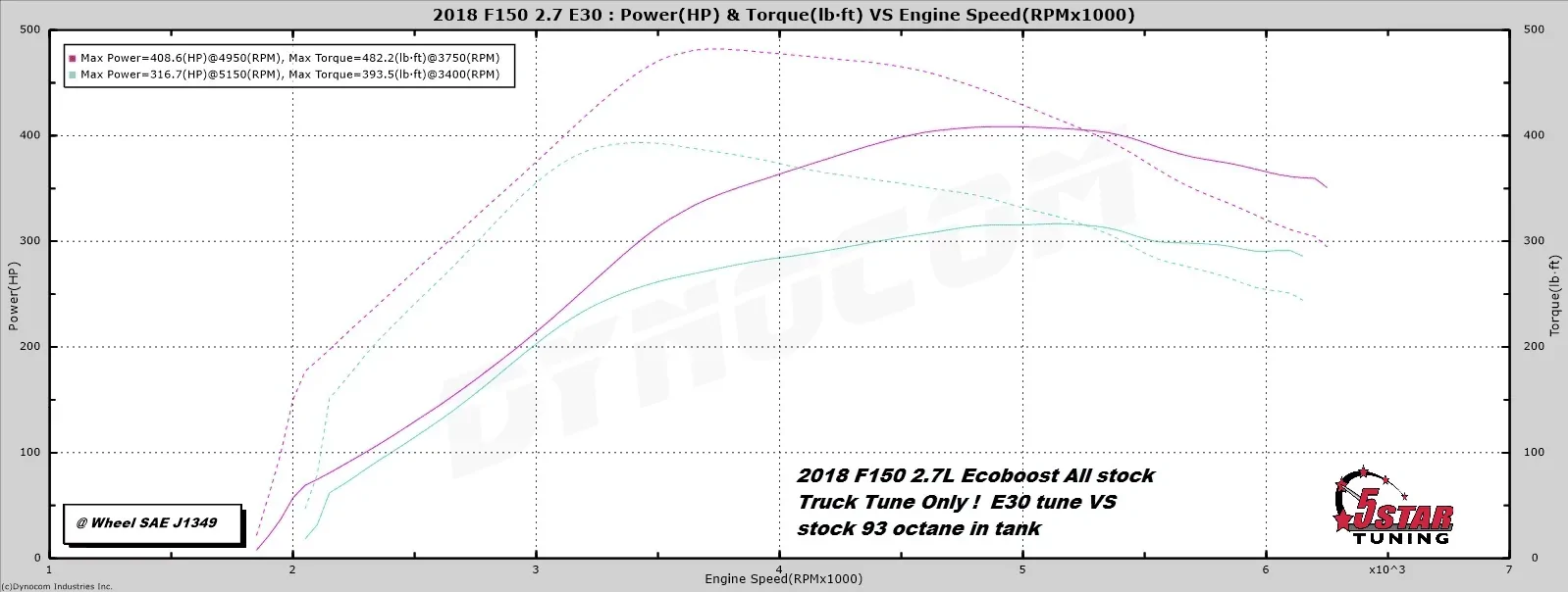

2.3L vs 2.7L power curves / dyno chart comparisons | Bronco6G - 2021+ Ford Bronco & Bronco Raptor Forum, News, Blog & Owners Community
19' Ranger 2.3L vs. 19 F-150, more comparable as it's truck vs. truck, 19 rangers also had the same 10R80 transmission as the F-150's because the 10R60 was still in development.
Look at the stock curves, the 2.7L is pushing 50 HP more at the wheels on it stock curve vs. the 2.3L AND over a lot more of the RPM range where the 2.3L is very peaky and then fades fast. Just look at the stock vs. stock curves.
Ford Ranger RR 3.0 Wet Belt Driven Oil Pump - issues in future? 1768504198968-o9
Ford Ranger RR 3.0 Wet Belt Driven Oil Pump - issues in future? 1768504221531-jj
Stock 2.3L is only pushing out 155hp @ 3k vs. the 200hp from the 2.7L at the same RPM. By 4k the 2.7L is netting about 280~290 WHP and the 2.3L is only at 210 WHP. That isn't nothing.
By ~5k the 2.3L hits about 250 WHP and the 2.7L is netting about 305 WHP. Again, 55 HP isn't nothing or small. And in the mid-range, it's 80~90 hp difference. Power is work being done, hence why if you were to hold a perfectly flat torque curve, power would be linear as RPM climbs.
Look at TFL's towing tests with 4 cylinders vs. the 2.7L V6 and then compare that to the 3.0L V6 and then the 3.0L V6 with a Pro Cal. I have no issue with the 2.3L EB, it's a great little engine, I had that engine in my 2015 Mustang Ecoboost, then upgraded to a 2016 GT PP 5.0L and then Stage 2 Power Pack on the 5.0.
The 2.3L could not even come close to a stock 5.0L, let alone one with a stage 2 power pack, which ironically also made 455 HP like my Pro Cal tuned Raptor. The 2.7L V6 is a legitimate upgrade for towing performance.

The powertrain on the Mustang is completely different than on the bronco. Tire size, weight, wheel weight, final drive ratios etc. As stated, you would have to look at two trucks just with different engines to make it comparable and on the same day.
I’m not sure where the disconnect is, so I will try to be precise. You previously made the specific point: "It's not just peak numbers. People forget about AREA UNDER THE CURVE."
As noted above the two engines are in different vehicles, therefore you can ignore absolute numbers. However, none of these things: "[t]ire size, weight, wheel weight, final drive ratios" would change what a torque and hp curve would look like.
So with that in mind I'm not sure how having "two trucks just with different engines and on the same day" would offer any more information on your point about the area under the curve and not just peak numbers.

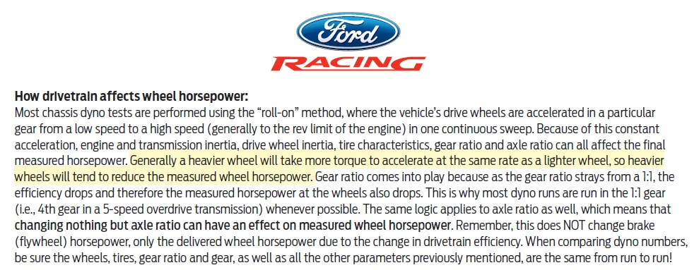

Does Wheel Weight Really Matter? 7 Shocking Facts for 2025
And straight from Ford Performance:
Ford Ranger RR 3.0 Wet Belt Driven Oil Pump - issues in future? 1768505509760-d
Those factors ABSOLUTELY affect final WHP numbers! Ask any tuner, performance shop or hot rod builder. The effective WHP is a combination of the power at the crank - all parasitic losses. If you want to directly compare engine outputs, an engine dyno would be best, but that's not practical unless you're an engine builder or OE mfg. doing dev. work.
BTW, I attached the document from FP for anyone interested, it's a great read. The link provided also gives some additional info. The next best thing to an engine dyno is similar vehicles with similar powertrains, tires sizes and weights on the same dyno on the same day (or at least same dyno and different days with SAE corrections), but we're getting off topic here.

@Lion77 that wheel weight article is a total distraction and completely out of context. You were the one who brought up "Area Under the Curve," yet now that we are actually looking at those curves, you’re pivoting to drivetrain losses to try and dismiss the data.
Here is the issue with your logic:
Drivetrain losses and wheel weights change the final numbers on the dyno (WHP), but they do not change the characteristics of how the engine produces power. A heavier wheel might lower the whole curve on the graph, but it doesn't shift where the peak torque happens and it doesn't make the 2.3L fall off early at 5,000 RPM. Those are engine behaviors dictated by displacement and turbo sizing.
You said the 2.7L had a "1,500 to 2,000 RPM" advantage in its powerband. The charts show that isn't the case. Instead of addressing the actual shape of the power delivery (the AUC you asked for), you're now claiming the charts are invalid because of wheel weight. If we followed your logic, we could never compare the characteristics of any two engines unless they were on the exact same tires and wheels.
As noted in the article you quoted, "measured horsepower" drops as the gear ratio strays from 1:1 or as wheel weight increases. This is a consistent loss across the sweep. It does not rewrite the engine’s power profile. The 2.3L loses steam at high RPMs because of backpressure and turbo limits, not because of what rims are on the truck.
You can't call for a discussion about the Area Under the Curve and then try to disqualify the data with a "wheel weight" diversion once it's proven the delivery curves aren't as different as you claimed. You're moving the goalposts and trying to frame my reply as off-topic because the technical data doesn't match your original point.

Doesn't change the shape, it changes the magnitude across the range, so the entire curve will read higher or lower depending on the vehicle its in. Think of it like an offset due to parasitic losses.

You are trying to compare a 2.3L in a Mustang to a 2.7L in a Bronco and then say the 2.3L outputd only 8% less power which is not true. Truck vs. Truck like I provided, its 29% at 3k RPM, 33% at 4k RPM and 33% at 5k RPM. Truck vs. Truck, two engines, same dyno, same 10R80 transmission, similar tire / wheel sizes etc. Yah, there's a difference and its not miniscule like you claim.
