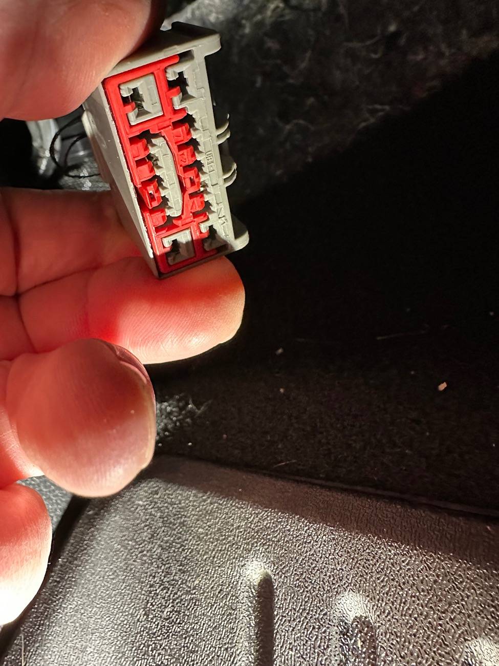

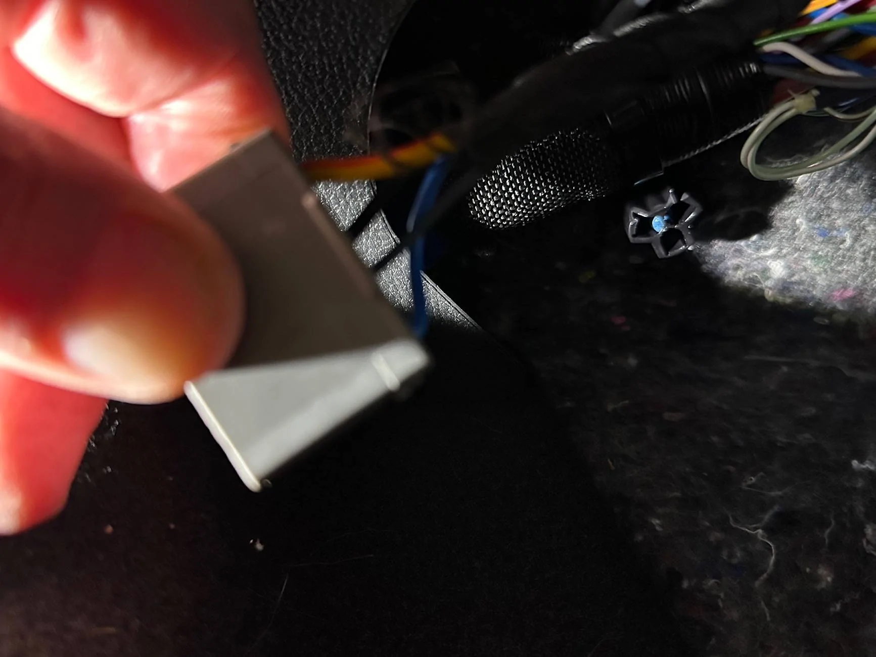

To further muddy the waters on my ‘24 Ranger XLT; I removed the cover on the connector I found behind the left kick panel, and was able to get a closer look at the 4 wires going into it: yellow/red tracer, blue, violet, and black. The 4-pin connector under the rear bumper wires though are green, yellow, brown, & white. From the Fuse Diagram, there is a fuse in position “F91” that is labeled for the “Tow Control Module”.

This doesn't muddy anything. Read the thread. That Connector is for a plug in TBC. The 4 wires are 12V power, Grnd, Brake On/Off signal, and Trailer Brakes out- variable. The only one that leaves from that connector to the back is the Trailer brakes out. I verified this in this very thread.

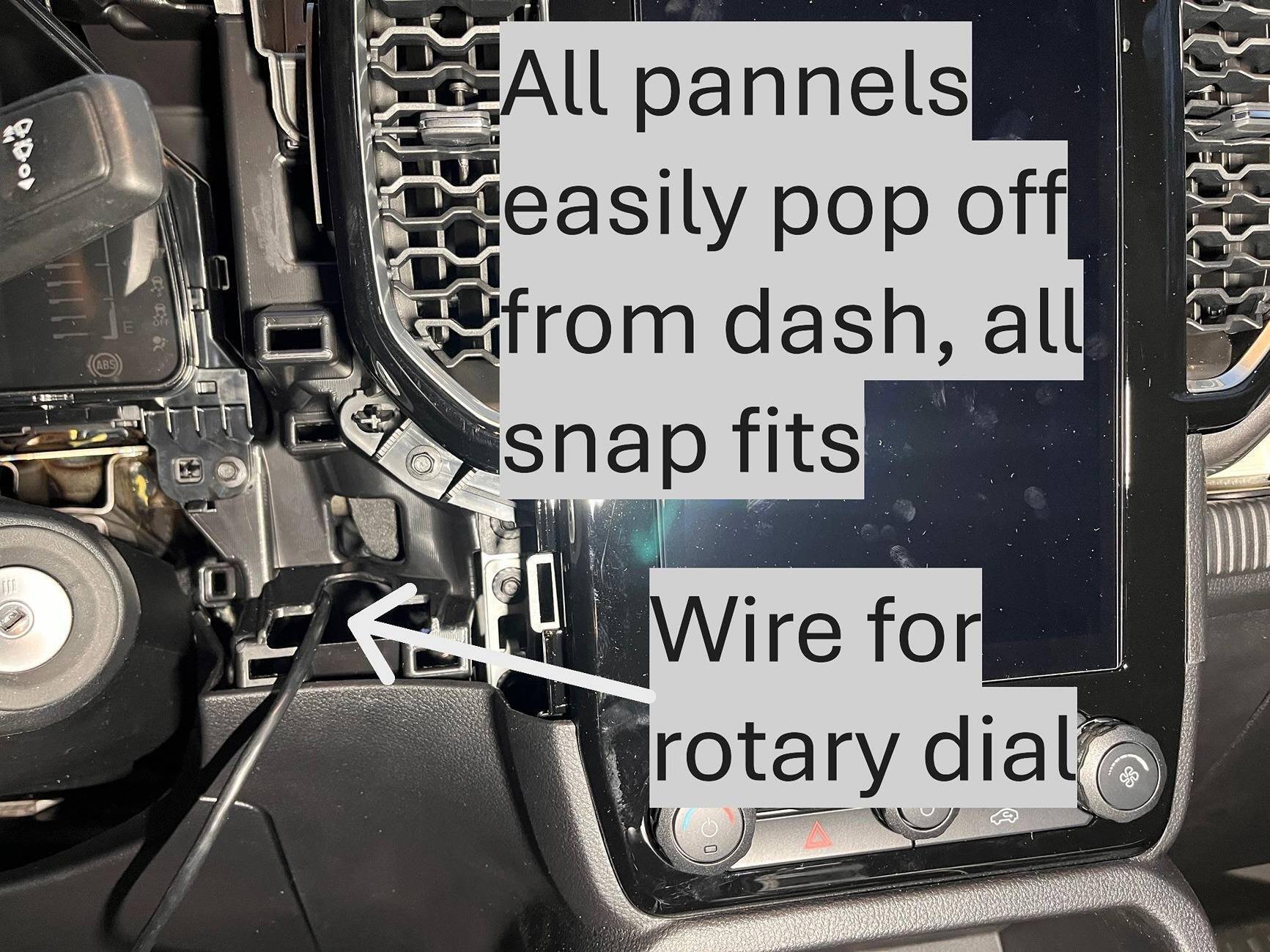

In addition I removed the instrument panel bezel and didn't find a connector for a trailer brake controller switch in the location where it would be installed by the factory.
In the image below, the wire shown is for my Redarc TBC in the factory location.

  • My "non-tow-package" Ranger has the under-dash connector as explained chino101 and others.
  • The brake controller and harness I purchased connected to the under-dash connector without an issue.
  • With no trailer connected, pressing the manual override brake button on controller activated all brake lights. (That's a small win my opinion!)
