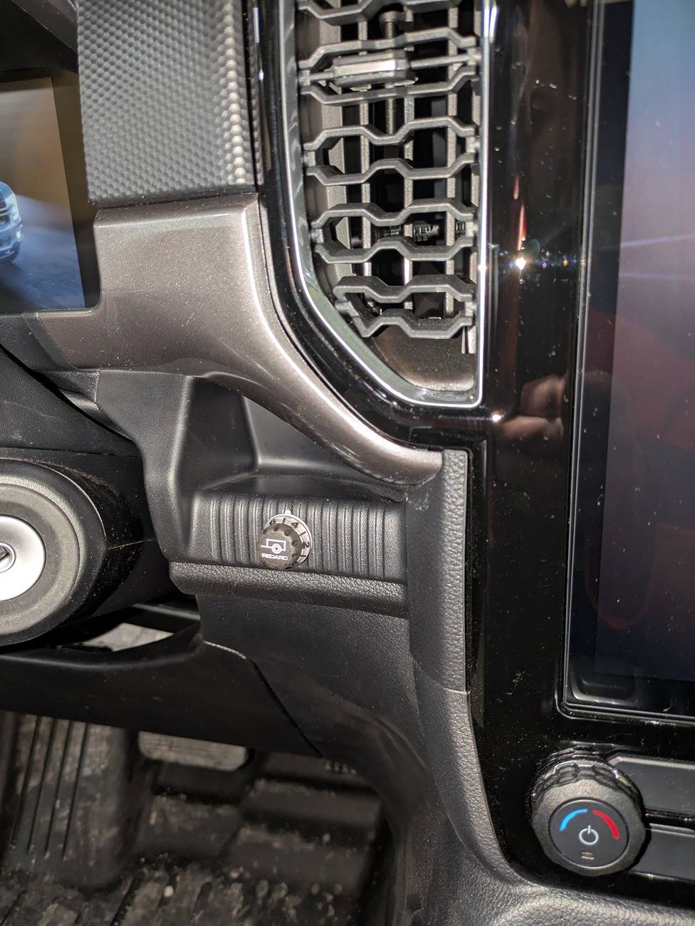

-The wood block I used was approx 2.5"x3.25"x.75". I used two 1/4" by 1-1/4" carriage bolts (countersunk) for mounting (if I was doing it again, I'd look for elevator bolts). Suggest mounting as far forward as possible to maintain clearance for the lower steering column trim when it's in a fully inward and lowered position.
Nice! Thanks for sharing this. The wood block you used is much more elegant than the zip ties I used. I haven't yet mounted the dial - something just makes me hesitate before drilling into any part of the truck.... :)

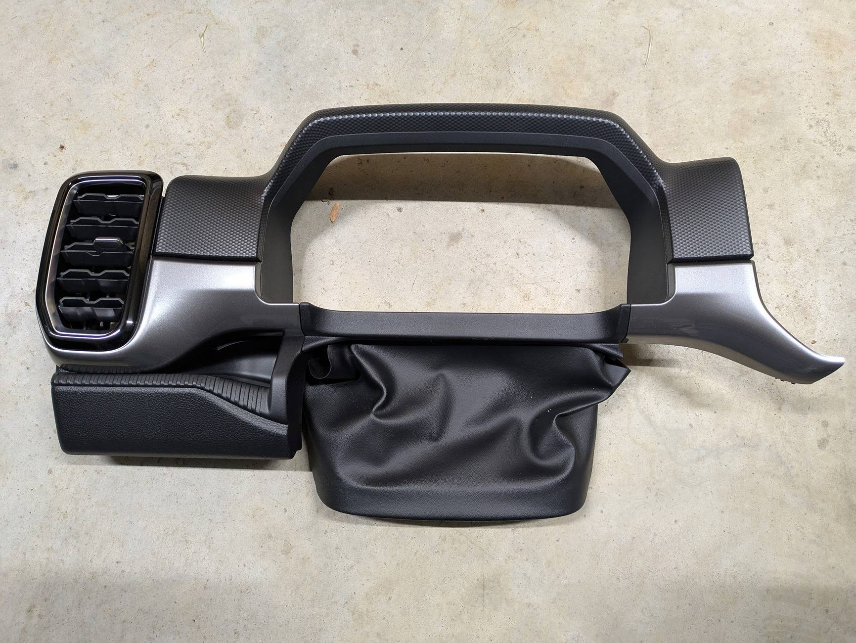

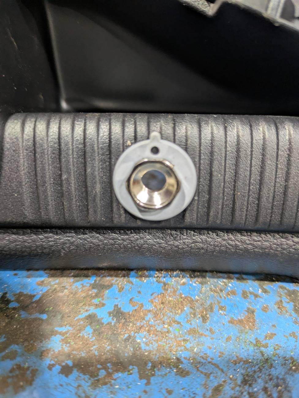

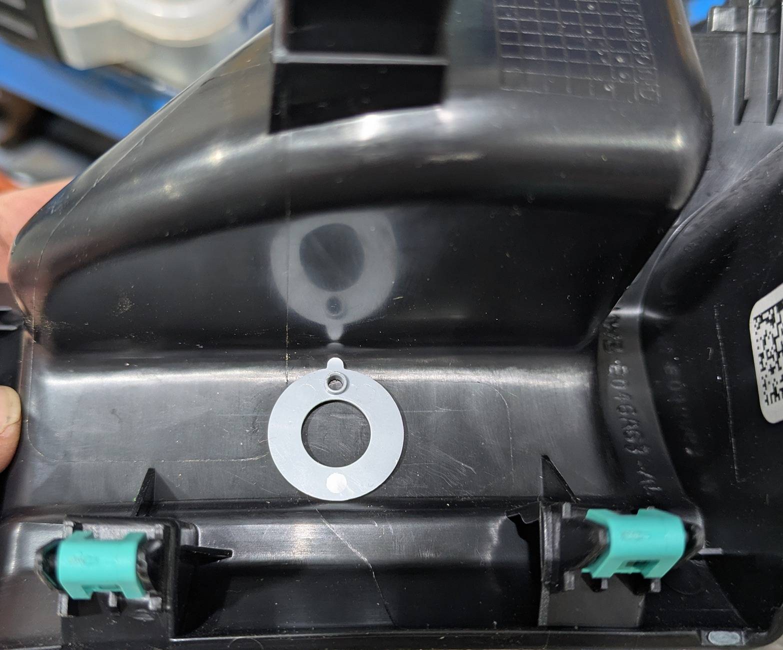

Major thanks to all the contributors to this thread and the write-up. I also installed the Redarc kit from eTrailer.
Sharing a few tips/details I learned along the way:
-When you remove the dash bezel, the pliable material that covers the top of steering column comes off with it (snaps to the steering column).
-The trailer connector can be hard to see as it may be tucked behind the main harness.
-It's tricky to find a good location for the Redarc box as it needs to be rigidly mounted. I concur the location and method chino101 mentioned as pretty much ideal.
-I found it helpful to use the bezel for the Redarc knob as a locating template for drilling the large and small holes.
Overall, it appears to work and I plan to test it with a trailer this weekend. Really like the clean, simple and functional look once installed.

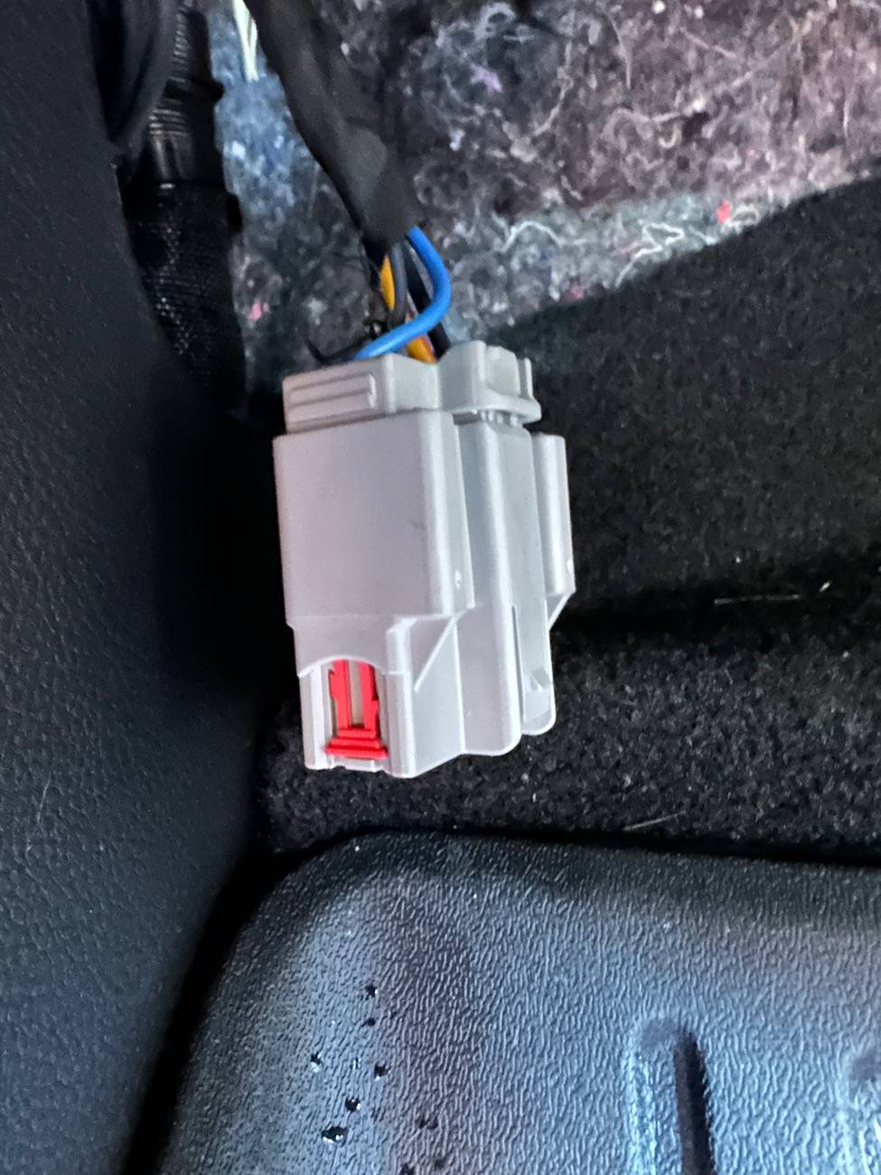

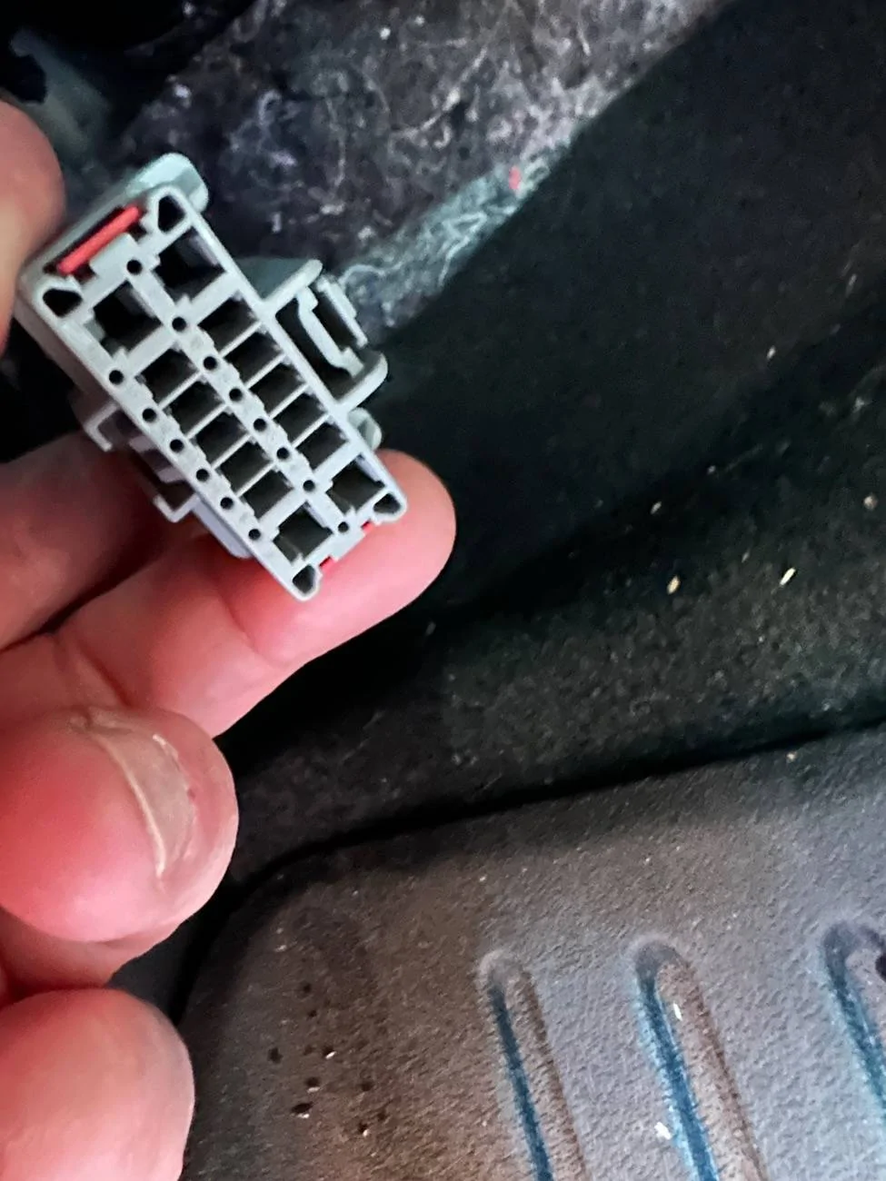

I found this connector behind the left kickpanel on my ‘24 XLT (FX4 package). I am in the same situation about installing a trailer brake controller.
As you can tell, there is a cover over the actual connector. Push down in the tab near the wires and remove it, then the remaining connector should fit into the plug on the custom harness.
Did your truck come with the basic tow package with the receiver and 7-pin?
Edit: That's a good photo of what to look for. I assume that if I have a connector near the bumper with wires those colors, I should be able to add a 7-pin and TBC. (FYI, I didn't get any tow package, silly me.)

Looks like then just 4 wires, then to the 4 -pin connector (factory installed) under the rear bumper? What installing an aftermarket Trailer Br
Per the invoice and a follow up with Ford Customer Service, no trailering package installed on my 2024 XLT. However, I had the service department at the local Ford dealership look up the build of my vehicle on the OASIS system ,and was told it has “Towing Package 1A” from the factory. However, just the 4pin connector (lights only), no hitch receiver.
