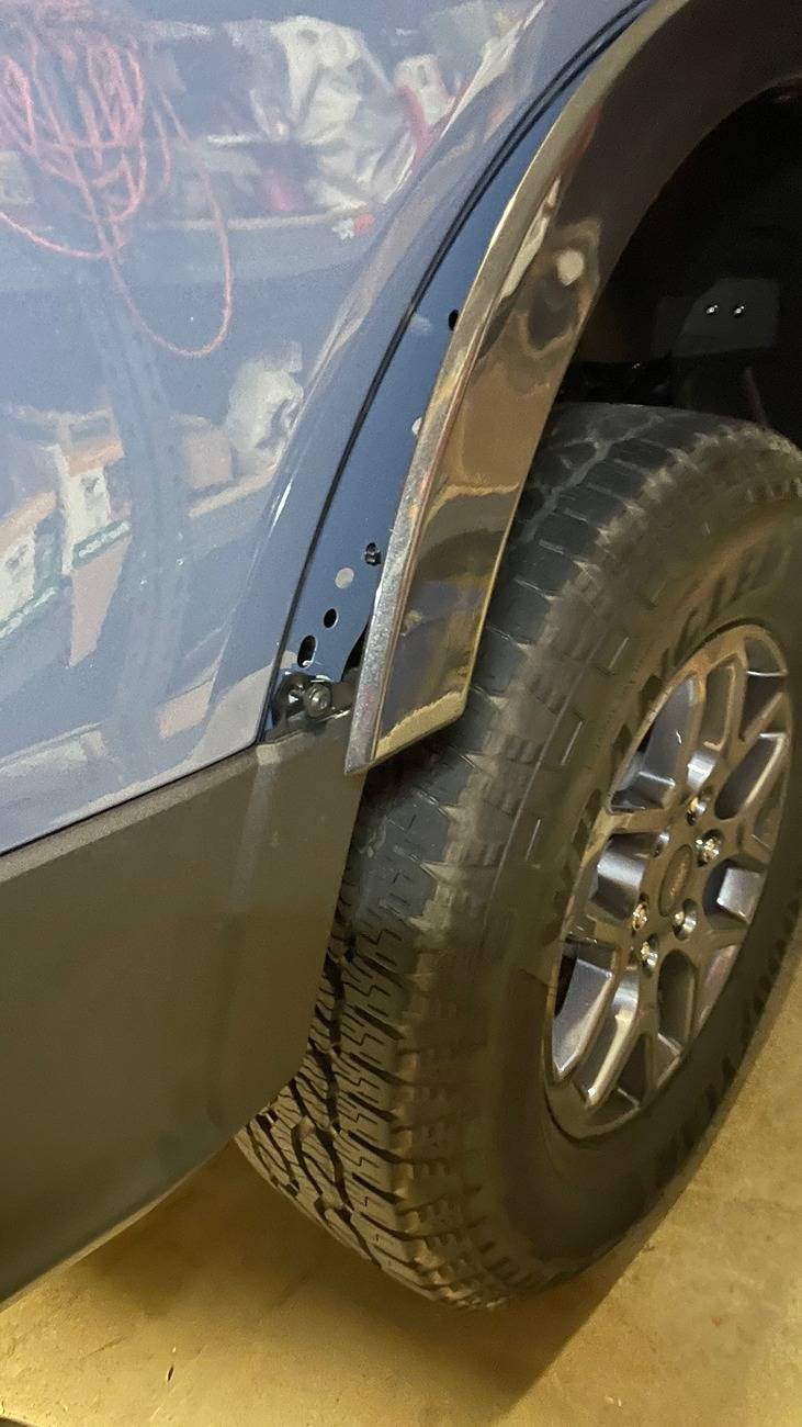

It's mostly tabs though there are a few screws. One of which is hidden behind the fender flare and is hard to access. I was unable to get the fender flares off without about breaking several of the tab attachments on the flares themselves.
Sounds like a pain. There's a couple of Youtube vids mainly of front flares being removed. All say your gonna break clips but are availble from ford. Just white plastic clips. i'll get a few. I have all the parts coming for a Rt side install thanks to your table! But can't find the front Support bracket on line. Gotta go into the dealer to get it?

To install the J-braces, you have to partially remove the flares. The instructions have a trick for removing the clips. If you push an 8mm socket over them from behind, they will pull out easily. My kit came with a few extra, but I didn't need any of them.

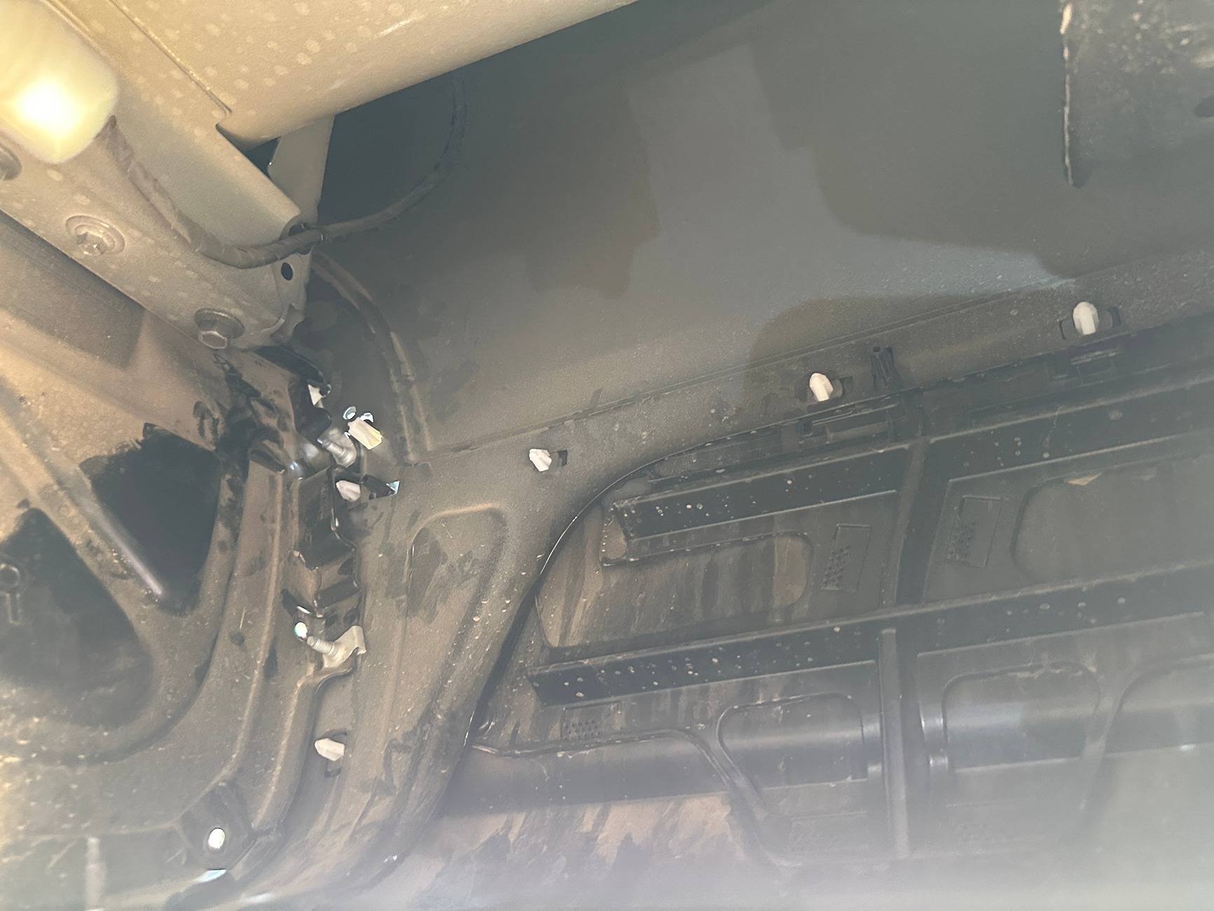

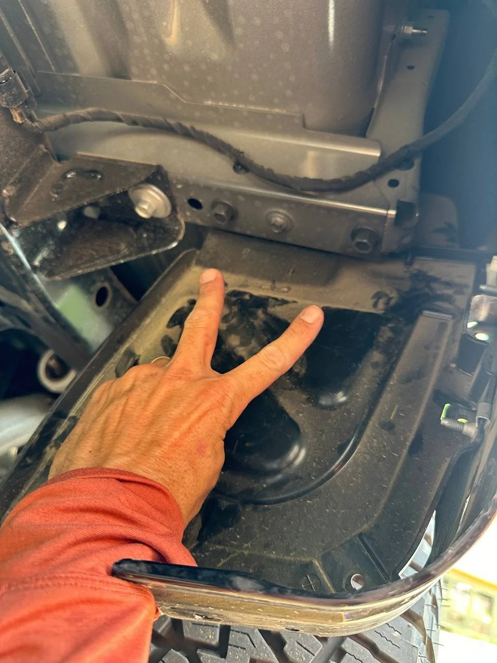

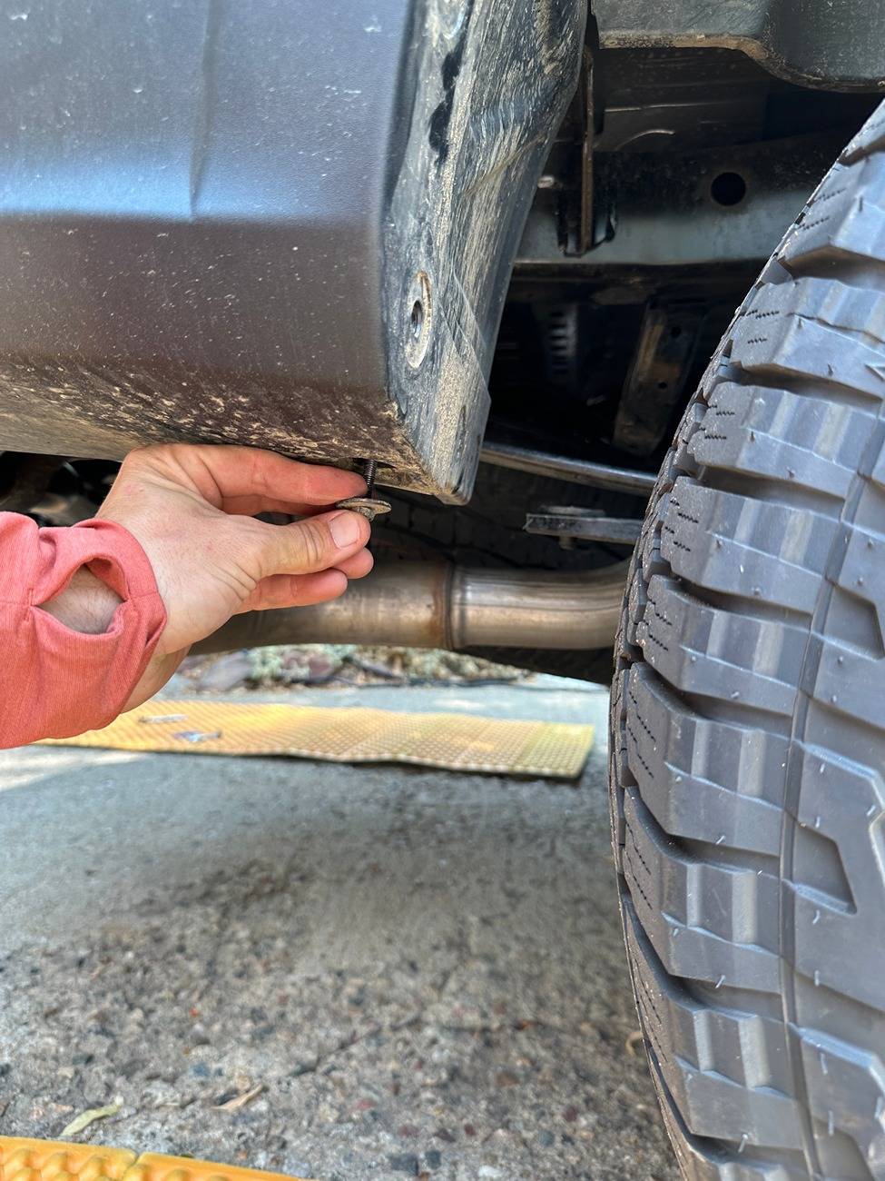

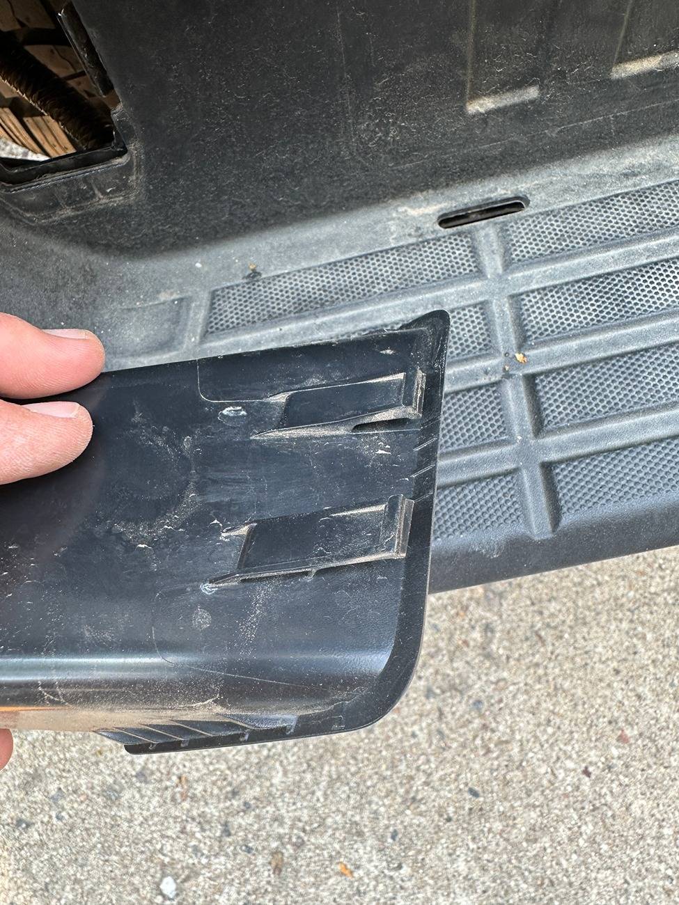

So, completed the install on the Passengers side. Took about 2 -2 1/2 hours. Better and worse than i thought. first, you only need HB-1 and HB-2 bolts. No other hardware, it's either on the new part, like the white clips, or can be reused. Couple tricky parts, 1. First remove the inner wheel well lip retainer black push-pins 1/2 way up and across the bottom. There is also a T20 torx on the inner lip. Next, Use the 8mm socket to remove the white clips from the inside of the lip, you just need to remove the first 3, this will allow the lip to move enough to remove the other T20 Torx just under the lip/flare end. See pics.. There are 3 bolts holding the lower cover on, in addition to all the white clips, i got them all with the 8mm except there's one sort of enclosed where i had to use 2 long flat tips. Everything pulls out clean, but you can't remove it. The bumper is in the way. I also have the Tow hitch from the factory, instead of removing the entire bumper, loosen the bolts on the opposite side, then place a jack with some wood to reach under the side your working on, and take out the 3 bolts on your side. that will give you plenty of room the remove the panel. Make sure you make fore/aft, and side to side alignment marks on the bumper / tow hitch brackets before you loosen it. Now last trick, there's a locator pin on the top of the support bracket that will not go up because of a riveted plastic panel. I cut mine down to about 1/4", not needed anyway, and deburred it and slid it up there. Put the bracket in the front locator slot first. All in all, looks great! No damage and works well. I torqued the hitch bolts, 3 each side, big mothers- to 148ft'lbs. that was the previous Gen 5 spec. i am pretty sure they were under torqued from the factory, but not sure. Use blue Loctite. Thanks to tpack424 for posting this. I am now a happy camper.
Ford Ranger Adding Options at Dealership After Delivery IMG_2147
Ford Ranger Adding Options at Dealership After Delivery IMG_2146
Ford Ranger Adding Options at Dealership After Delivery IMG_2149

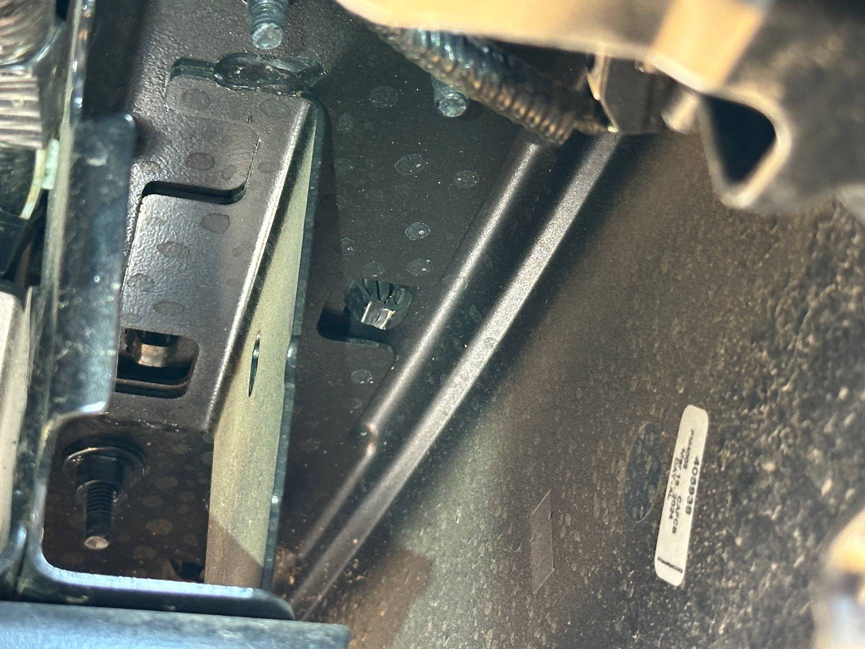

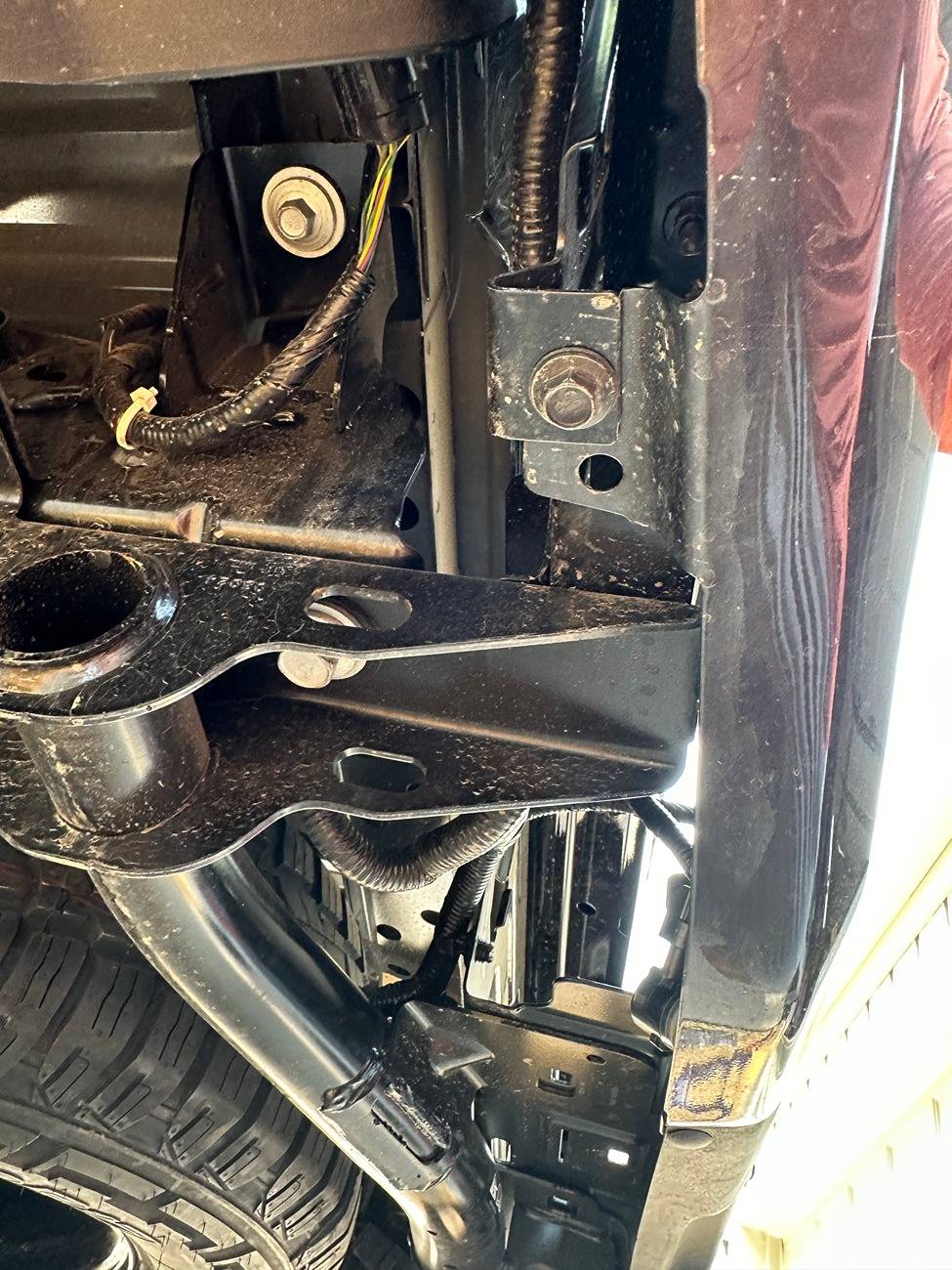

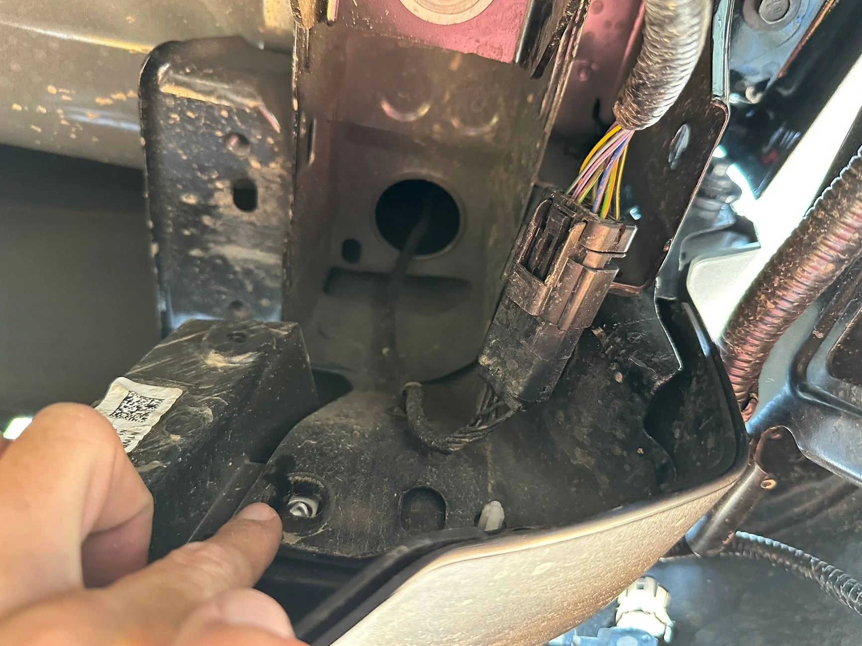

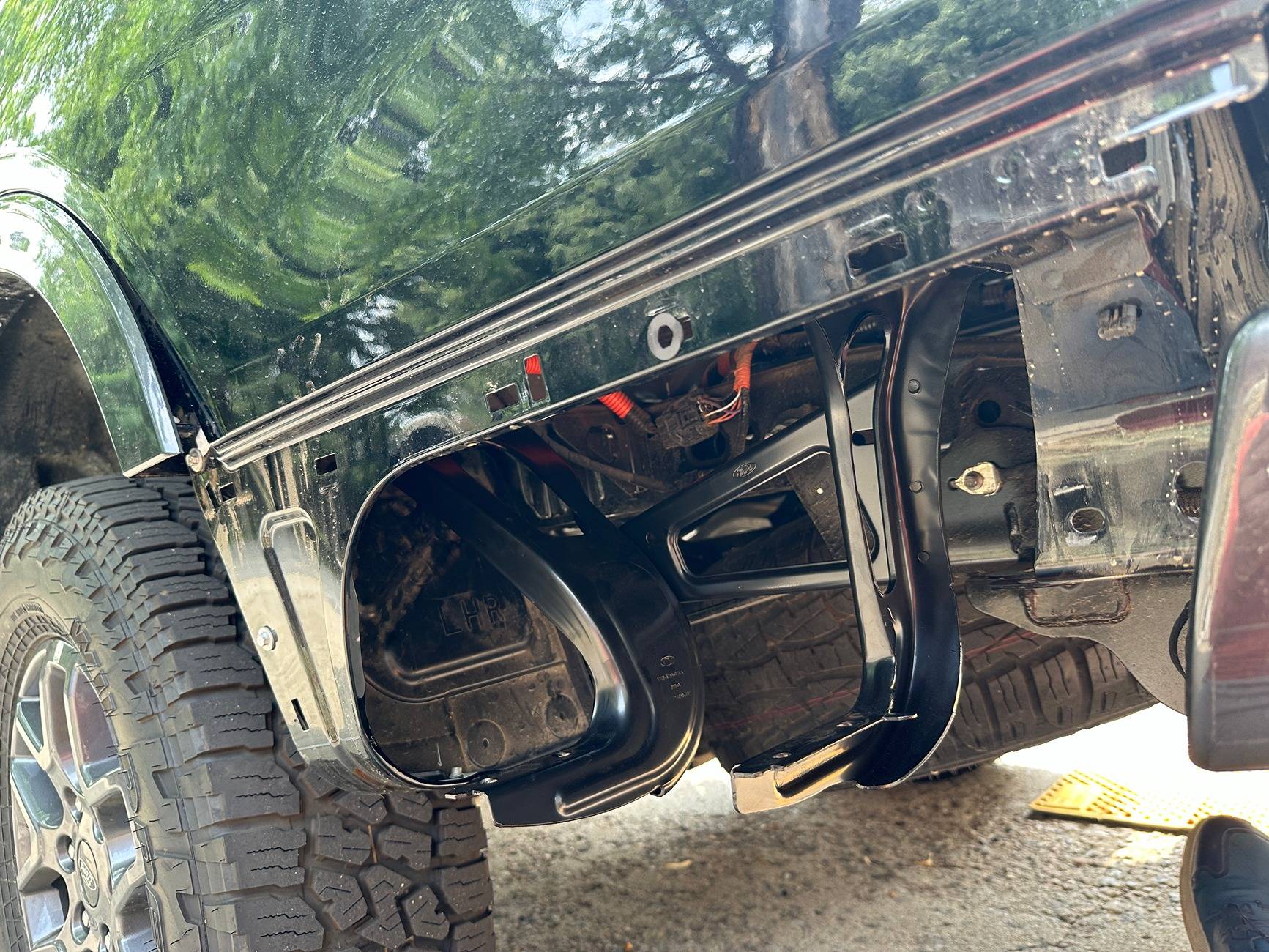

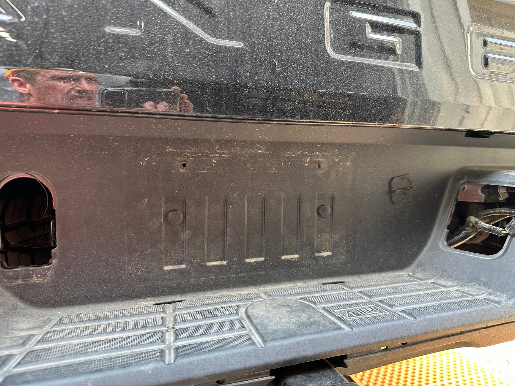

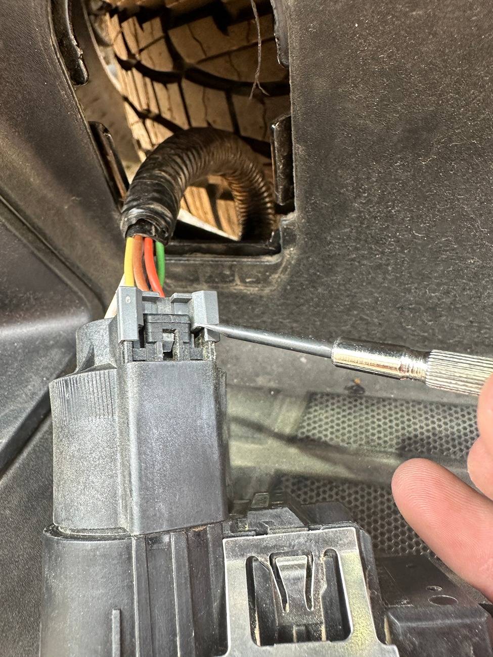

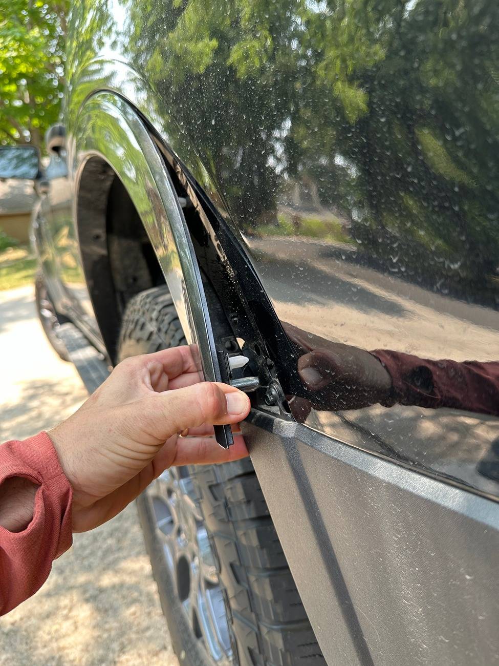

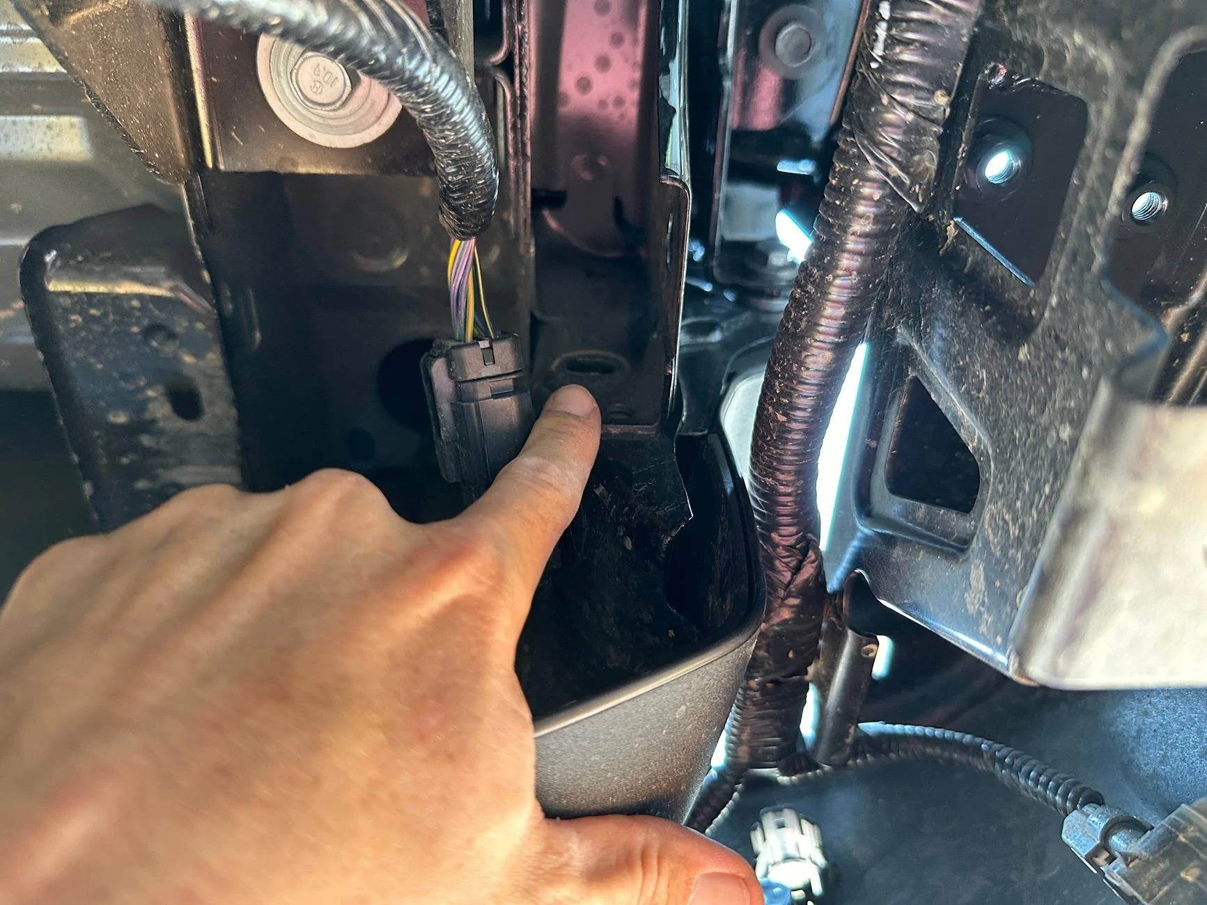

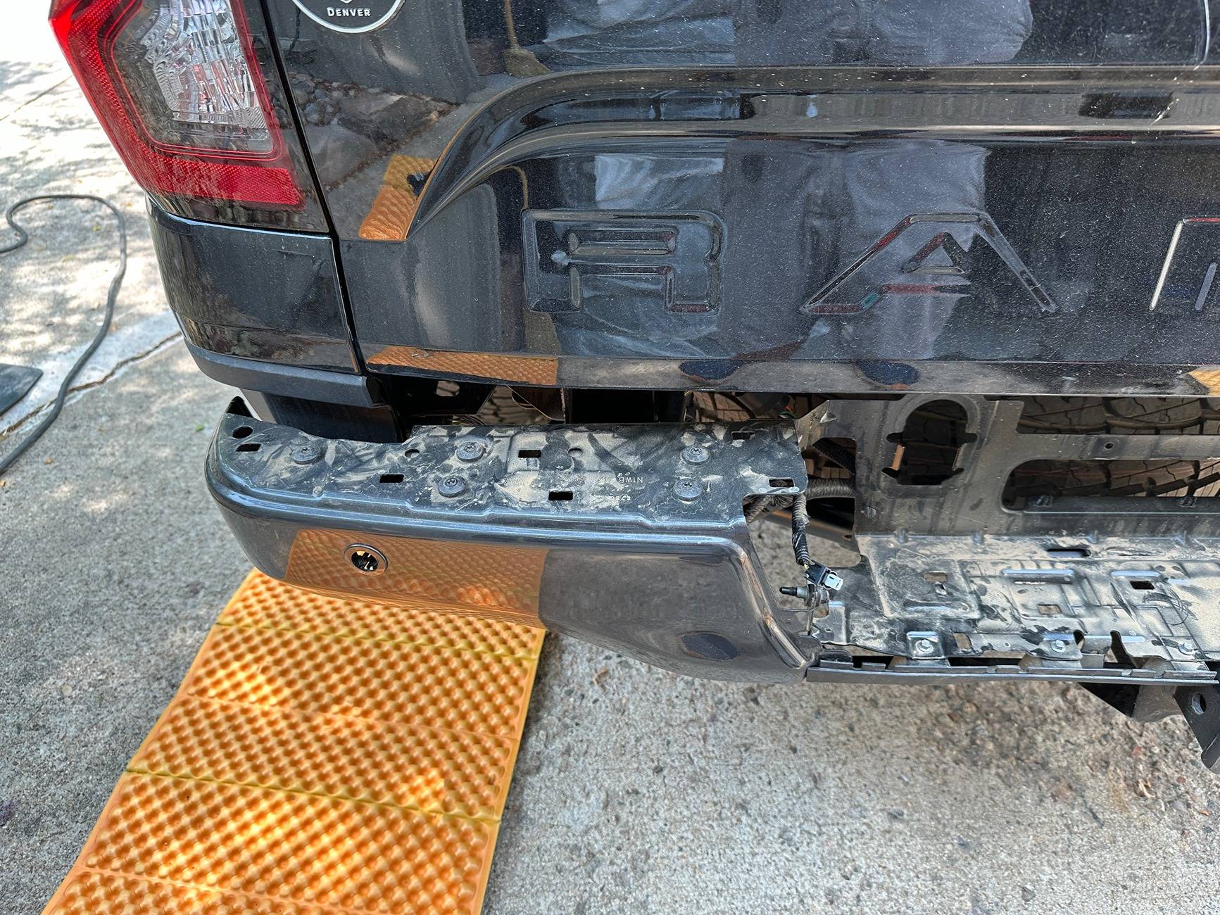

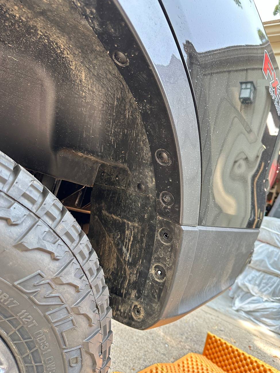

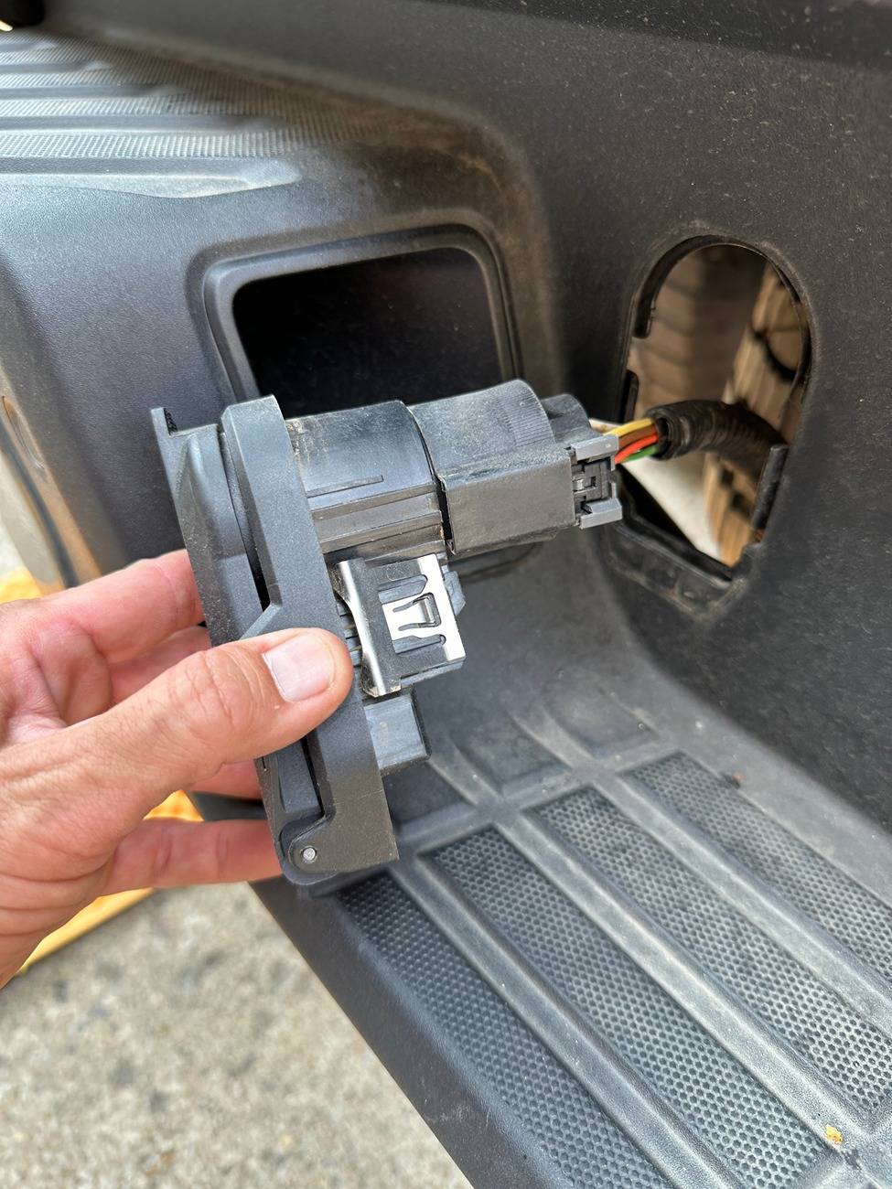

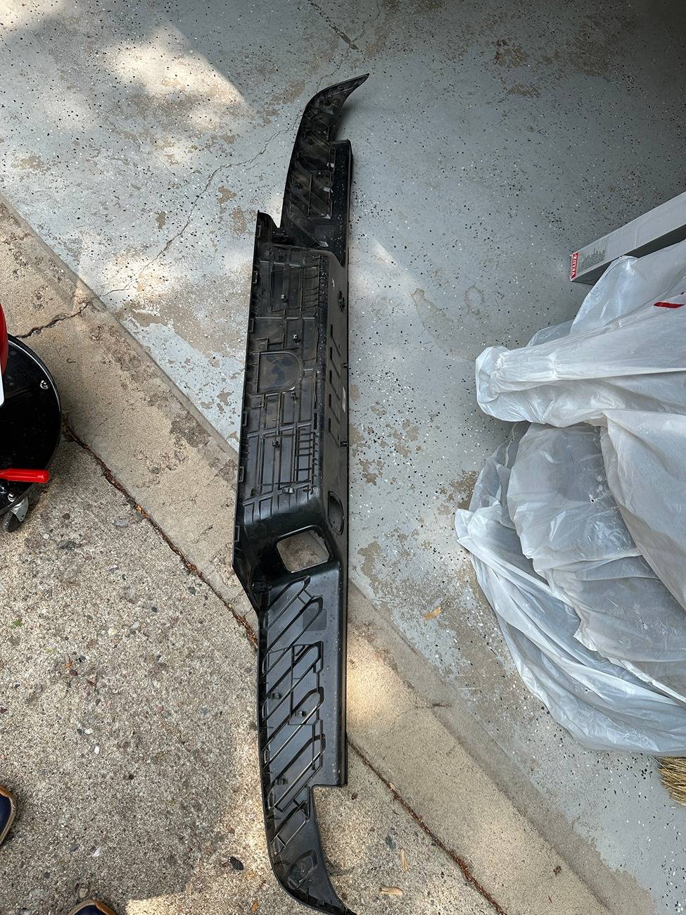

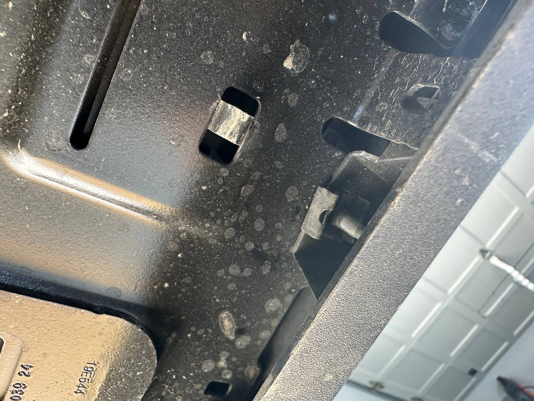

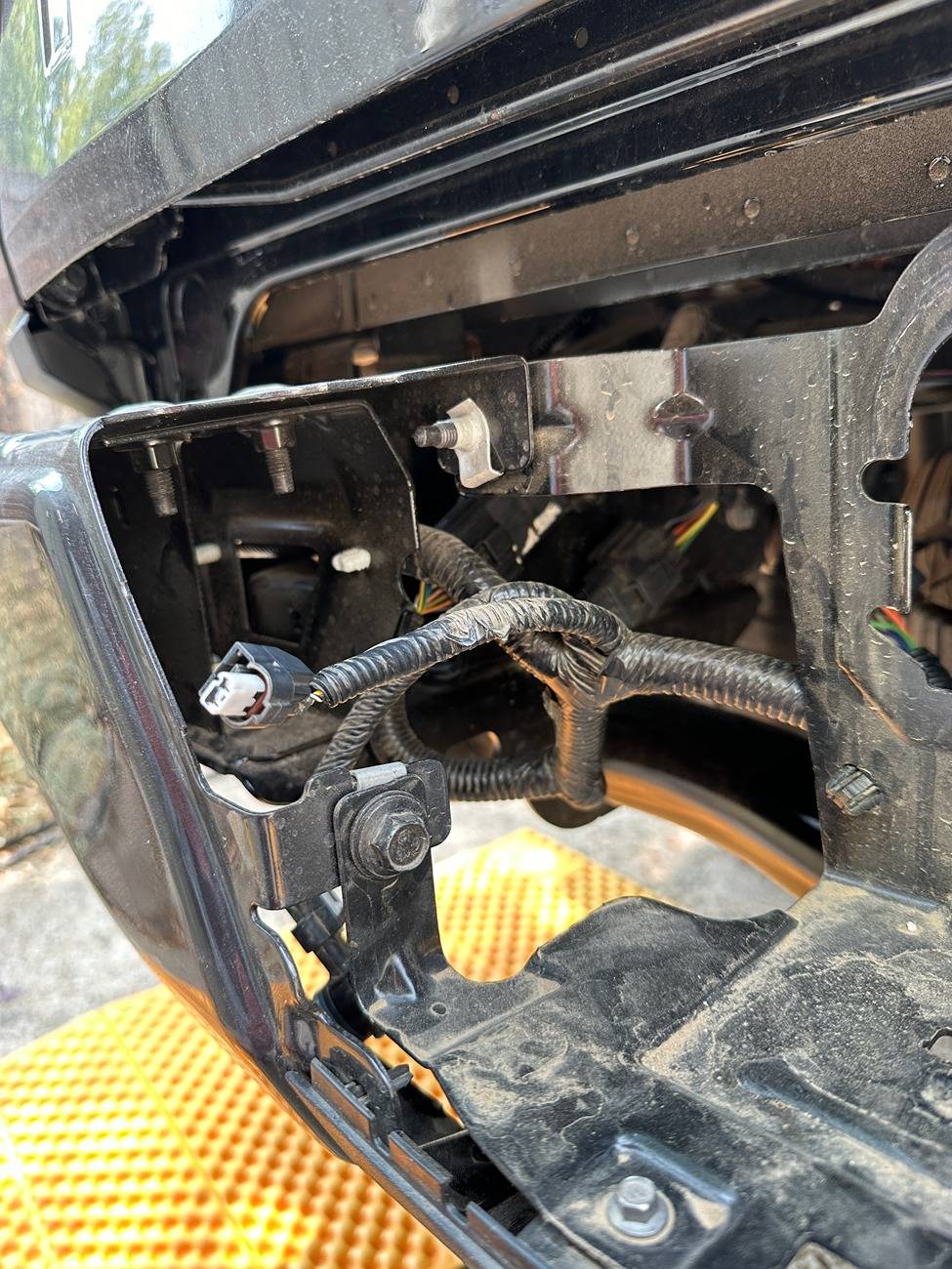

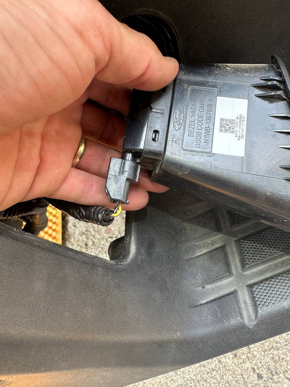

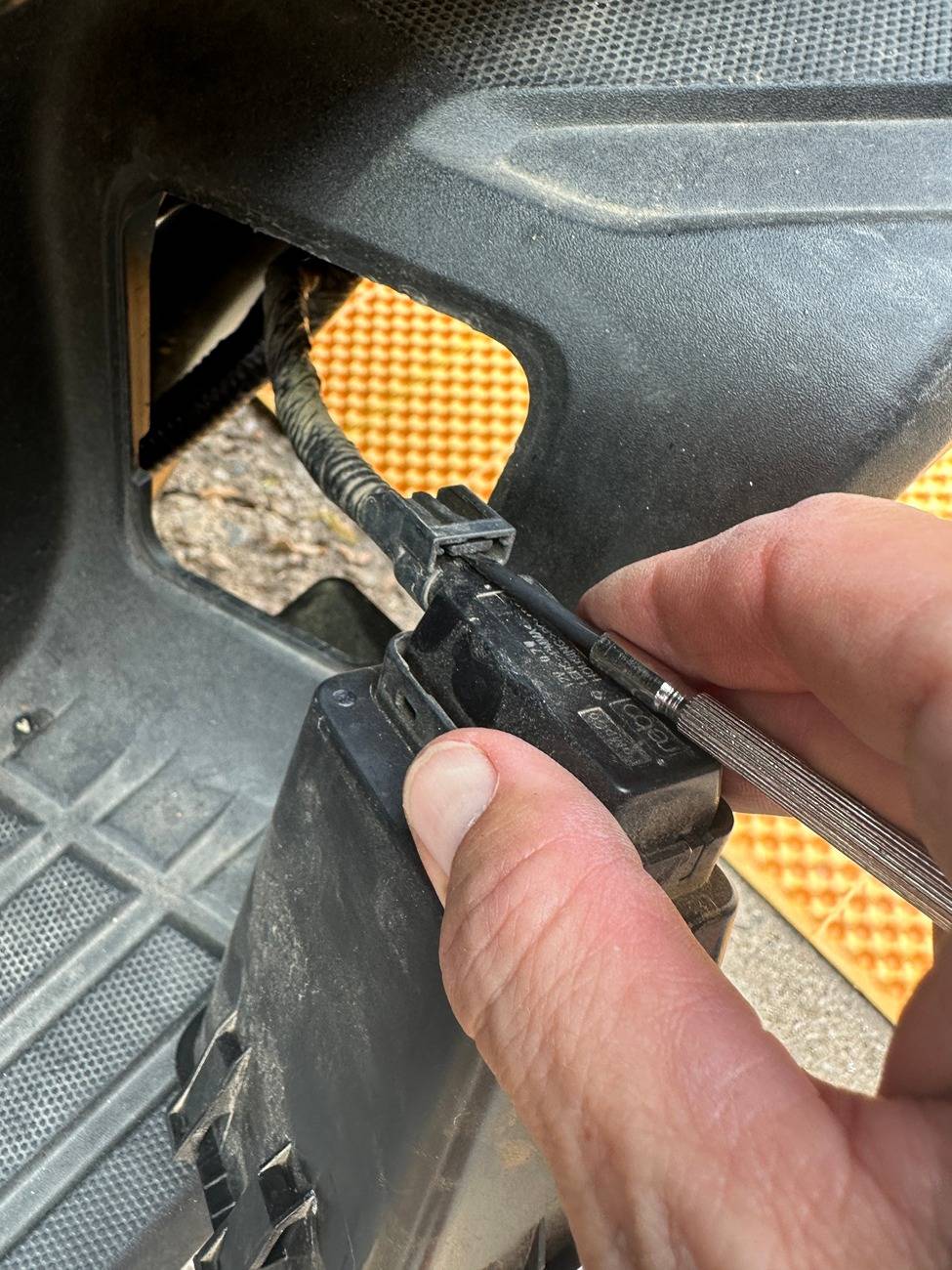

Here's are the installation steps. I did for both sides. The order sheet is listed in an earlier post. All in about $550/side. Pictures below of most steps as well.
Took me 4 hours to do both sides, but a lot of that was figuring out what to do. I would estimate 2-3 hours to replace both sides with the directions below.
  • Remove mudflaps (if installed)
  • Partially remove fender cover
    • Remove scrivets from fender cover
    • Remove torx screw from rear of fender cover
    • Remove two rear-most fender cover clips
      • This is sufficient to give access to hidden torx screw behind the fender cover which holds the side panel in place.
      • Use 8mm socket on interior to release clips
  • Remove hidden torx screw (under the fender cover at the rear bottom)
    • This is necessary to remove the plastic side panel where the step will go
  • Remove bumper cover
    • Remove license plate
    • Remove tow hitch connector
      • Release clip on interior side
      • Release front of connector from back by removing gray piece holding clip in place. Pull apart
    • Remove license plate lights x2
      • Two clips on interior, push to pull sensor outside
      • Then push clip to separate light from cable
    • Remove Parking sensors x6
      • Push clips on interior, then push parking sensor from exterior to interior
    • Remove rubber bumper cover
      • Two push rivets behind license plate
      • Tabs holding the rest of it down
  • Remove right and left bumper sides
    • 13mm socket for three bolts (per side)
    • T-40 needed for 5 bolts (per side)
    • No need to remove the hitch or center bumper
  • Remove plastic side panels
    • Remove 3 10mm bolts
      • 1 underneath on front side
      • 2 at back hidden on interior
    • Release 7 white clips and pull panel away
    • Remove two 15mm bolts at front
  • Install metal step support bracket
    • Trim round locator pin on the top of each support bracket to 1/4”. Debur.
    • Insert bracket starting with the round locator pin first
    • Secure with 4 15mm bolts (use loctite). Estimated 50 lb ft of torque
  • Insert new side panel cover
    • Click white tabs in place
    • Insert and tighten the 3 10mm bolts
    • Replace the torx 25 screw hidden under the fender cover
  • Replace fender cover
    • Replace all scrivets
    • Replace torx 25 screw
  • Replace mud flaps (if installed)
  • Replace bumper
  • Replace bumper cover
  • Replace license plate lights, trailer hitch and license plate

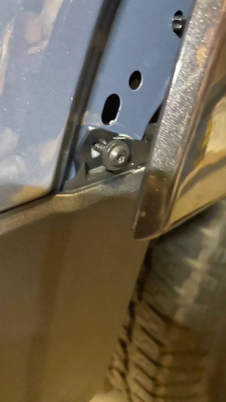

Nice write up!
You know, it's not critical. I used my calibrated bicep. I'd say I'm around 40. 100- YIKES! That's into sheet metal. Had to be a pain to get out.
Let me also say, you don't have to remove or even disassemble that bumper. You just need to loosen the far side and remove and support the side your working on, You don't need much to get the body panel out. Just my opinion, i did it that way, Save alot of work. thank you for creating this thread, and sourcing the parts!

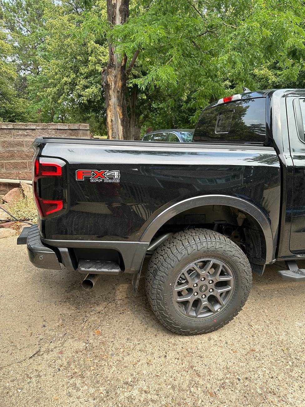

Was it worth it? Looking at some in-stock trucks and they don't have the side step. Not sure why the dealers aren't ordering them with this option. Seems like an inexpensive upgrade if you get it from the factory.

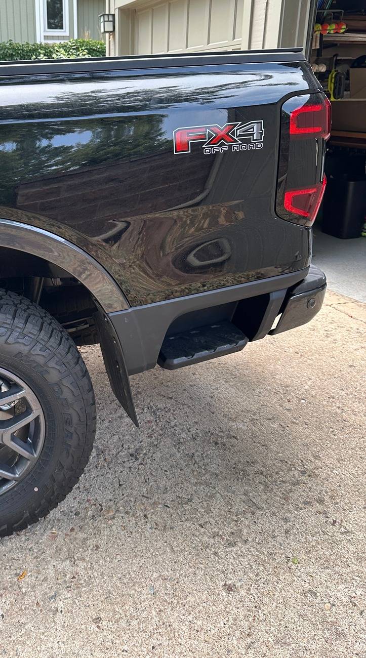

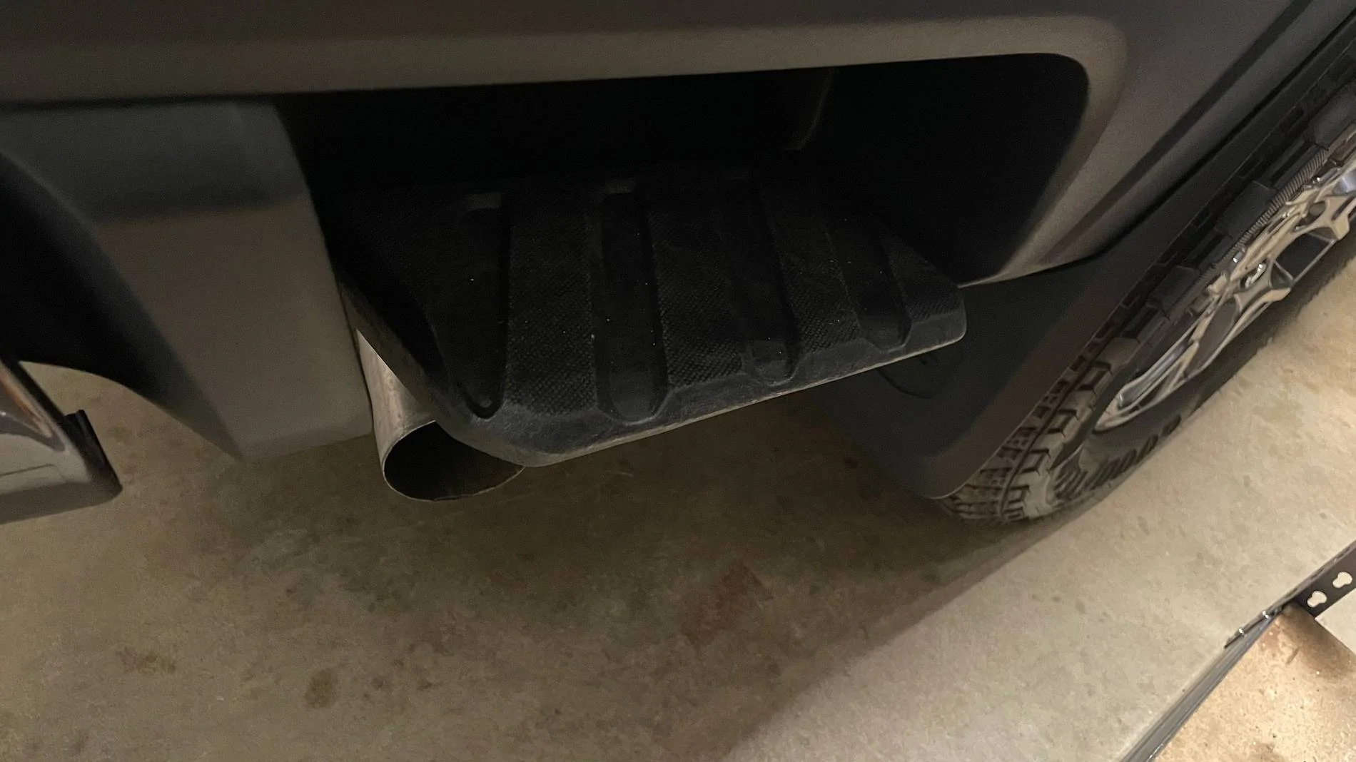

For me, yeah. Only did one side, cost me about 600 bucks. I found a truck almost exactly like i was about to factory order, except, missing 1. Mud flaps, and 2 rear steps. Will do the Drivers side some time down thwe road. must have IMHO. Cheap returners are Locking rear diff, Basic Tow and These steps.
Ford Ranger Adding Options at Dealership After Delivery IMG_2199
