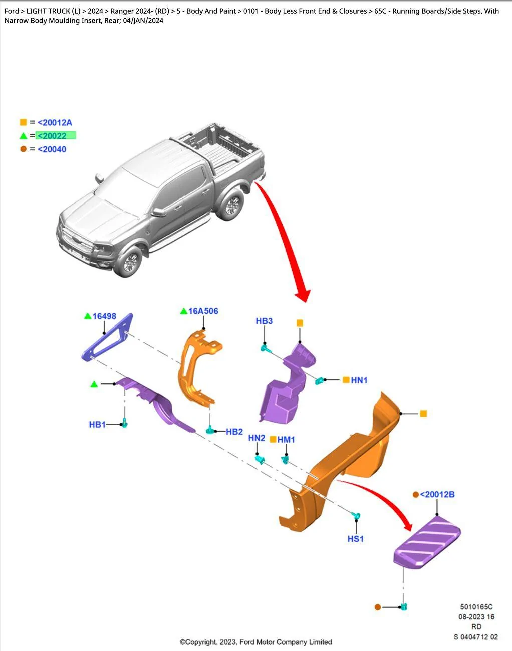

I ordered the rest of the parts on the diagram about two weeks ago and am still waiting for them to ship. The supplier said they ship directly from Ford.
Hi everyone,
[update 6/23] Waiting on two pieces to arrive and then can install (N1WZ-E20022-B and N1WZ-E20023-B which I had to order from a local dealer).
I dissembled the existing side trim to verify only these parts are needed. I have been ordering from www.quirkparts.com as their prices and service are good. The only pieces I could not order from Quirk are the two I mentioned above: N1WZ-E20022-B and N1WZ-E20023-B. These I found on the parts.ford.com website and ordered through a local dealer via the Ford Parts website search button (called / emailed them directly with the part numbers). Ask the dealer for a discount and they're likely to give it to you.
Here is the list of what to order. All in it is about $1,100 or $550/side + tax.
QuantityPart NameLayman's TermsSideDiagram #Part NumberUnit price paidTotal cost
1Step Body SideActual step that foot goes onRightN1WZ-6020040-A$133.99$133.99
1Step Body SideActual step that foot goes onLeftN1WZ-6020041-A$133.99$133.99
1BracketStep support bracket (front)Right<20022N1WZ-E20022-B$254.00$254.00
1BracketStep support bracket (front)Left<20022N1WZ-E20023-B$254.00$254.00
1MatBox step cover / surrounding exterior trimRight<20012AN1WZ-2620012-K$155.10$155.10
1MatBox step cover / surrounding exterior trimLeft<20012AN1WZ-2620013-K$155.10$155.10
8BoltM6 X 16 HEX (hex head bolt and washer)HB2W706557S307$1.86$14.88
4BoltM10 X 25MMHB1W721982S307$1.86$7.44
Total$1,108.50

@tpack424 Thank you for making that table! I appreciate it immensely. I did a quick search and didn't come up with anything for those three parts you're missing currently. Bummed how much this is all going to cost, but definitely want the steps.
How was disassembling the side panel of your truck? Is it just on by tabs? I never actually looked at that.
tpack424
May 1, 2024
2024 Ford Ranger XLT FX4
It's mostly tabs though there are a few screws. One of which is hidden behind the fender flare and is hard to access. I was unable to get the fender flares off without about breaking several of the tab attachments on the flares themselves. You can't tell once it's back on. I'm not that experienced with taking these things on and off though.
You also have to (partially) remove the bumper which requires removing the parking sensors and trailer hitch connectors as well as the tabs connecting the plastic bumper cover to the metal bumper as well as the metal bumper on each side as well.
