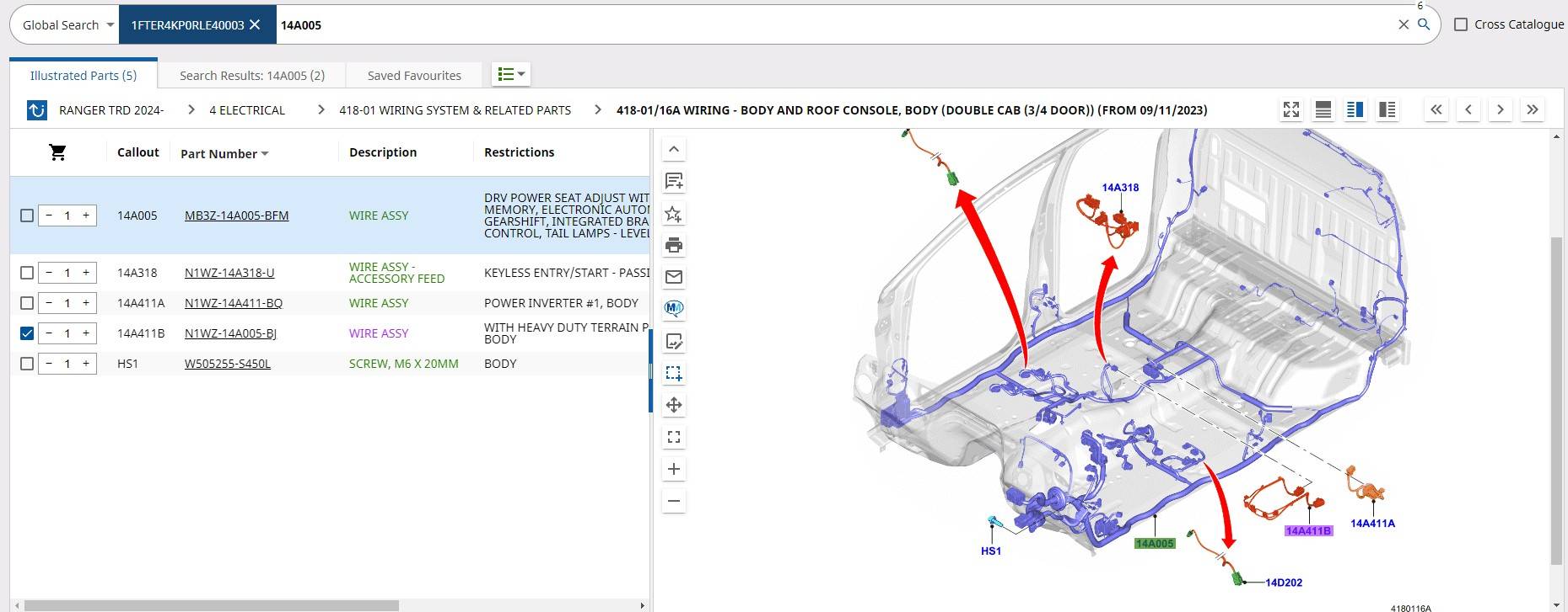

Please see attached photos. The exploded view, shows the harness that contains the connector, and there's a photo of the plug and it's location. We did a few 2024 Broncos. In cact, the Bronco without a hitch, is prewired to the back bumper for a 7 pin. Add bracket and 7 pin at the rear, TRM, dash switch and program, and voila, you have the trailer brake option. Do you perchance have your vin available?

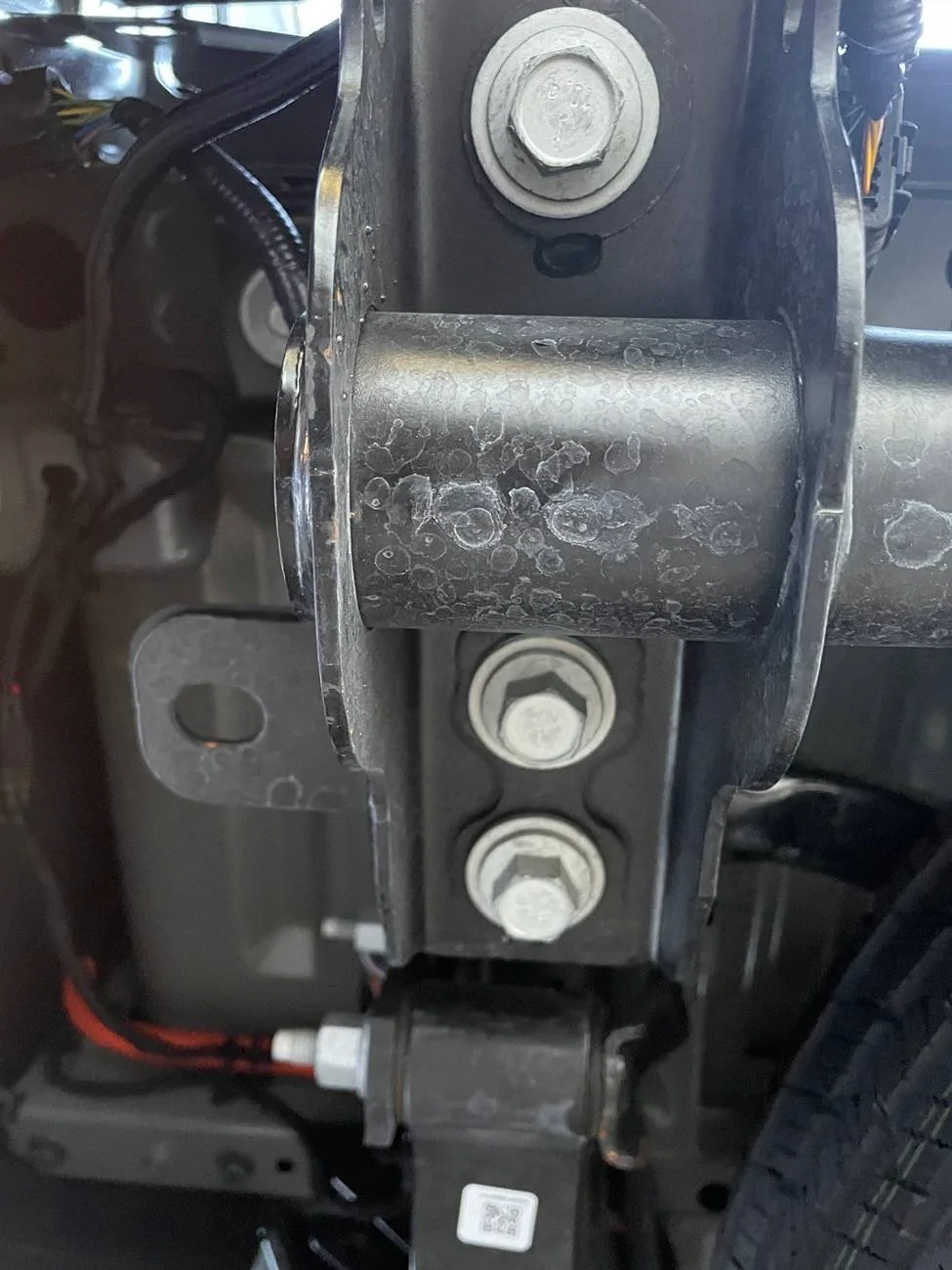

I am planning on doing this job this weekend. Just to be clear, you removed these 3 bolts on one side after marking the location and supporting the bumper and loosened the 3 on the other side?

That's correct. Mark the location on the bracket v frame for alignment on reinstall, forward-back and side to side, both sides. Just lossened the opposite side from where i was working, and removed all 3 bolts from the side i was installing on. Supported the removed/working side with a rapid jack and i think i had to add one or 2 pieces of 4x4 for reach. Worked out extreemly well.

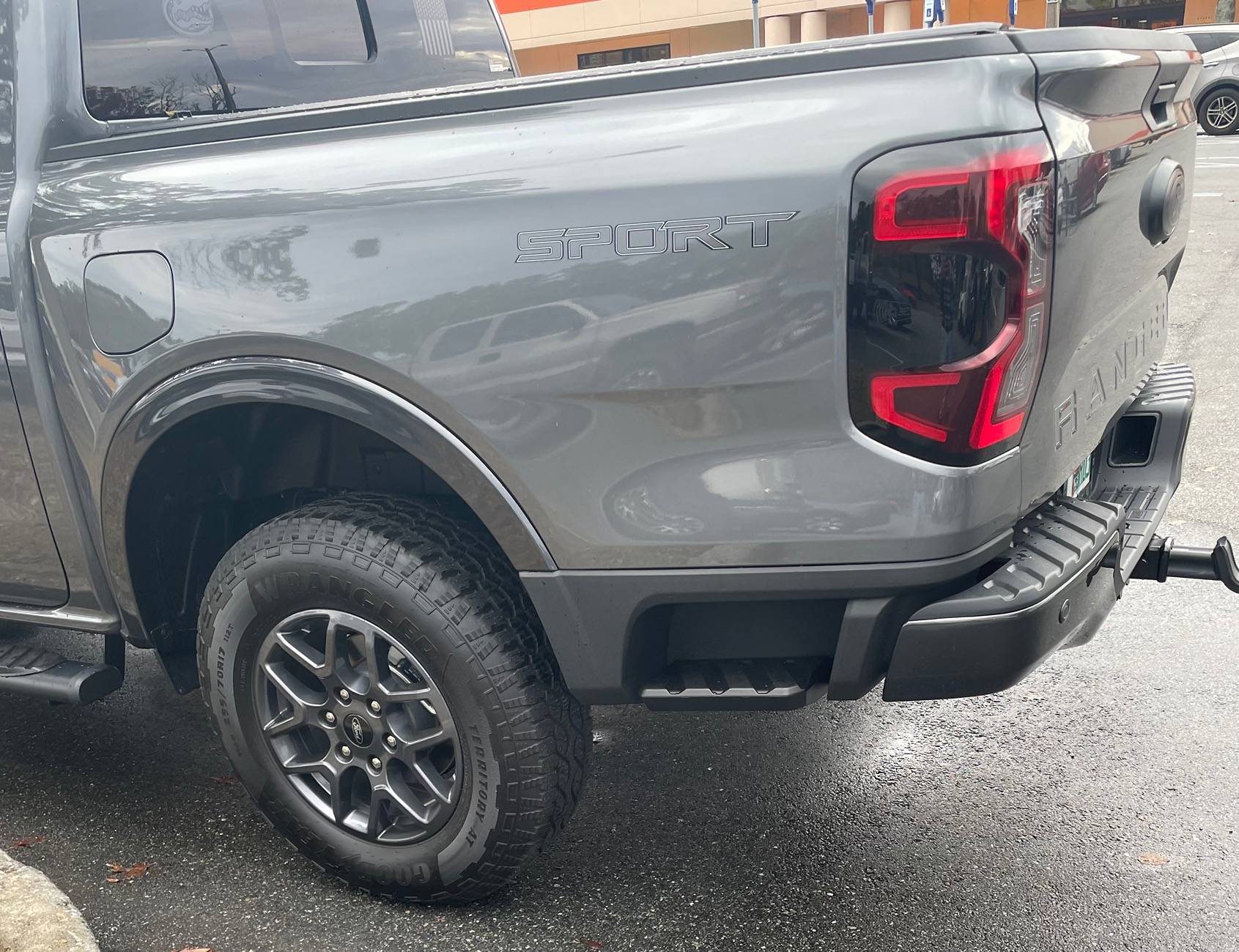

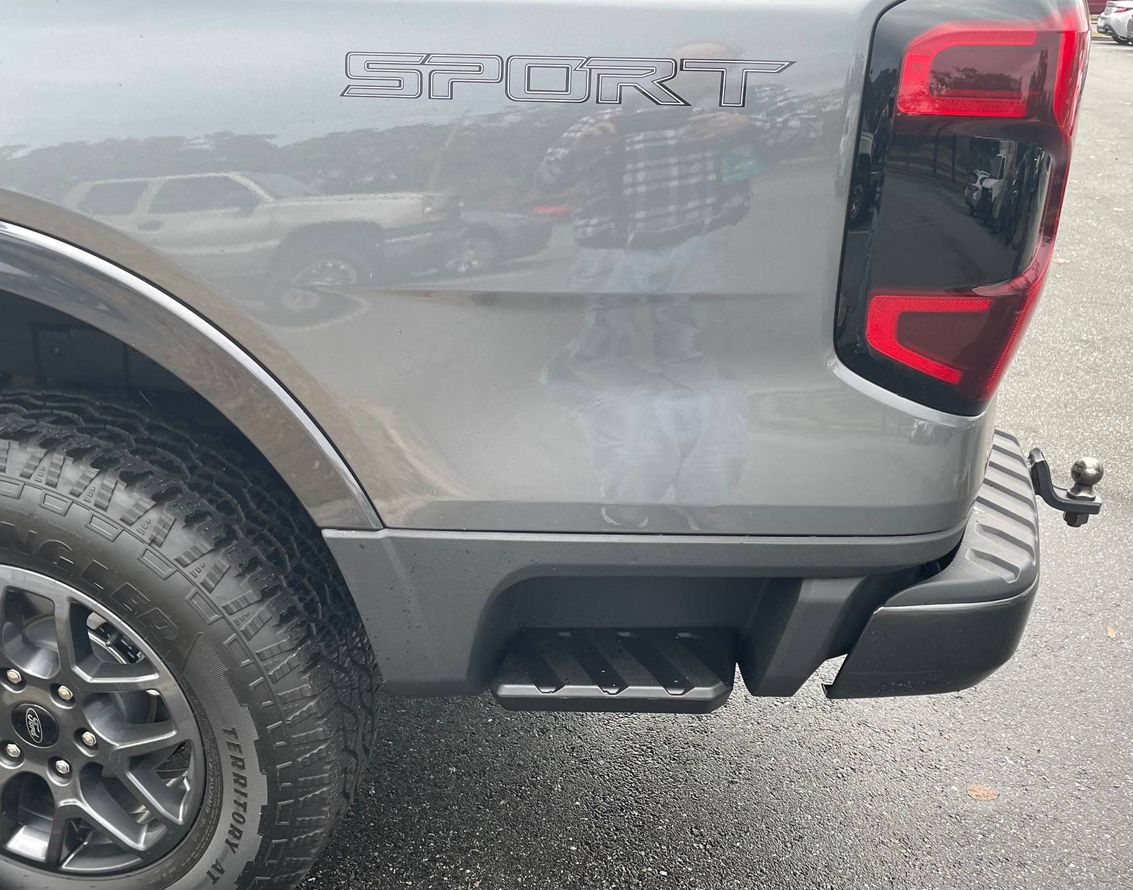

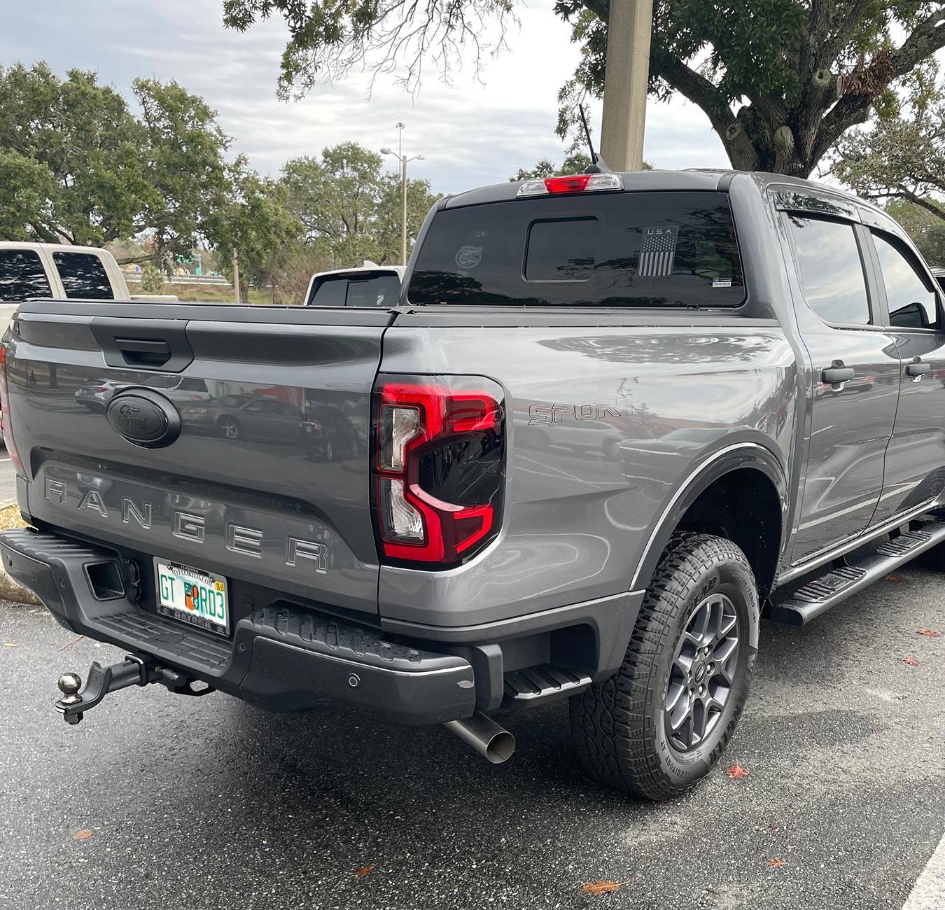

Couple more hours today and I am done!!! I broke the clip retainer on the wheel molding, my kid is a master body tech and he says they epoxy them all the time so one day this week I’ll stop by after work and get that done.
As far as the steps themselves, I am about 95% pleased with them. They bolted up and fit really well except for a small gap at the top of the passenger side. May be able to adjust that out. Interestingly, on that side there is one less clip at the top than the driver side and the panel I took off the truck.
My wife came out to see them, and her response was, “I don’t think I could get up in them”. I said, “not sure I can either”. (We both are going to hit 70 this year.) She said, “well, they look cool anyway”.
Then she said, “are they going to have lights in them?”
Hmmmm. It would be real easy to tie into my bed light circuit.

What is the purpose of this? I’m asking after looking, but doesn’t seem to need to be done. I’m getting prepped to install mine.

you can't remove the trim piece without dropping the bumper.
