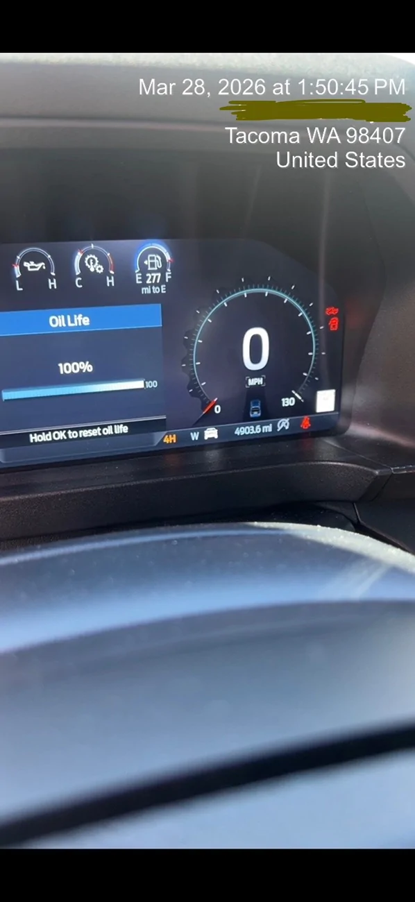

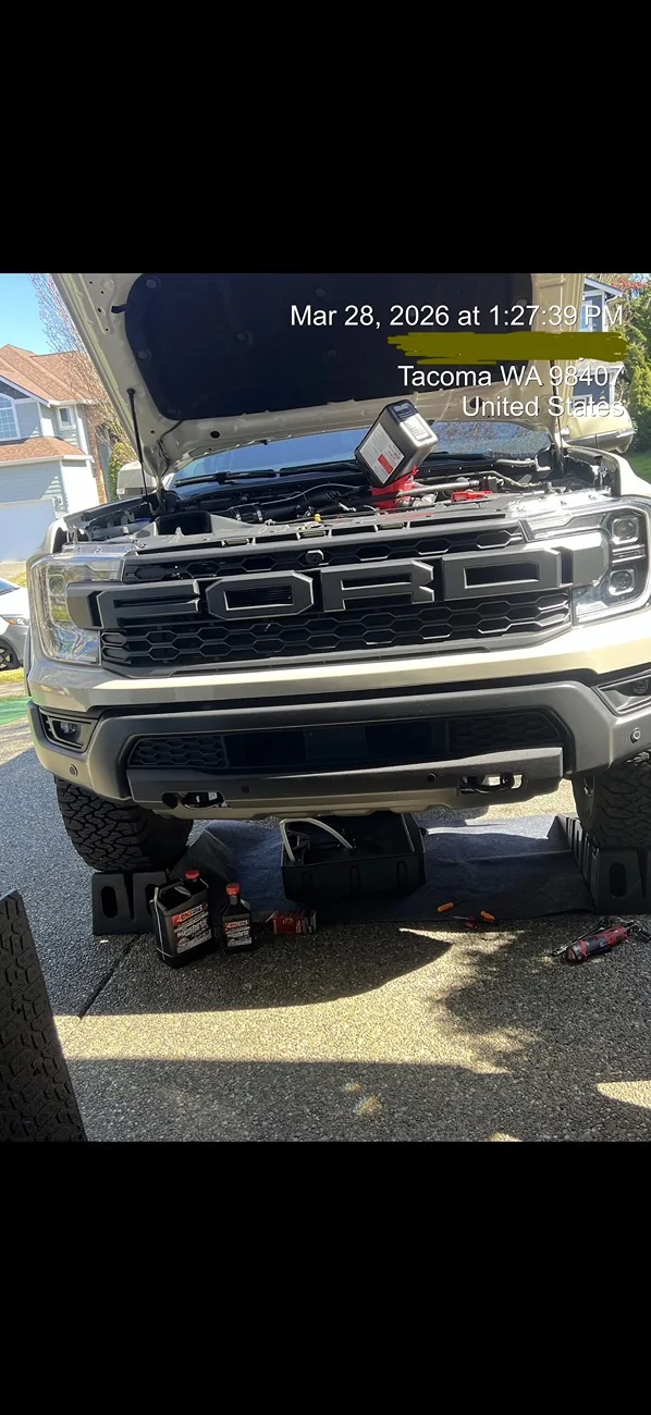

Document w/Time Stamped Photos of the process ALWAYS!!!
Once on a previous Taurus SHO, on a warranty issue, I was asked by Ford for any oil change documentation. Without any receipts I just provided a string of documented changes exactly like this. The service writer said they’d never seen anybody do it this way. Ford made a decision within 48 hours that I had gone above & beyond the o/c interval as I could prove service every 6-9 months irregardless of mileage. They never asked for anything else and totally took care of me.
This is how I’ve done it for the last 12-15 years now. It was great when you could post photos in the Ford Pass App under the service icon. Just keep them in a separate folder now.
Ford Ranger Changing Your Own Oil - 3rd Party Extended Warranty Issue IMG_0652
Ford Ranger Changing Your Own Oil - 3rd Party Extended Warranty Issue IMG_0651

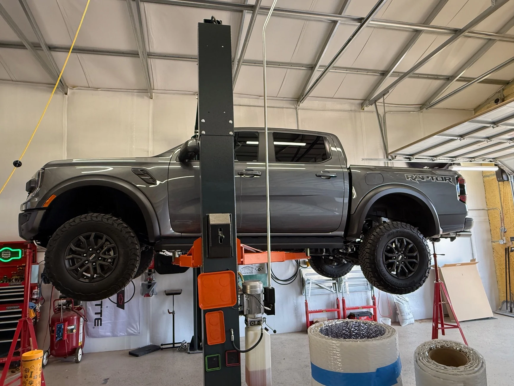

I owned many Jeeps in the past, including my wife's Grand Cherokee that we still have. I created an account on the Mopar website for each vehicle and dealer maintenance appears for these vehicles. You also have the option to document non-dealer maintenance, including the maintenance you performed, so it is documented. I also attach a photo of doing the service in my garage.
Ford Ranger Changing Your Own Oil - 3rd Party Extended Warranty Issue IMG_3589

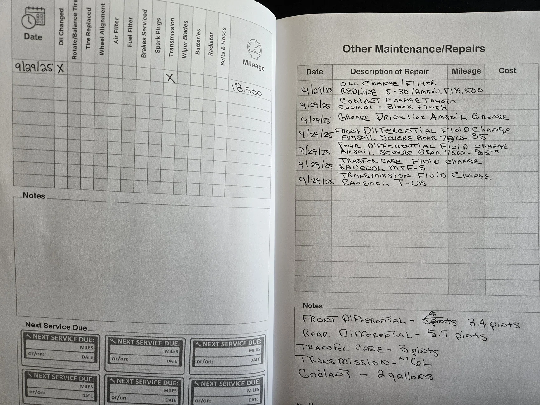

I do all the regular maintenance on my vehicles (oil changes - 5k OCI's, differential and transfer case fluids 30k OCI's, transmission fluid 30k OCI's, brake flushes and steering fluid). I keep a manual log and document everything. I have never had an issue with a warranty claim. Also, at resale it's a great to be able to show buyers that you have maintained your cars and trucks. I use this simple log book and keep it in my glove box: https://www.amazon.com/Vehicle-Maintenance-Log-Book-Motorcycles/dp/B0F4R6MP3H/ref=tmm_hrd_swatch_0
Example page from my 2021 4Runners log:
Ford Ranger Changing Your Own Oil - 3rd Party Extended Warranty Issue 20260821_103640
