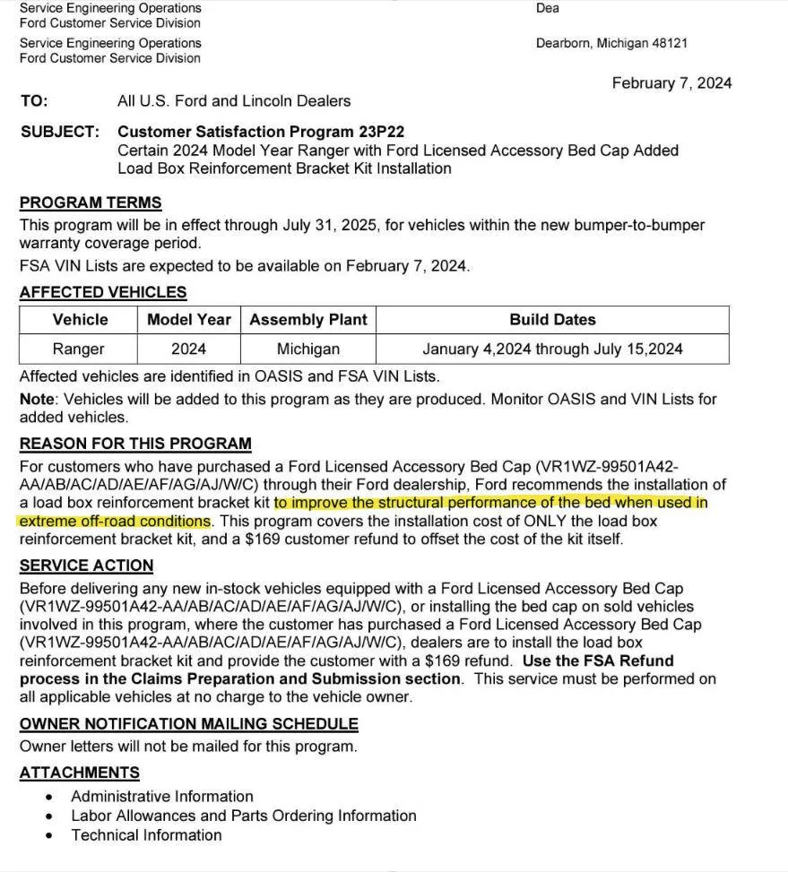

Ford themselves say (on the official TSB for this) that it's only necessary to install if you plan on offroading with a camper shell. They even say specifically "extreme offroad conditions".
Very likely unnecessary and a waste of money for the vast majority of people. There's a lot of chickenlittles on this forum who think crawling the mall parking lot or driving a gravel road requires j-braces.
I'll remind everyone here that there hasn't been a single 6G ranger owner that has had any confirmed/verified issues occur from not having j-braces and the trucks have been out for over 2 years now.

That's from the Ford website. These are needed for anything over 88lbs being supported by the bed rails.
The bed was designed to flex with the frame. With additional weight on the rails, you're increasing torsional forces on the seams in question any time the truck flexes. Doesn't matter if that torque is applied when crawling over rocks or going over railroad tracks, it's still above the design specifications of those seams.

This is how ford described it on the official tech service bulletin that went out to all service departments
That's all well and good, but you're forgetting to follow the money. Ford is installing these on EVERY Ranger with a Ford licensed topper regardless of trim or intended use case. If these weren't deemed necessary for typical use, Ford wouldn't spend the money to install these, and especially not on something like a base 2WD XL that isn't built for "extreme off-road conditions". But again, all the talk about off road use is just a red herring. Ford knows if the bed cracks or fails with a customer installed accessory they can blame it on user or installer error.
Remember that scene in Fight Club where Jack is discussing how manufacturers determine if they are going to issue a recall? Someone at a Ford did the math, and they determined the potential liability of a bed falling due to a licensed accessory purchased through Ford was greater than the cost of installing this part. That should raise alarm bells.
If you still disagree, that's cool, but if Ford is concerned enough to install these parts after the fact on their dime, then it's likely something we should be concerned about as well. Hopefully I'm wrong, but when there is smoke...
Its pretty specific, they say the problem is for trucks with loads above the bed while off-roading(or driving on public roads in Los Angeles). So unless you're overlanding its probably not a huge issue.
