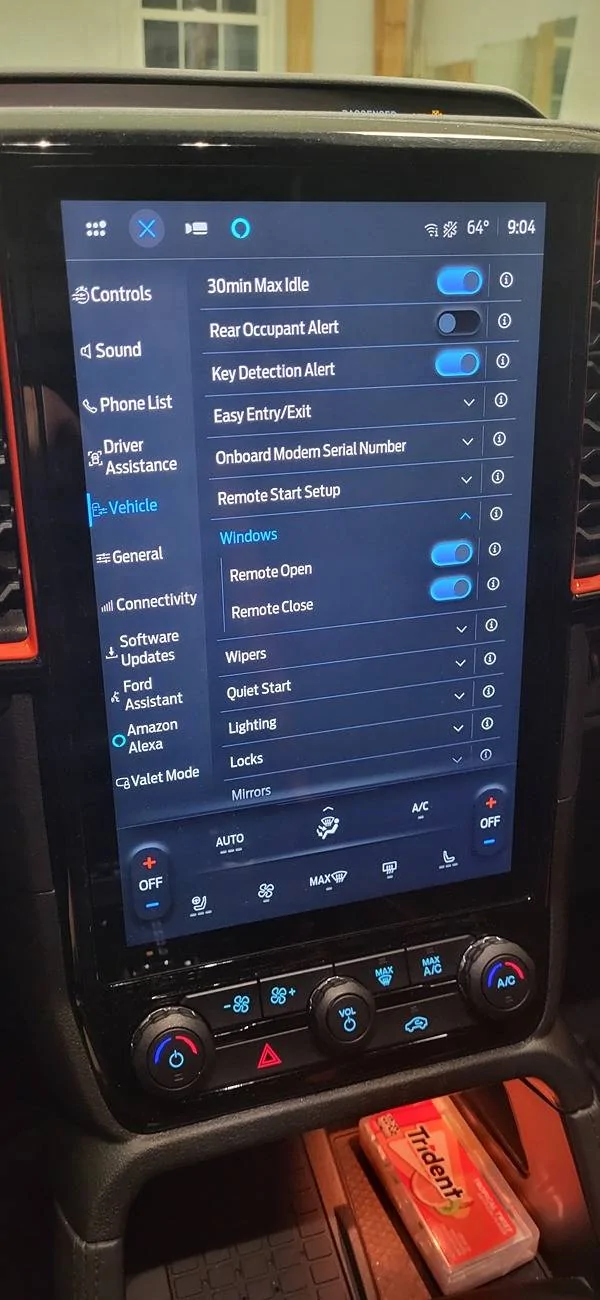

Just checked my truck screen. I have window listed on screen.
