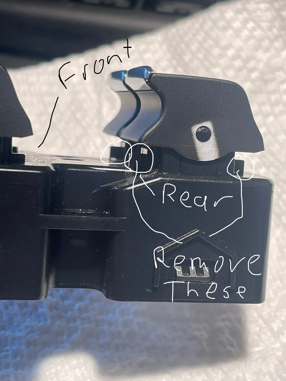

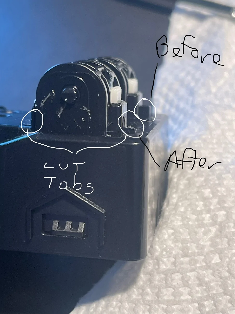

I have a 2025 Ranger lariat that has auto up/down front windows but not back windows. I can also have all windows go up or down with the key fob. I don’t know which versions of Ranger have this setup but if yours does this then you can probably do this mod too. The switches that don’t have auto up/down have a plastic tab that prevents the button from being pushed down far enough to engage the auto up or down feature, if you simply cut the tab off then the switch will work like the auto up/down ones. I did it on my drivers side rear window switches and both rear switches and they all have auto up/down now. You have pry the switch panel up in the seam and it will unclip and you can unplug it. Then unscrew 3 screws on the drivers side or pry the switch out with the four tabs for the rear ones. Once the switch is out you can cut the tab off.

You don't need them. Once you look at the switches outside of the door card, you'll clearly see the tabs. Just rock the switch and you'll see exactly where the tabs stop you just short. You'll be like, sonuvabitch... really?!?!?
But I uploaded OP's pic again, just in case.
