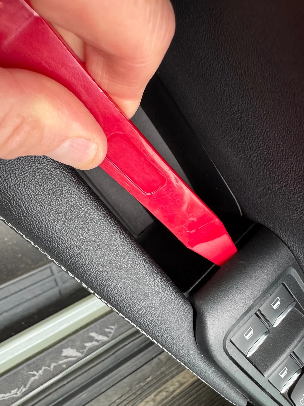

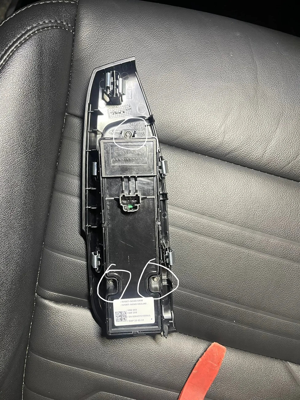

Yeah, same…wouldn’t mind a bit more tutorial…I didn’t get a chance to look to hard at it today, but, if I have I correct, to get the 4 switch panel off the arm rest, I just lift cover off with some kind of trim tool, or flat screw driver, taking care to slide the whole assembly forward off a rear clip, then unscrew a few small torx screws that will apparently reveal themselves - then chop the noted plastic stops off the rear rocker switches, then as the Haynes and Chilton manuals used to say “replacement is reverse of removal”
do I have that right?? Maybe I’ll try it tomorrow…(if I do I’ll try to document it for other scared-y-cats!😂)
It’s super simple. From start to finish took me maybe 20min. I used a small round file and filed down the little tabs.

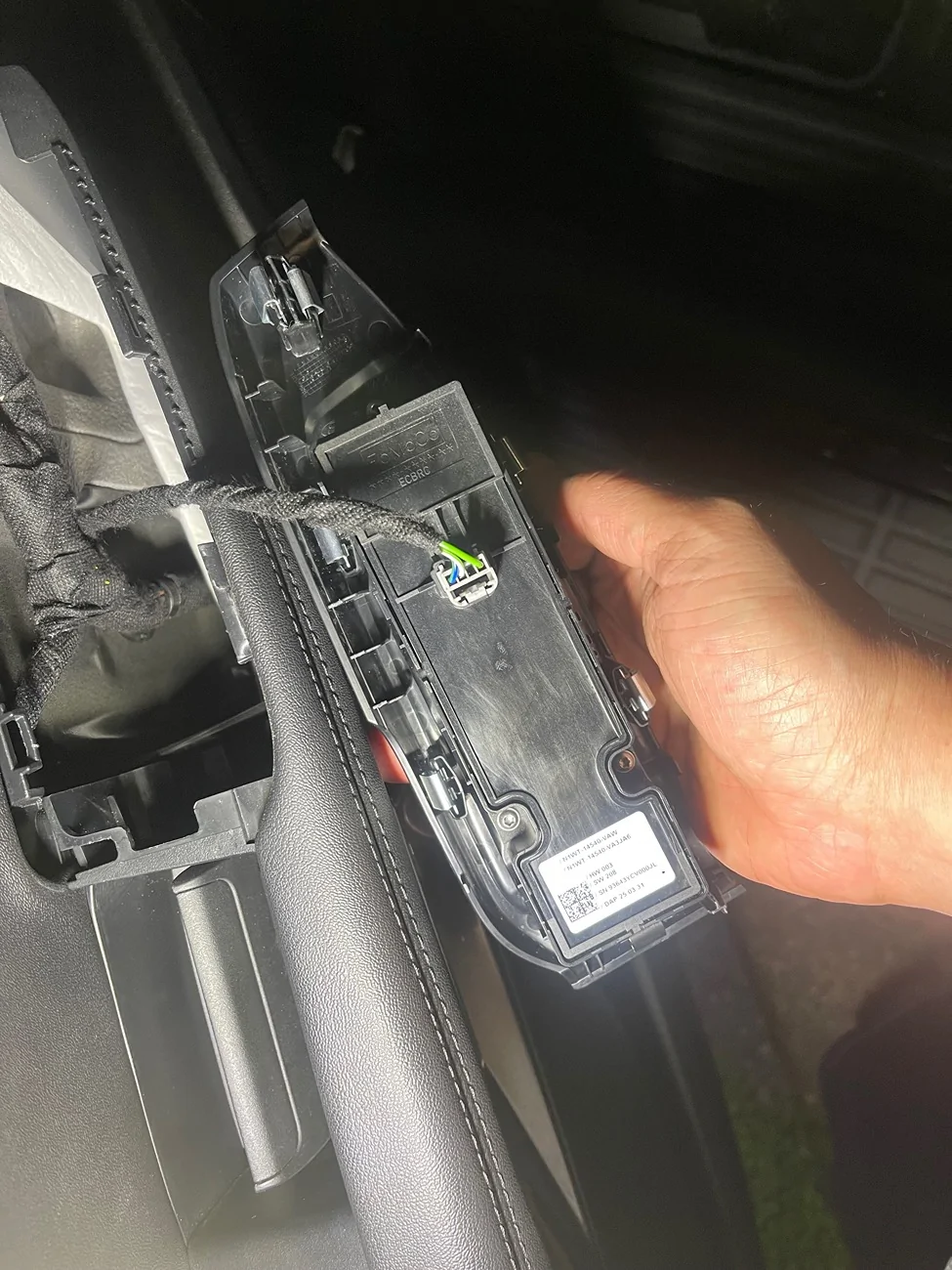

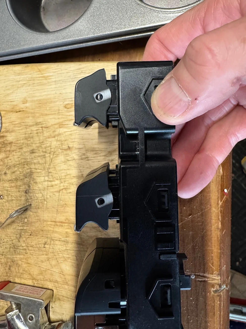

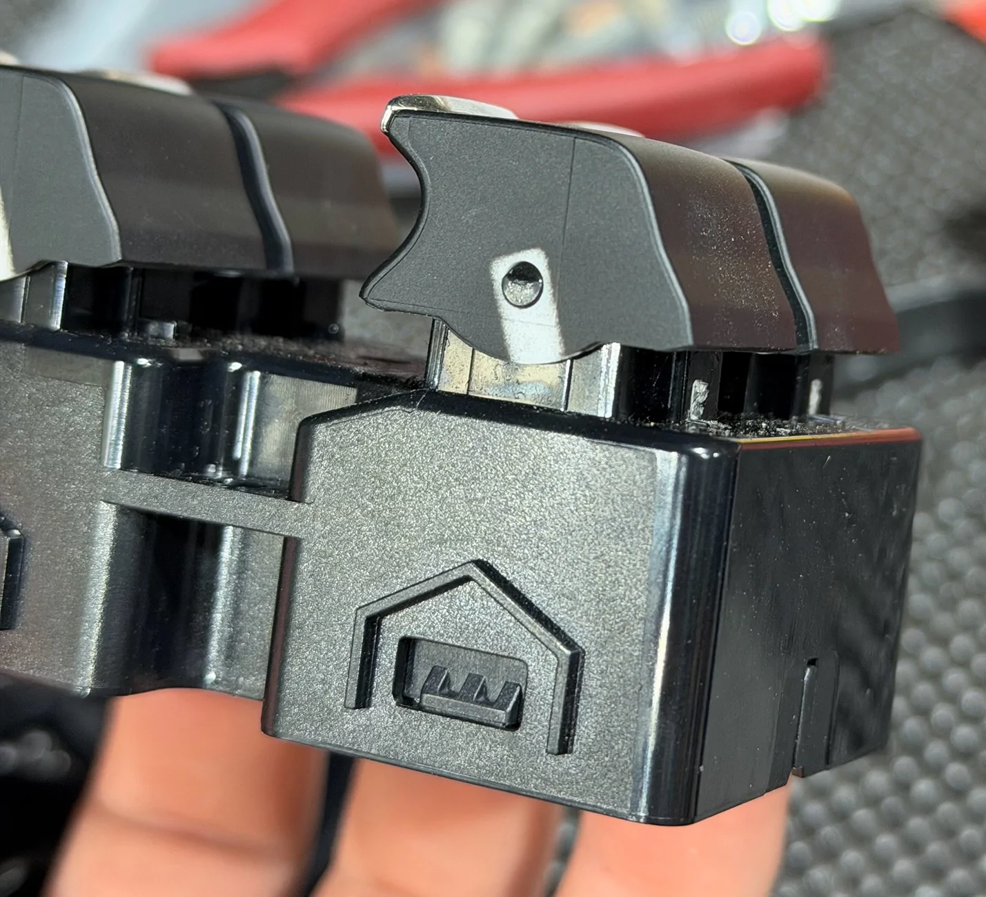

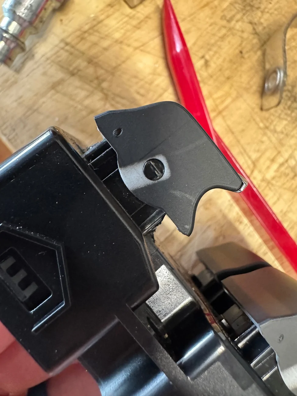

Yes, it makes rear windows auto up and down just like the front ones. The switchs will have the detents like the front ones and when you push it passed the detent they will go all the way up or down just like with the front ones. The tabs you cut off are just there to prevent the switch from going far enough to get to the auto up/down part. It’s really simple to take the switch bank out, you just pry up from the back with a trim tool to get the switch bank to separate from the door card. Once it pops up just pry the rest of the clips up until it detaches. When it does unplug it by pushing the little tab on the connector inward. After that unscrew the 3 torx bolts and the faceplate will come off and you’ll have access to the bottom side of the switches and the tabs you need to remove. It’s very simple and easy and takes like 10 minutes to do so don’t be scared to do it if you want to lol.
Best hack ever!
Are these photos of the driver's switch assy?
If so, only 3 wires to control everything, including mirrors?
Must be some digital logic going on inside.

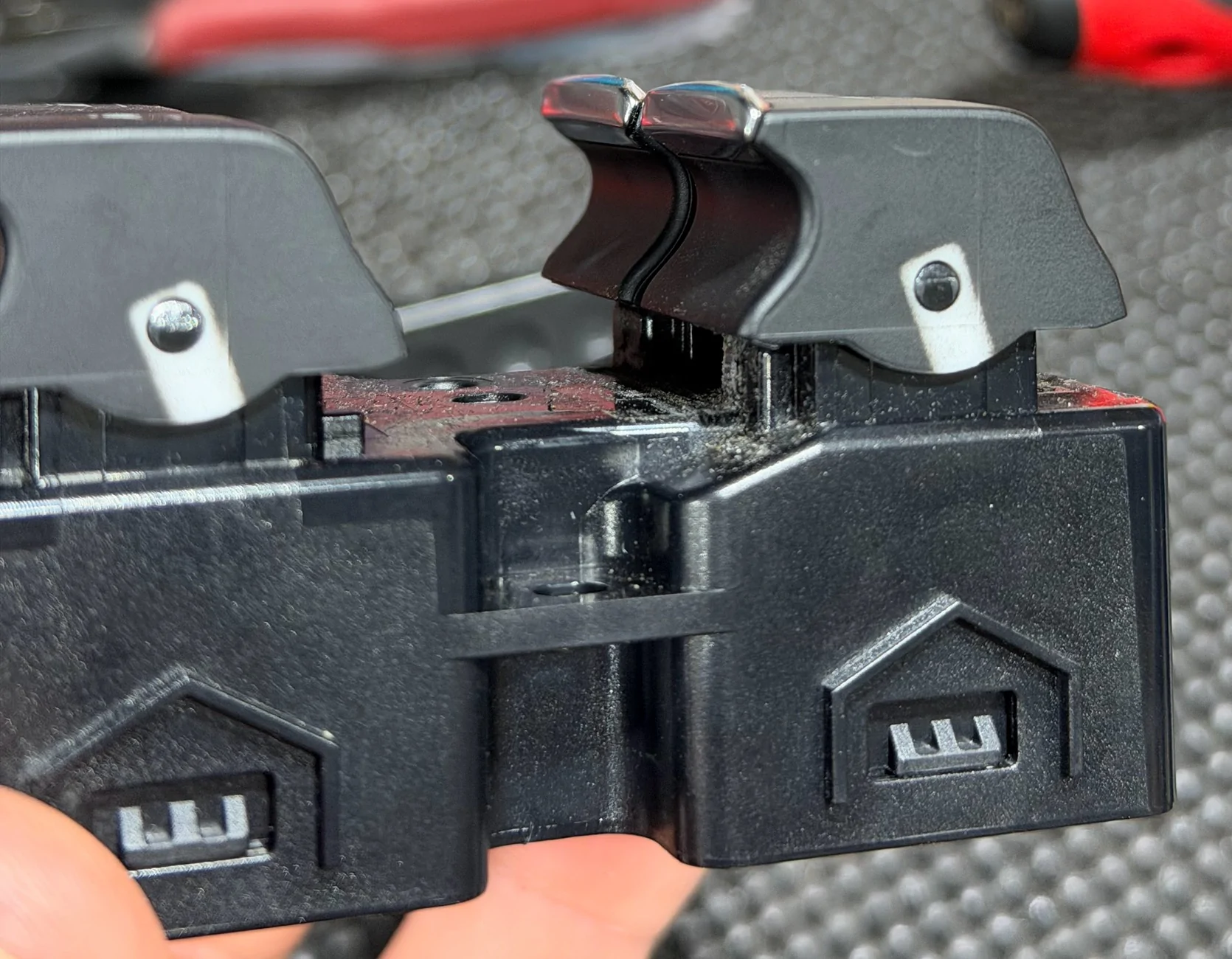

thanks for the confidence inspiring pics, I found it to be exactly as Gman10 said. My harbor freight trim tools did just fine to get the switch panel off.
i couldn’t get the switches themselves off the rocker posts, so I just hacked the stops with some small side cutters and a round bastard.
also, I put my life at risk to test the “auto stop/reverse/safety” function, I was sure had to the programmed….i don’t have kids, my rear window switches have been locked since day one, but my dog’s tail could get in there just the same….if you’re concerned, don’t be, it didn’t even break a bone!🤣😂
