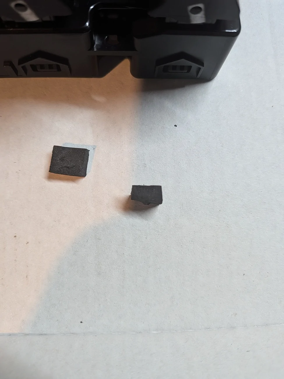

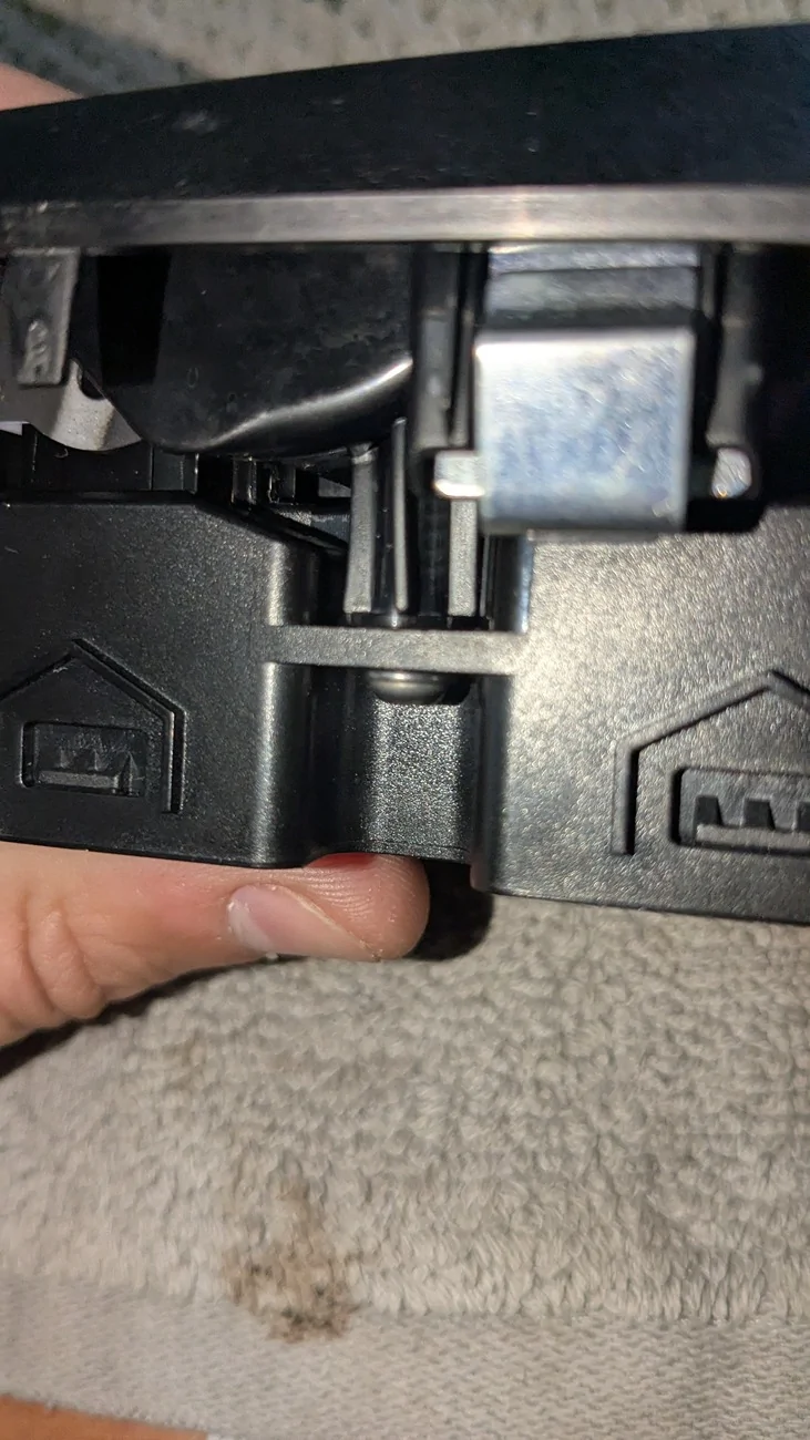

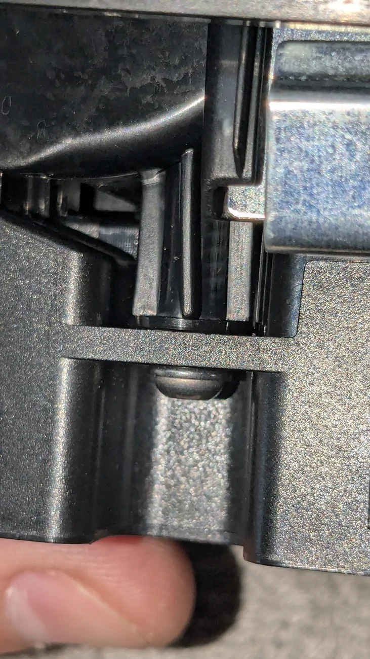

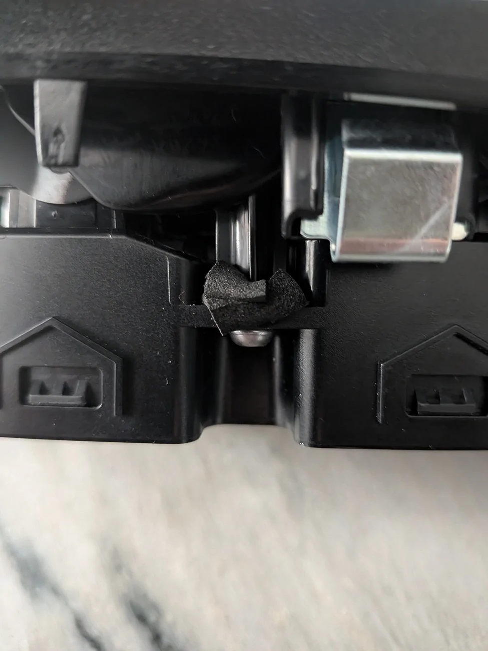

I noticed that the rear switches (on the drivers control) rub against the trim. It looks like the switches already had some wear on them so its probably been doing this all along. There just was never enough travel in the switches to notice. So I added two small "nut" size pieces of weather stripping to give some extra space for clearance. I had to double up on both sides. That seemed to give enough clearance and I am not concerned about any weather related issues as its designed for deflecting moisture.

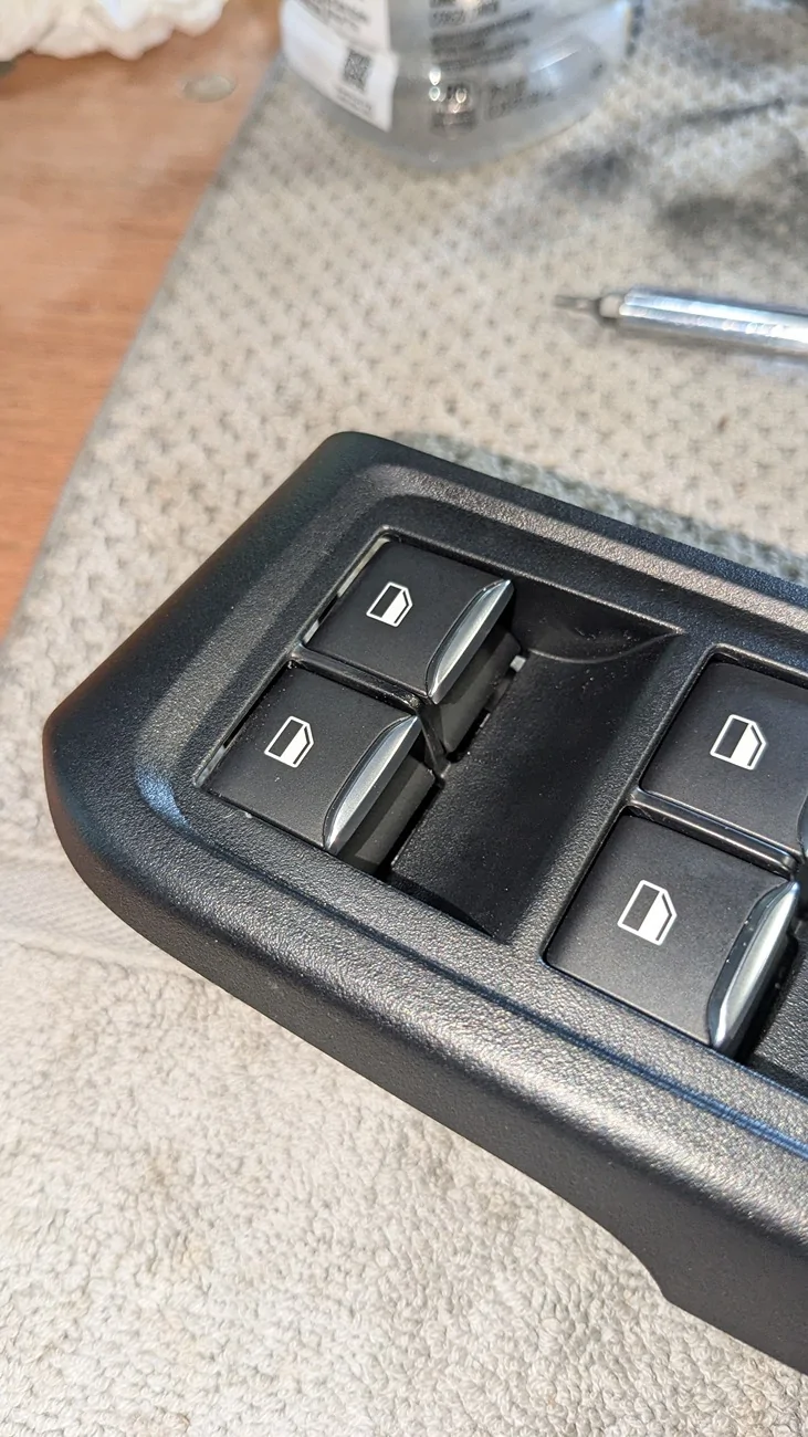

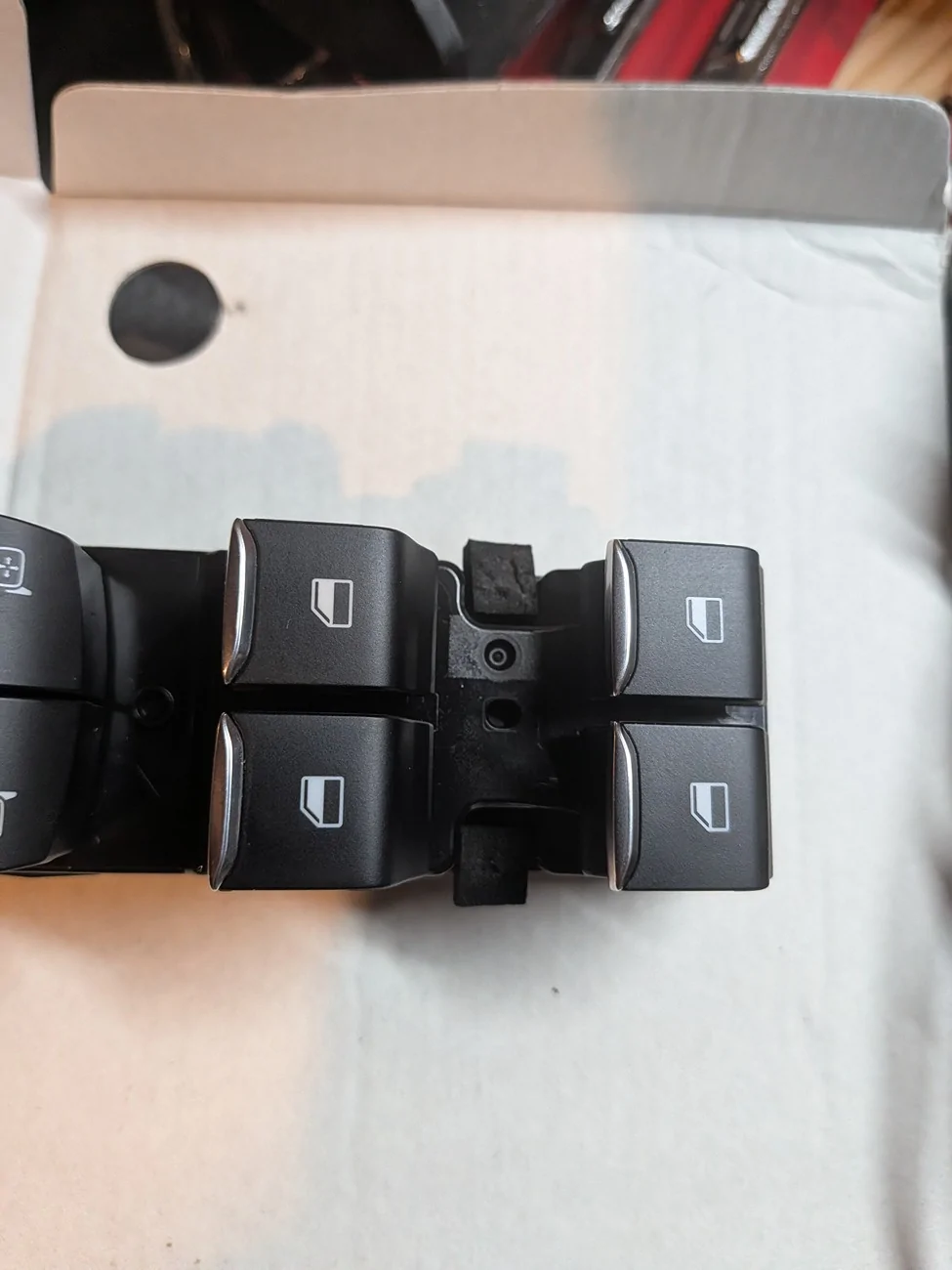

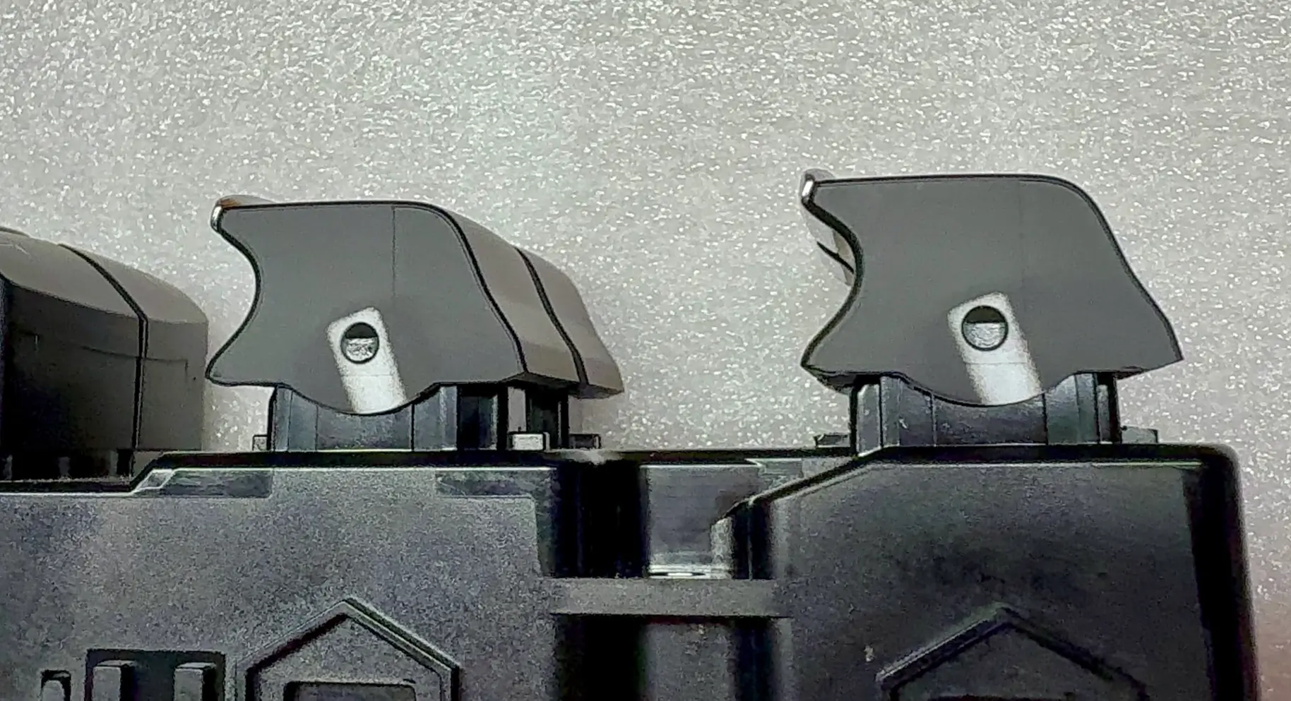

Wish I had read your post before jumping in and doing the mod to my Ranger today!
I ran into the same problem - with the added travel of the auto up/down, the switch was rubbing on the trim. I tried trimming the trim with an exacto knife on the inside where you can't see, but it didn't help enough.
Similar to what you did, I added a plastic washer to the 2 rear torx screws, to act as spacers and give enough clearance for the switches. Worked like a charm!
Thanks again @Gman10 !!
