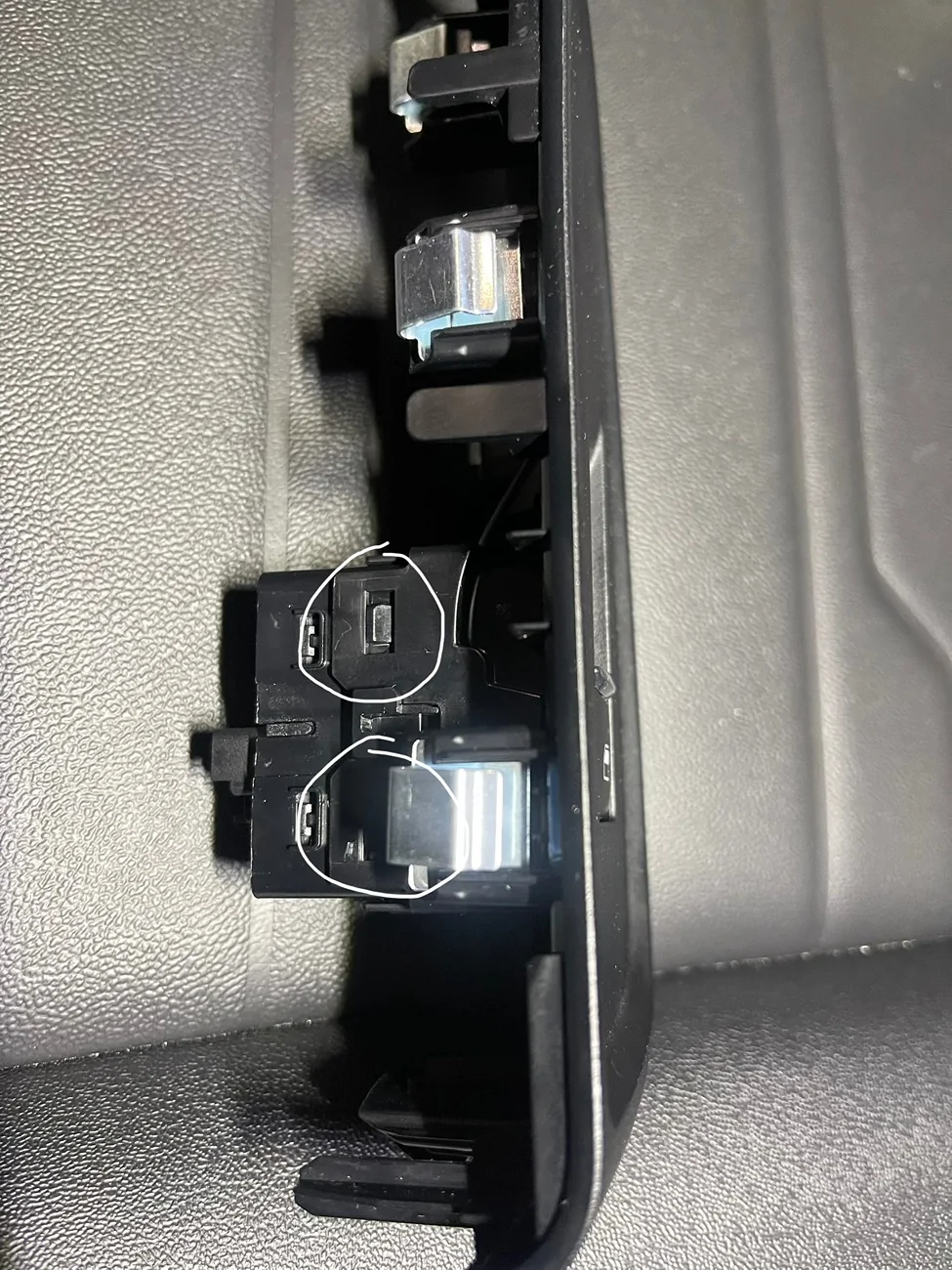

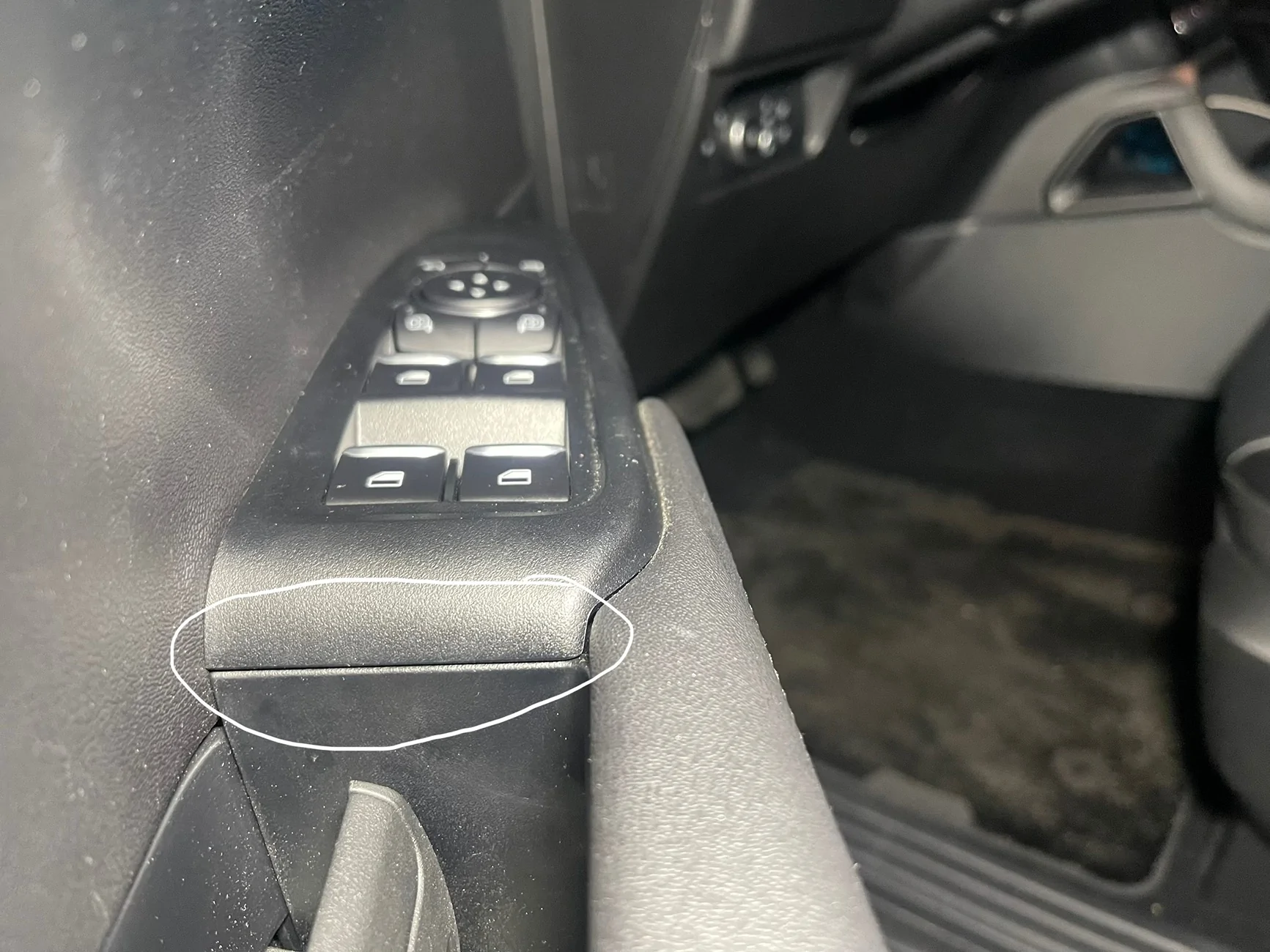

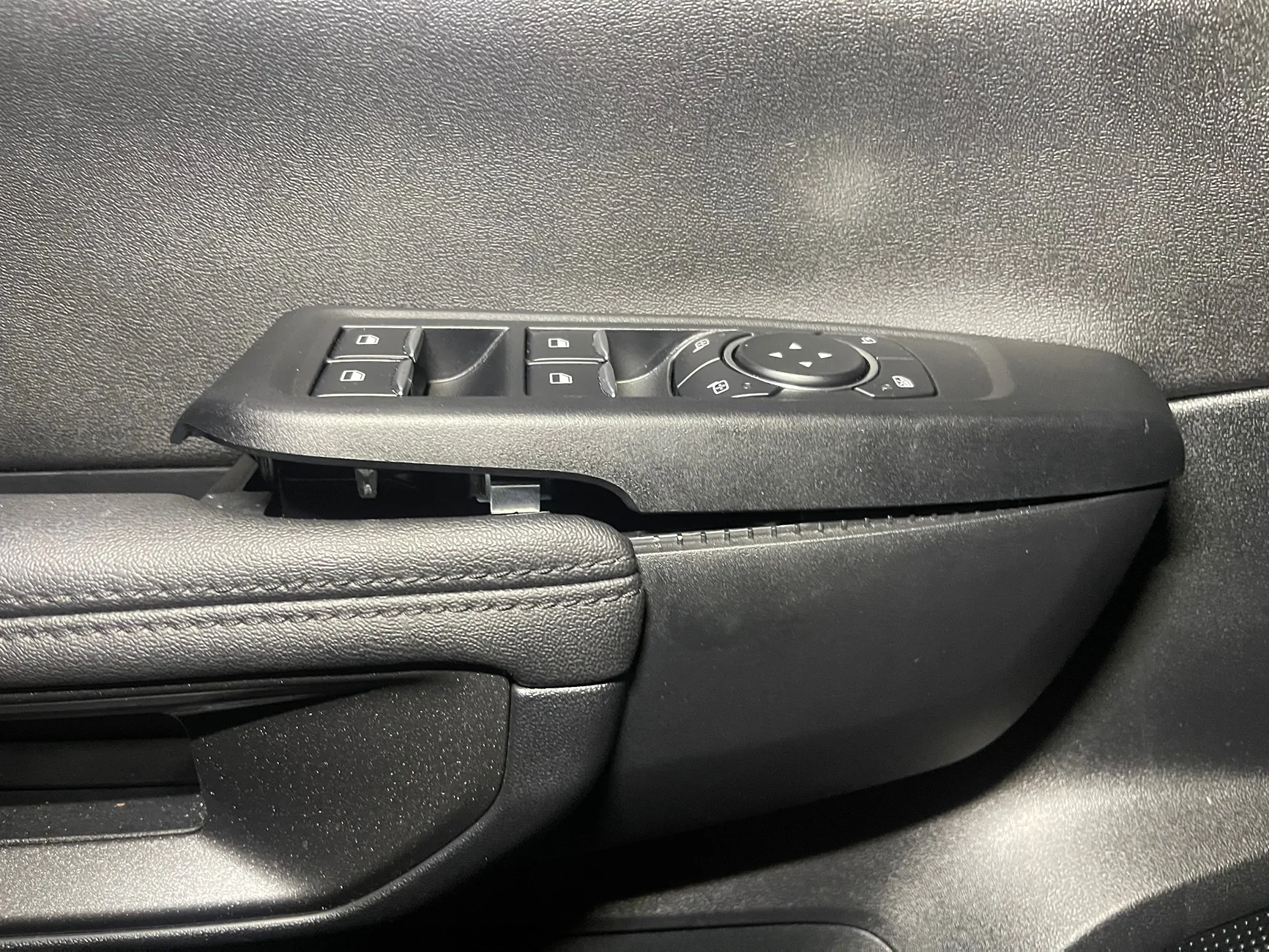

Yes, it makes rear windows auto up and down just like the front ones. The switchs will have the detents like the front ones and when you push it passed the detent they will go all the way up or down just like with the front ones. The tabs you cut off are just there to prevent the switch from going far enough to get to the auto up/down part. It’s really simple to take the switch bank out, you just pry up from the back with a trim tool to get the switch bank to separate from the door card. Once it pops up just pry the rest of the clips up until it detaches. When it does unplug it by pushing the little tab on the connector inward. After that unscrew the 3 torx bolts and the faceplate will come off and you’ll have access to the bottom side of the switches and the tabs you need to remove. It’s very simple and easy and takes like 10 minutes to do so don’t be scared to do it if you want to lol.

It’s the same process to take the rear door switches off but there’s no screws to unscrew underneath. The switch is held in with 4 plastic tabs (2 on each side of the switch) that you have to pry up to get the switch out and get to the bottom side where the tabs to remove are. I did one side at a time while applying pressure on the switch from the other side with my finger and it eventually came out. Just be careful not to break the tabs holding the switch in by prying to hard on them.

Did the drivers door in my wife's RR today and it is exactly as Gman10 described. The trim piece that houses the switches is held on the door panel with metal clips and they hold them on the door panel pretty friggen tight I don't think I would want to try and remove it with just a flat blade screwdriver. I have a box of assorted trim removal tools and one of them kind of looks like a butter knife and it worked well. Like I said that piece is on there pretty snug so I took my time working it up all the way around it and once you get past a certain point it'll pull right off just don't try and strong arm it in one spot or you would risk cracking the plastic.
Once you have it pried off like Gman said you unplug the little connection and remove three #10 torx screws to get access to the widow switches. I have these thin little cut off wheels for my Dremel and used that to cut those pieces off but the plastic seems pretty soft and you could probably cut them with a knife.
