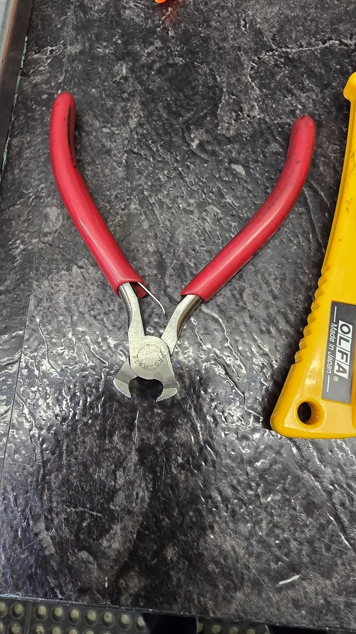

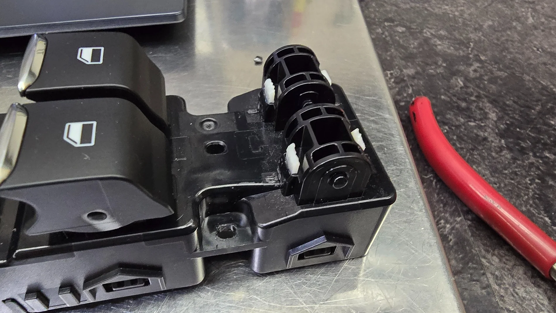

I just did the mod tonight. Thanks again Gman10 for creating this thread.
For what it's worth, a pair of small end cutting pliers make short work of those tabs.
you can make the horizontal and vertical cuts to the back side and the horizontal cut on the front side of the switch. A utility knife takes care of the vertical cut that the pliers can't reach.
