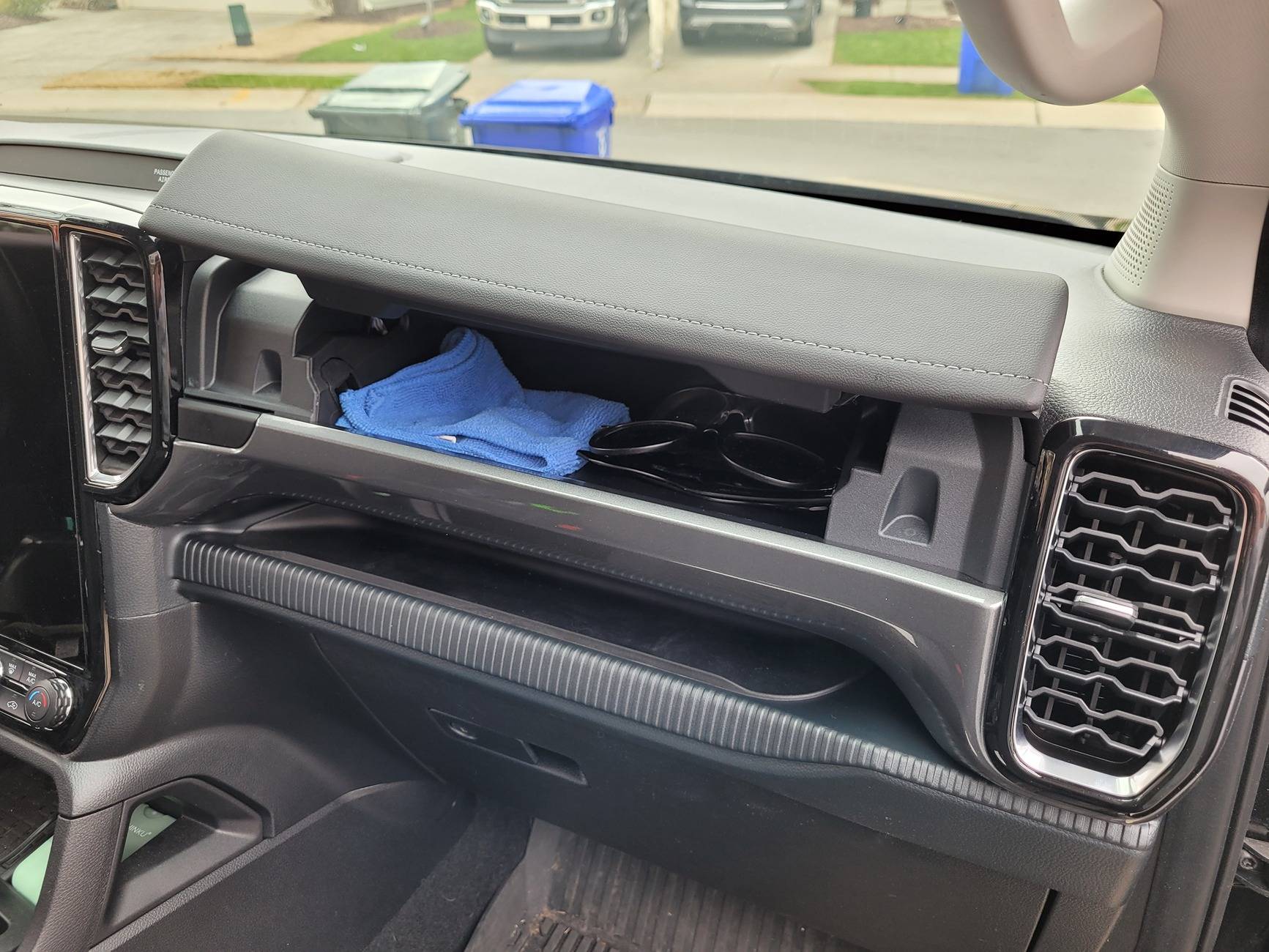

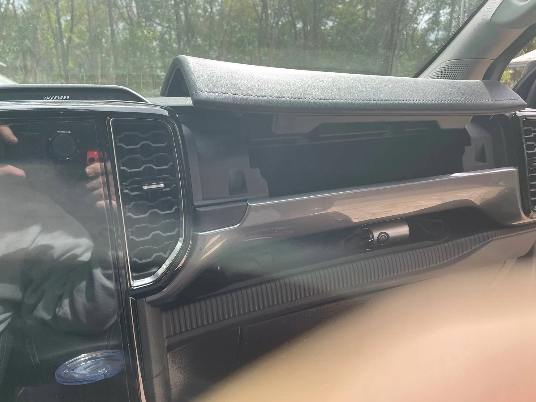

Installed my glovebox today after deciding not to return it after being damaged in shipping mainly because they are rumored to be backordered with no ETA of when I might get another one. I epoxied the piece back on and it held really well. The whole thing took about an hour because at the start I suffered from FOBC Fear of Breaking Clips and tried to pry the honeycomb piece off gently. That didn't go over so well and had to close my eyes and just pull. The other time sink was trying to find all the blue clips (and white from the back piece) but eventually found them. Probably 6 in total.
Here's my experience:

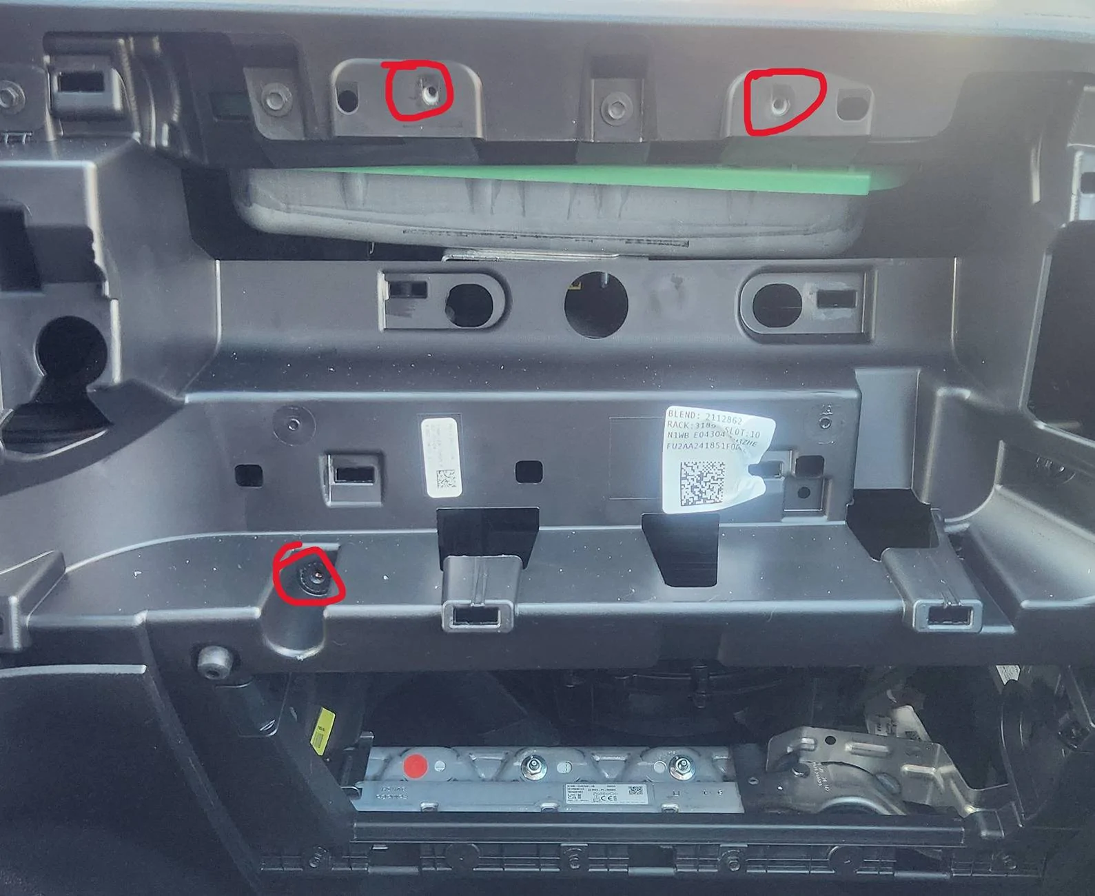

There were just 3 bolts holding it in (not 4 as mentioned in original instructions) the bottom one is hidden under the shelf. My 7mm socket was missing from my set for some reason but a 9/32 worked just as well. I put the bottom bolt back in even though it doesn't hold the new trim just for possible vibration issues. The top2 bolts then hold the new dash piece in.
Ford Ranger Lariat Top Glove Box Install on XLT 20250309_162359
After installing I was disappointed to see that the color of the leather door and the plastic on the dash is a slate grey and not black. I guess the XLT and below have black dash and armrest and Lariat is grey. It has been mentioned here in previous posts but here are some pics to really see the difference in color. Too late to turn back now but if it is something that will bother you then it could be a deal breaker. It is most noticeable from the passenger side seat and when opening the door.
Ford Ranger Lariat Top Glove Box Install on XLT 20250309_163635

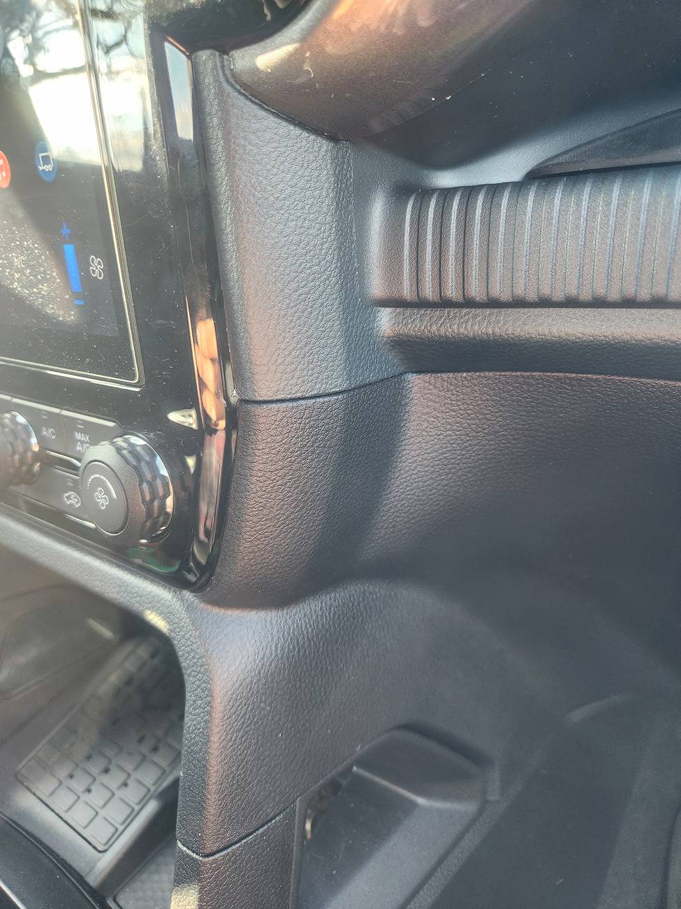

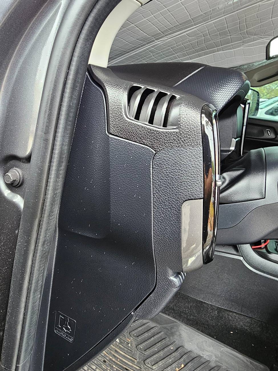

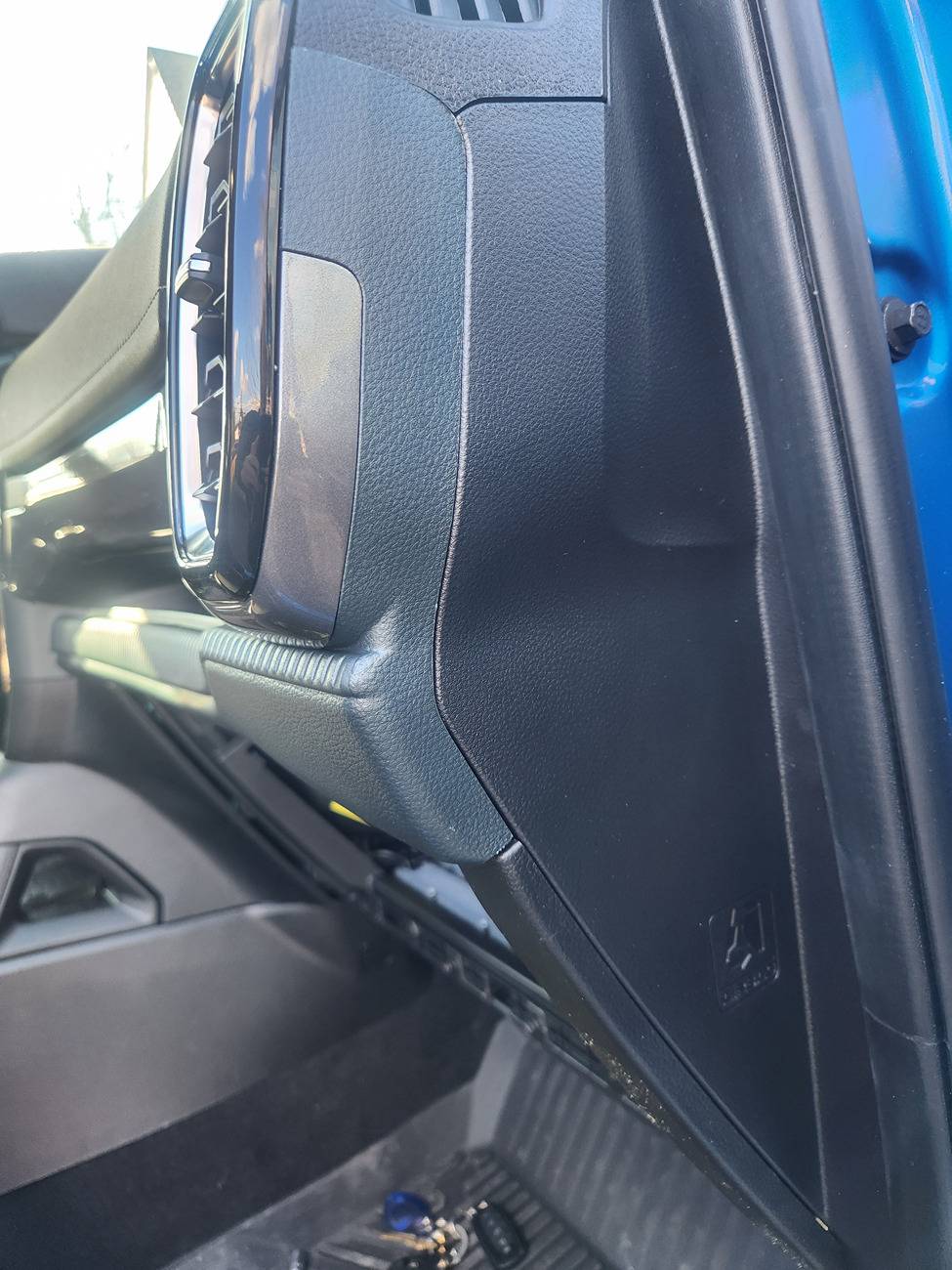

Unfortunately, this is just the result of different production lots or different manufacturers for different parts of the dash. There's only only one part number for the main dash assembly across all trims. This is a picture of my stock driver's side trim. Three different colors and textures which are not as obvious in this picture. My stock passenger XLT trim piece was a pretty good match but definitely different than the Lariat glove box. Luckily with tinted windows, it's not super obvious while in the truck.

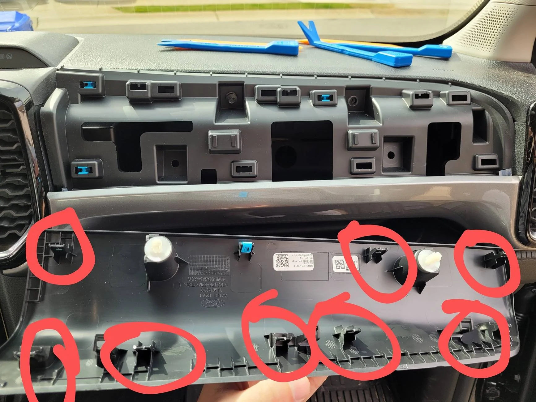

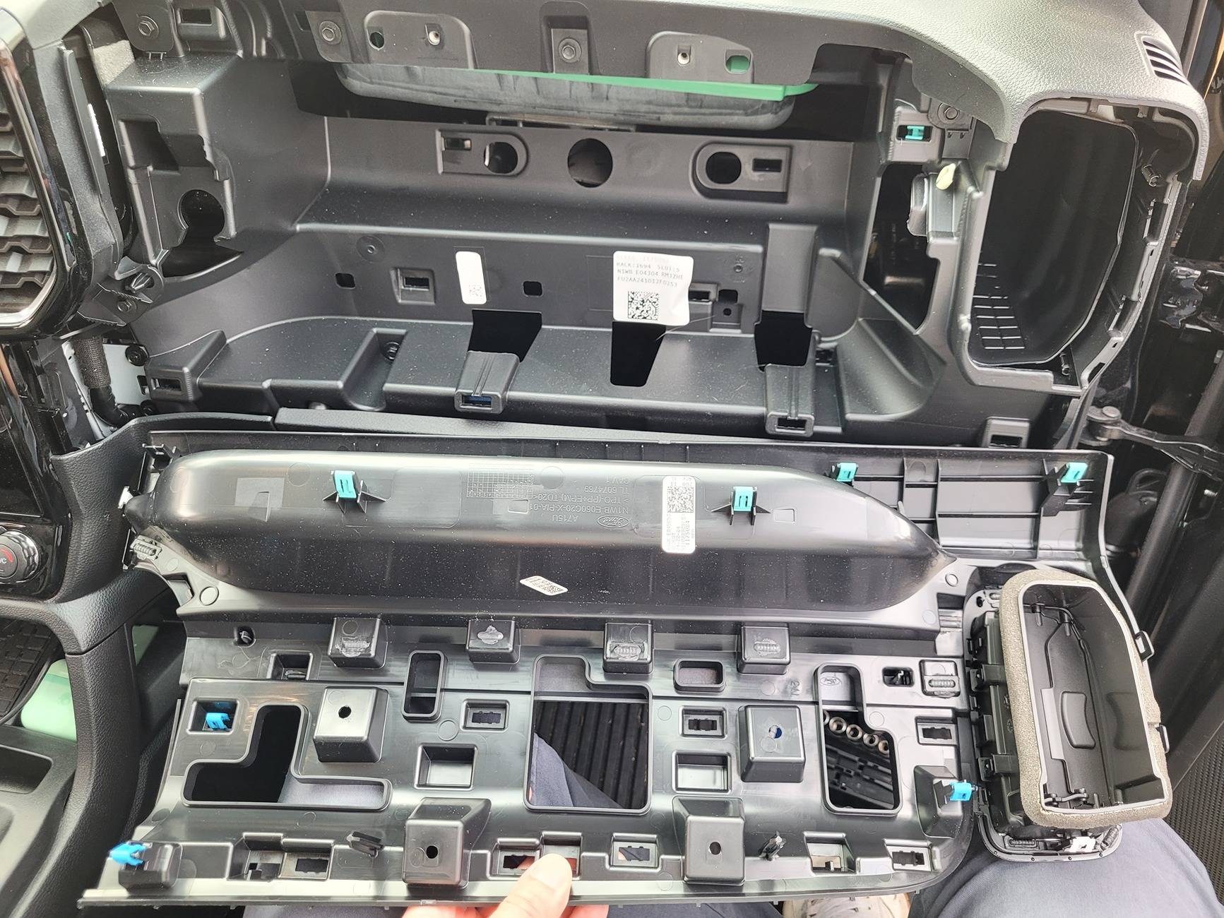

some input, I don't think there is any getting around breaking a bunch of the clips on the stock upper panel.
Ford Ranger Lariat Top Glove Box Install on XLT 20250309_154232~2

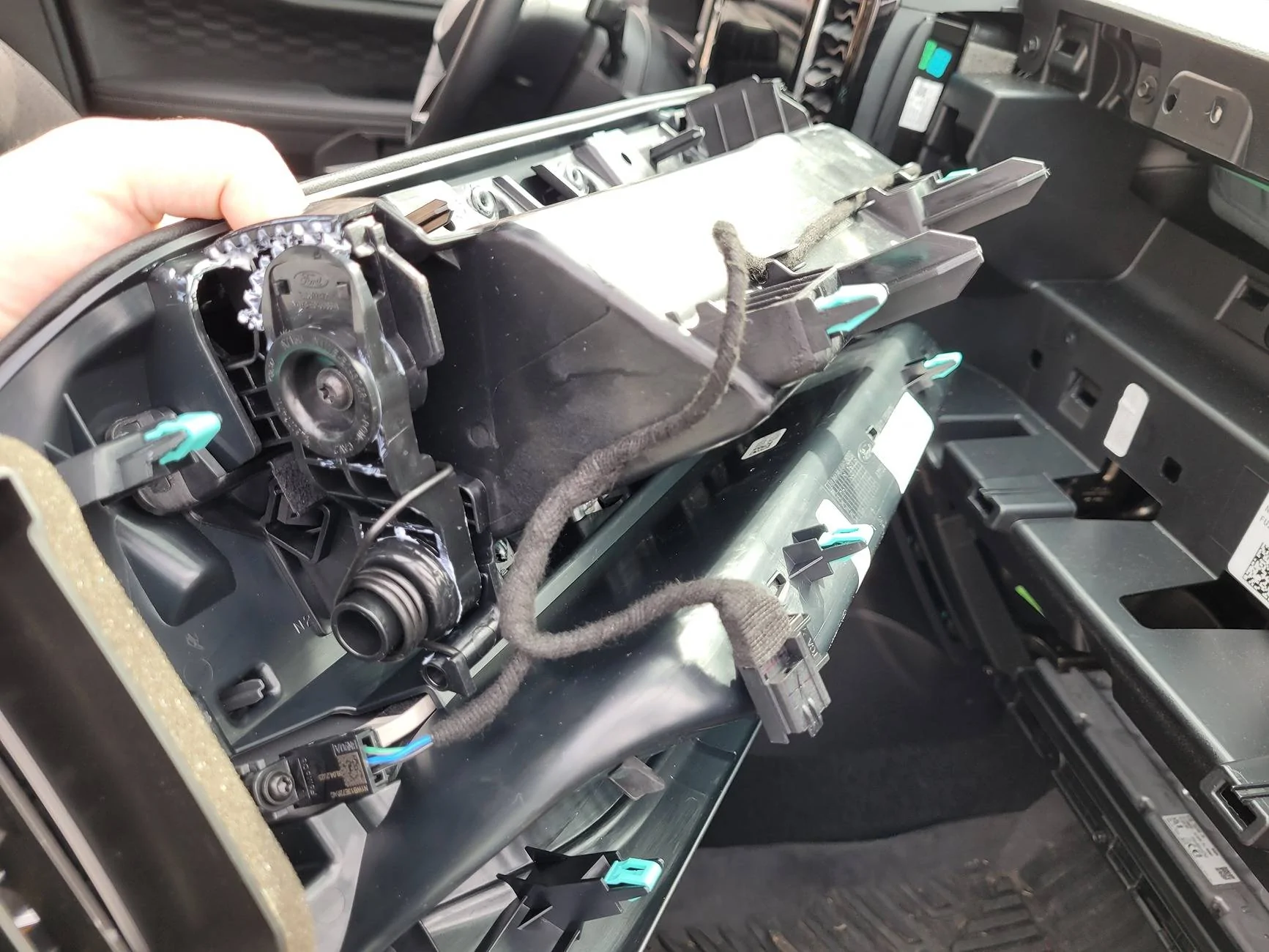

Only two bolts needed to be removed on mine to swap the assembly, here's a pic of the back side to give a bit more detail for locations of the clips and what not
Ford Ranger Lariat Top Glove Box Install on XLT 20250309_154550
