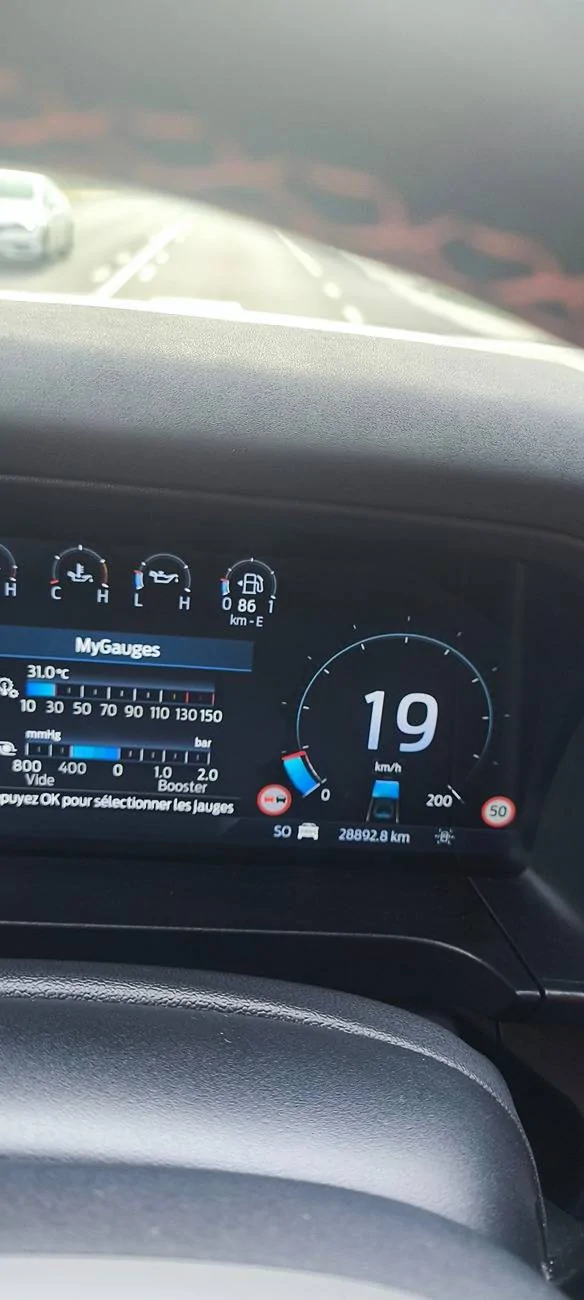

Same for me, I use the "MyGauges" view but often I find the default view "Trip 1"
